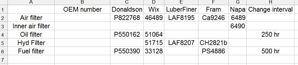

I have been cross-referencing Montana filter numbers and came up with this list for the 4344 hst. I believe it is fairly accurate; I know the napa air filter number is correct, and I have a fuel filter and hyd filter at home, so they came off this list somewhere...
