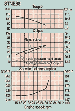

Yanmar 3TNE88 used in the 4400 & 4410- Spec's
105 nm= 77.4 ft lbs
{same pistons as used in the 4700}

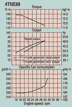

Yanmar 4TNE88 used in 4700/4710-Spec's
139 nm= 102.5 ft lbs.
