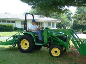

Got it today, looks great but several disappointments.
1) delivered bone dry on fuel
2) accessory lighting wires draped across the three point
3) forgot the manual
4) delivery person didn't know the machine, no intro
5) couldn't detach the FEL, the plate won't rotate with the lever after the retaining bracket is removed.
Nevertheless mowed 3.5 acres, pulled up a stump and did some light loader work. The machine is great, the dealer left a lot to be desired. Should I have received better? I think so. /forums/images/graemlins/confused.gif

There is an adjustment for that, which doesn't sound like it was done. The loaders are setup for diferant models, and may need to be fine tuned to each. I have the setup manual, but your dealer should fix it...

It's too bad more dealers don't realize how important this initial experience is, the tone it sets for the future, and your satisfaction as a customer. While I had some of the same experiences you did, my dealer, although very busy, took some time to walk through the tractor's operation and even removed and installed the loader at the dealer before trailering it. My front plate stuck as well and after adjusting the loader arms as Mike mentioned it's better...still a tight fit but I'll take that over rattles or loose. I also noticed I had a significant paint drip on the inside lip of the front plate that seemed to contribute to it catching instead of flipping all the way down.
I'm not sure if anyone mentioned it yet but the dealer demonstrated that placing some downward pressure with the loader bucket takes much of the pressure off of the front plate so it will engage and disengage much easier. If you use this method be very careful if you have pressure on the loader and you're anywhere near the front of the tractor to remove the retainer bracket or to check the plate engagement...don't get between the loader and tractor for any reason!
My rear work light wires were also draped over the top of the three point area so I'm going to route them through the obviously available conduit that the others are in, so even a good dealer isn't perfect...just a technician in a hurry.
