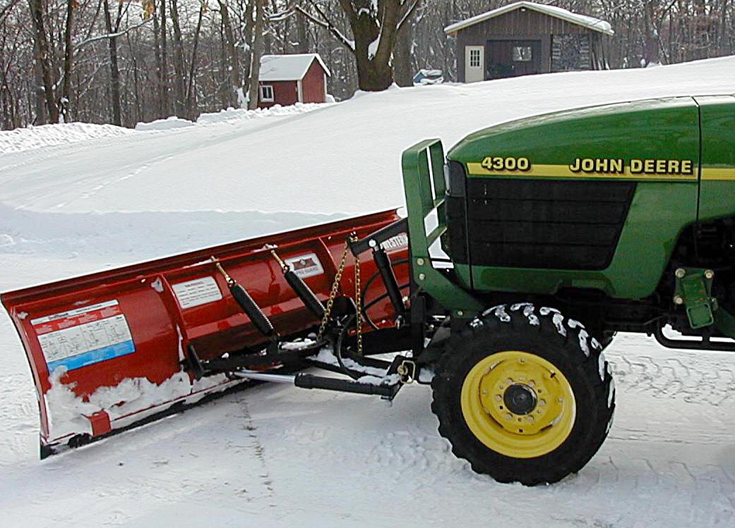

Alternatively, I added a 7' Western plow on the front, building a quick-attach hitch so the plow was close to the front of the tractor. Works very well, and fine with gravel drive if the stones can be firmly packed (realize some don't have that luxury and the gravel is continually loose and not packable ).
Pic of my plow setup on the 4300...
