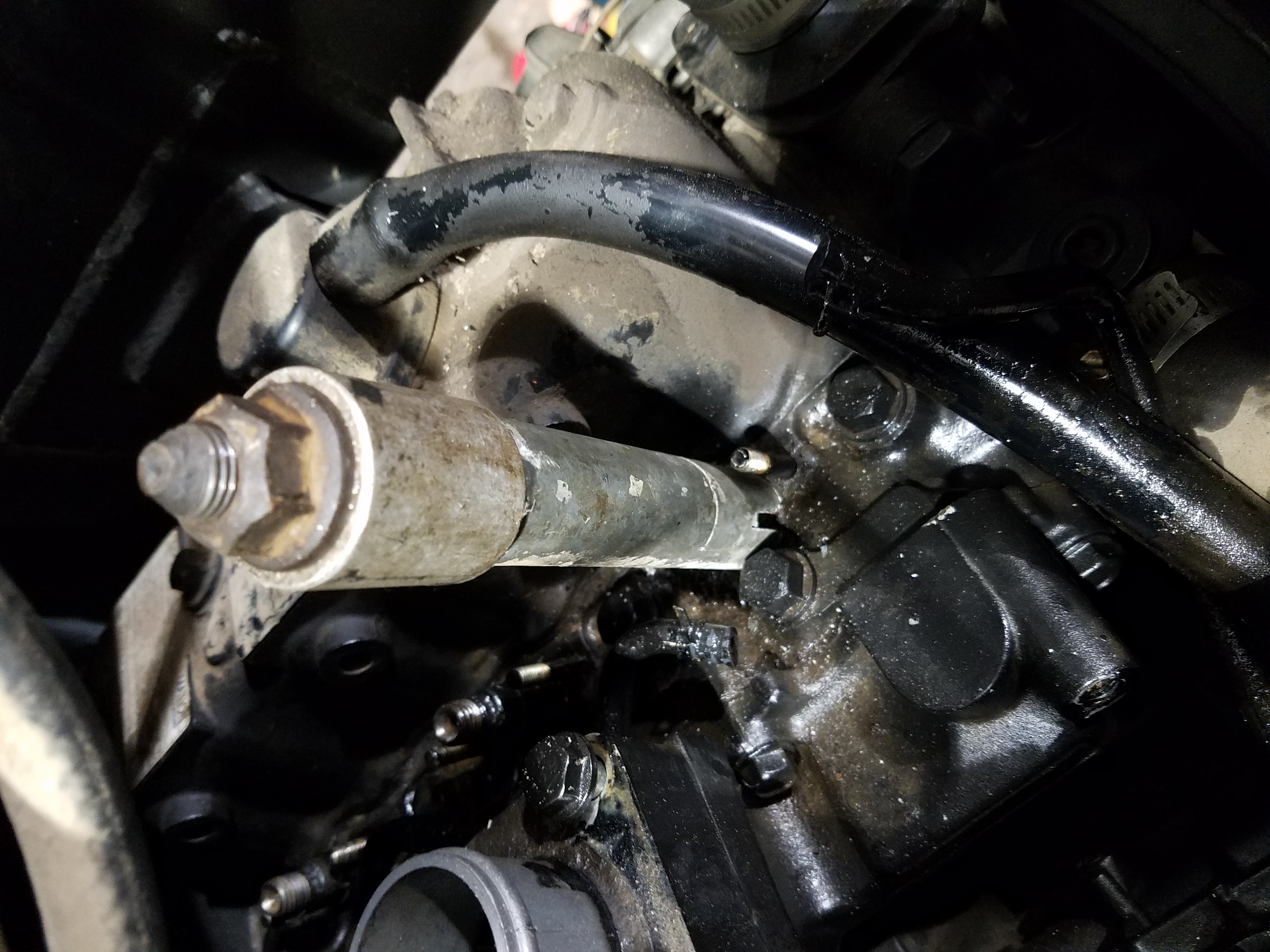

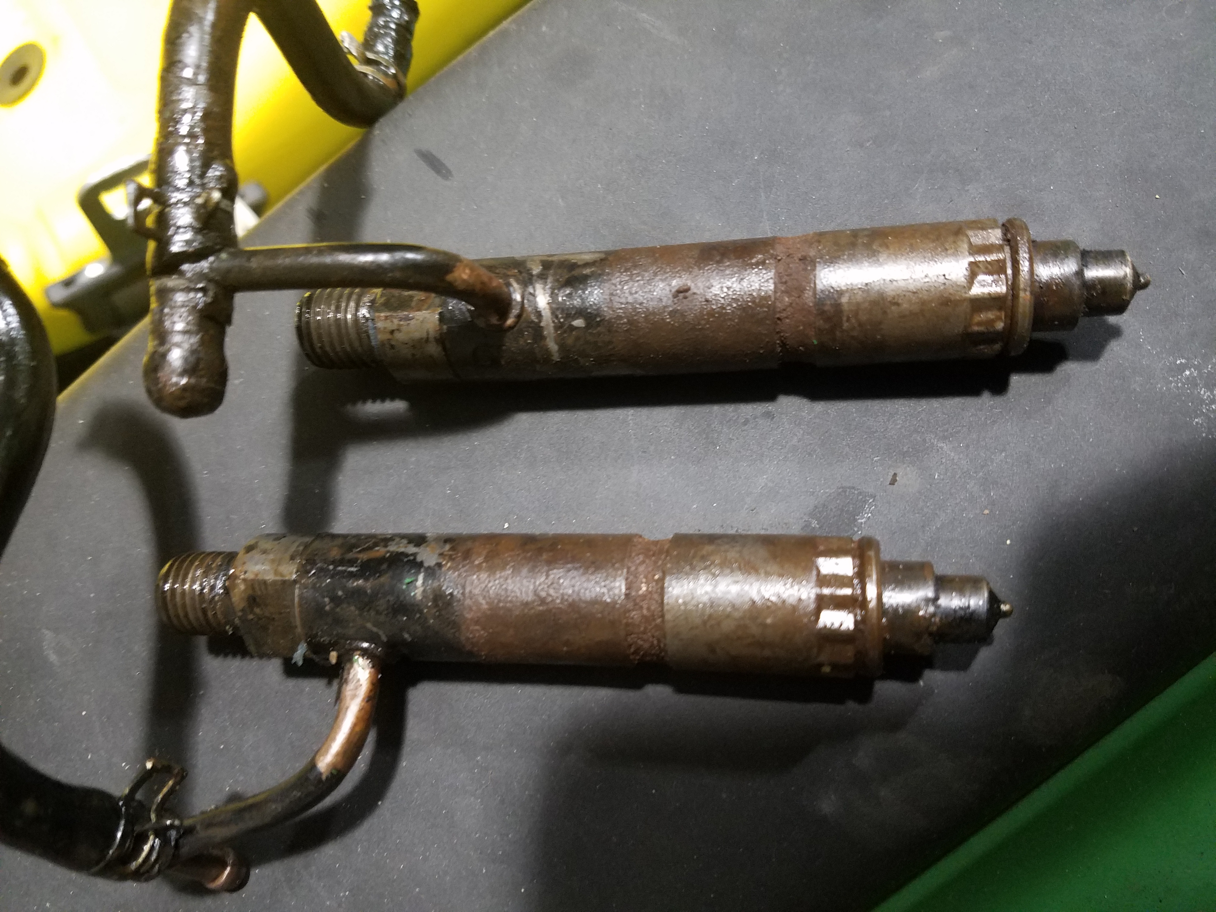

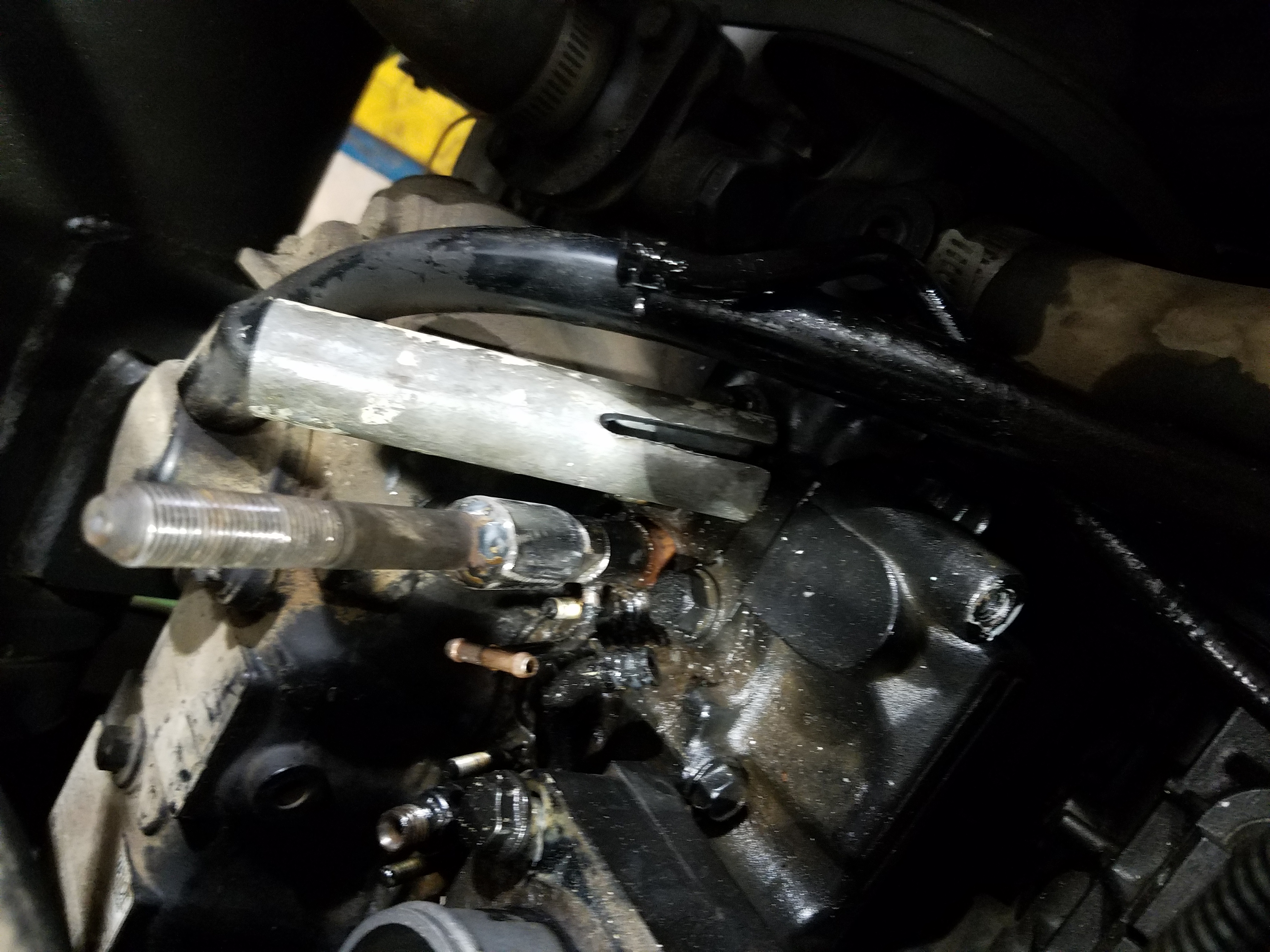

I made a working dummy injector using a couple old sockets and mig welded them together and shaped them with a grinder. I was going to turn a piece of solid aluminum bar, but the sockets were the right size and pretty quick fix. Compression test was good, added in a big rubber o-ring and didn't feel and leakage past the body. I was also able to insert a USB camera ($10 on ebay and super handy) in the head and do a general inspection....all looked good. I am now focusing on the injectors and injector pump. Going to buy a pop tester or take them to a shop. I may just end up sending the IP and injectors out to get them tested together. Anyone have any recommendations for service?

I won't post an ebay link, because it wont be good in a few months....just search for "micro usb" or "endoscope" camera. They are around $10. Priceless for inspecting piston tops, rings and cylinder walls through spark plug holes.
Adjustable LED light. plugs into your smart phone and used a free app. YOU NEED ONE! They make different camera diameters...I think mine is 5.5mm and it just barely fits in the injector nozzle tube; so I would recommend spending the extra few bucks to stay in a smaller diameter range (5mm to 5.5mm, not the 7 or 8mm). For how cheap they are you could snag a small one and larger one.
