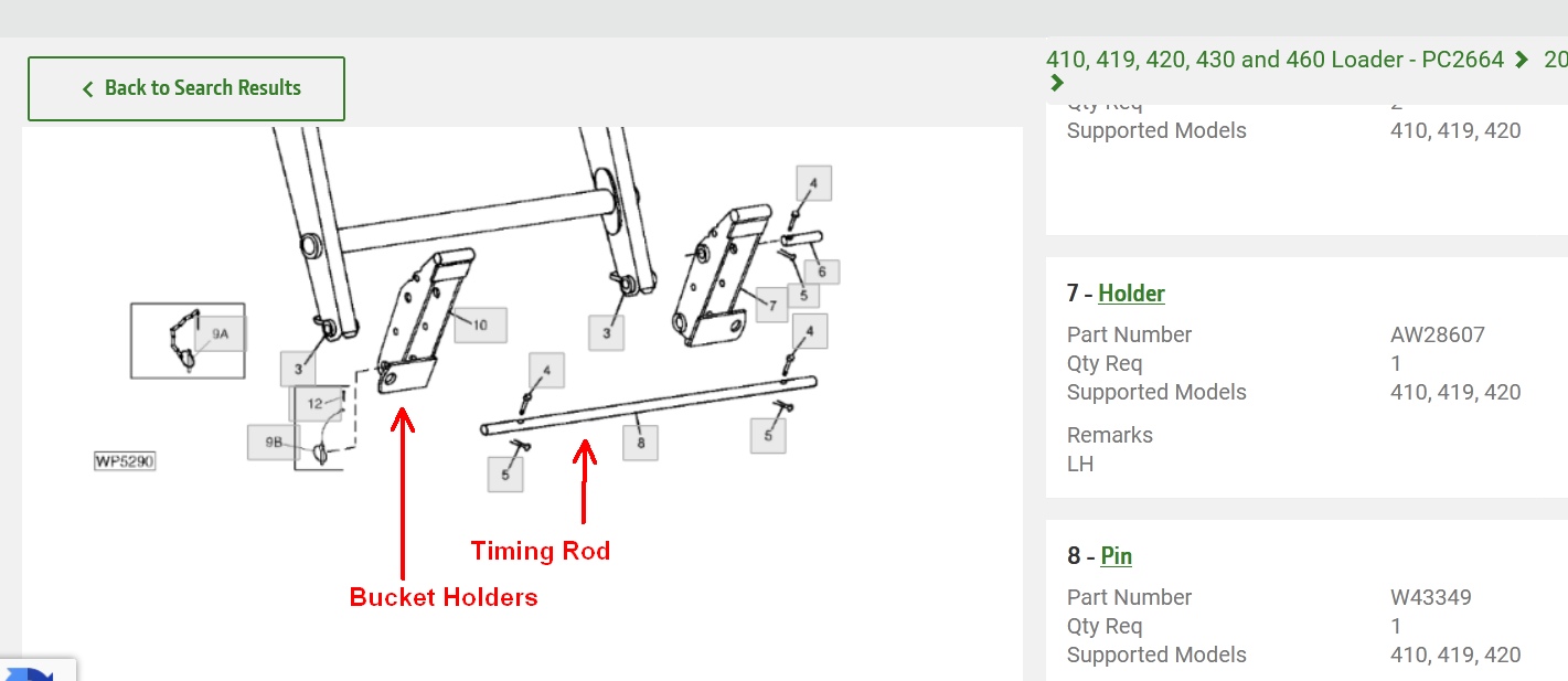

The uneven travel with the bucket off is sheared or worn pins and holes on the timing rod.
As already suggested park the tractor on level ground with the tire pressure set even to measure for a bent frame.
What is the timing rod?

/ 420 Loader - not level - leaking cylinders? #12
This illustration just calls it a pin but for some of the other model loader parts they refer to it as a timing rod which is what it actually does. It passes through the bucket holders to time them together. The pins and holes they pass through will wear and often the pins get broken and fall out.
Even with everything equal cylinders will move independently depending on which one gets the fluid first and which has the least resistance. If you connect a dual lid grapple to a loader the lids will never move in unison and both will stop when they get to their compressed point.
When I rebuilt my loader I welded some 1" stop collars to the outside of the holders to center them on the rod better. I bought a piece of 1" cold roll and drilled it to make my own timing rod. JD wants over $200 for the rod. I think I paid $25 for a 4' piece of cold roll. I needed to make my rod longer anyways to pass through the added stop collars. I also drilled the locating pin holes out to 5/16" and put grade 8 bolts in them.

I see now, that makes sense. My pins are still there, I'm guessing the holes have worn out significantly, but I understand now. Thank you!
