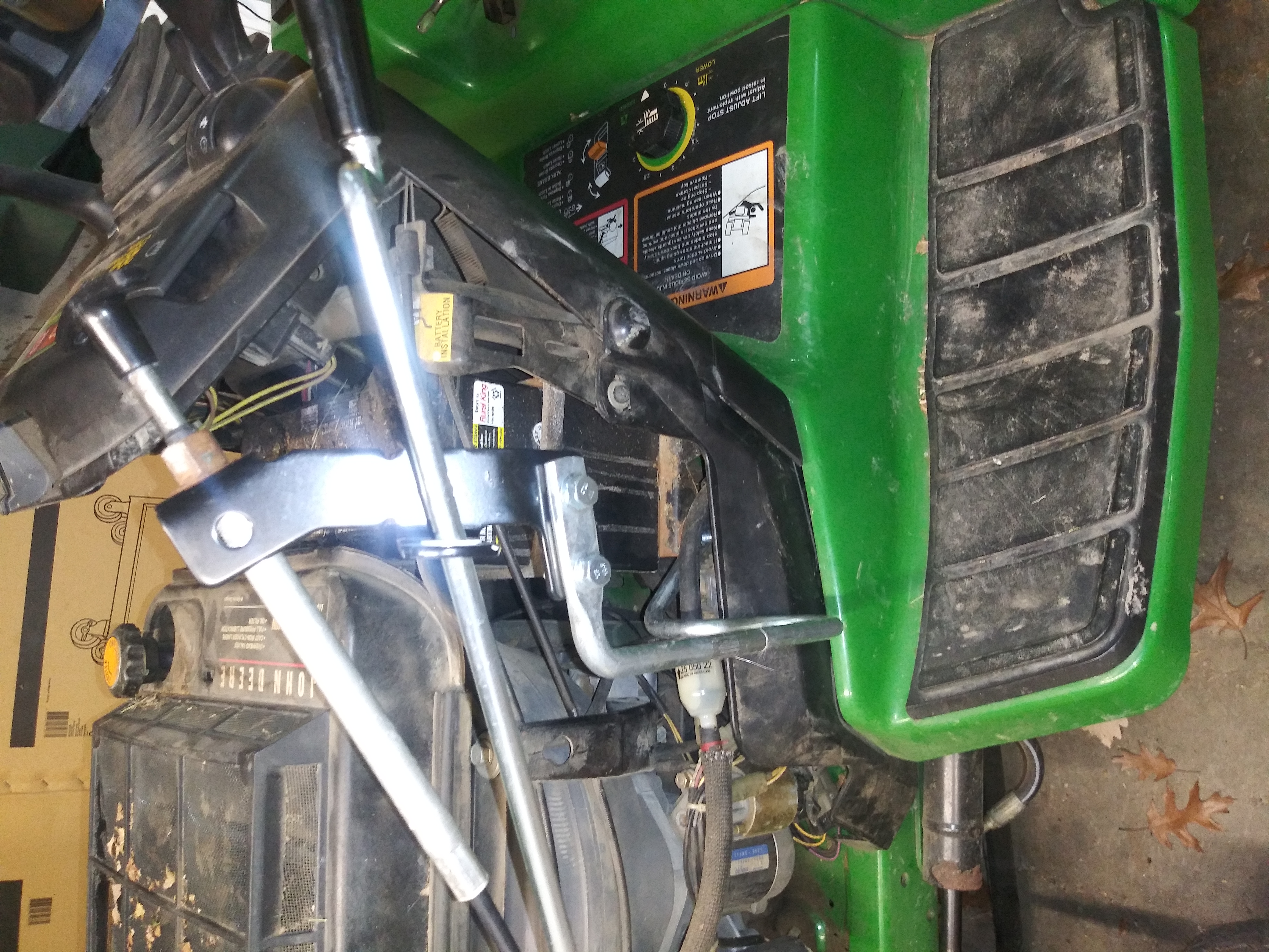

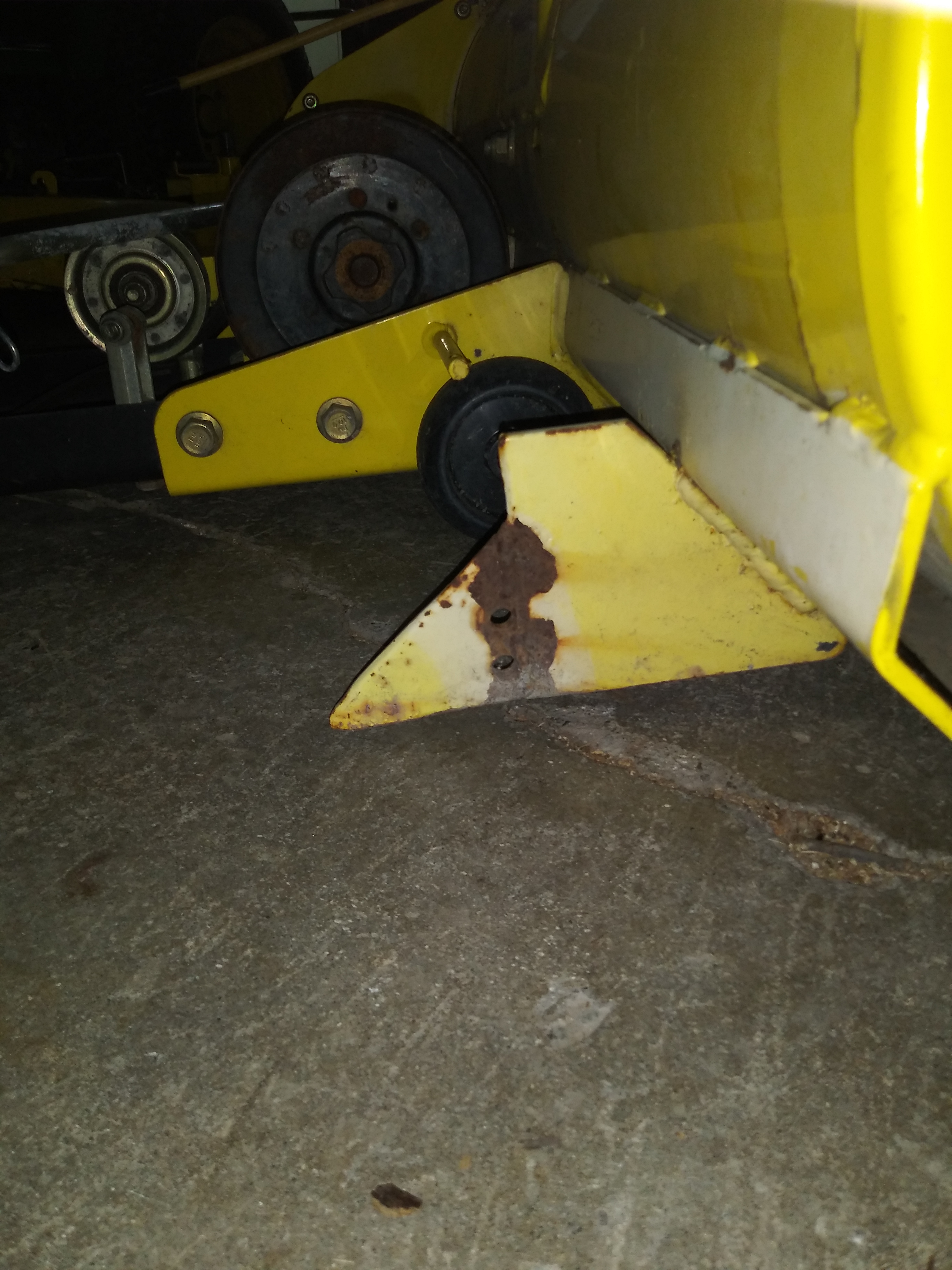

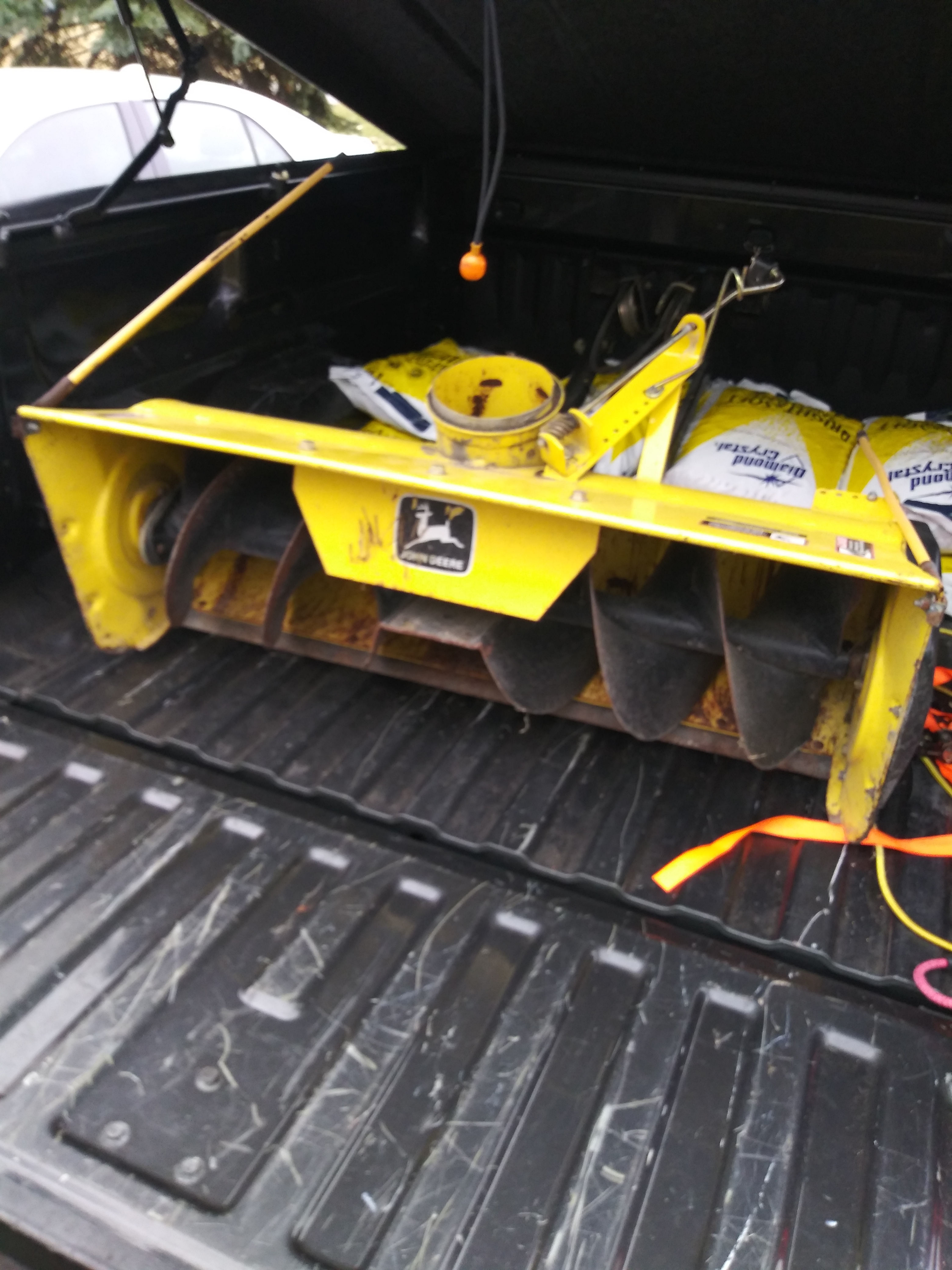

I just picked up a 42" Snowthrower ($300) I want to put on my GX345. Im missing a list of parts, mostly relating to the vane direction. I have from the base unit thru the plastic yoke. I intend to fab up my own brackets and crank rod to direct the vane as the parts prices are nuts ($190). I recall reading that another fellow did this as well. If you are out there reading this please share a few pics with me.

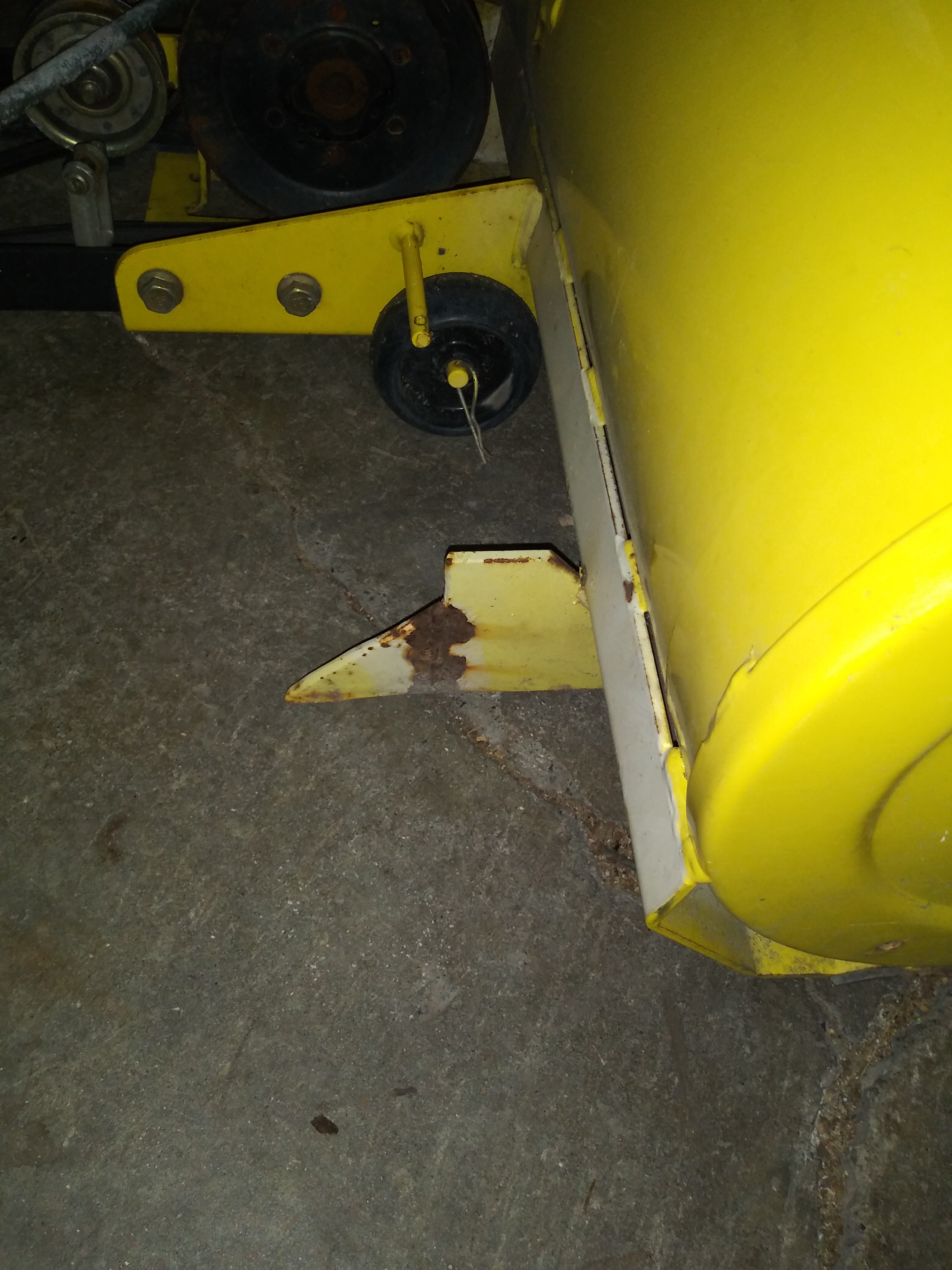

I do have a question- on the back of the snow thrower housing there are these triangular tabs. The weld on them looks like buble gum. I dont believe this was from the factory. I havent been able to find any good pictures to confirm or deny this theroy so I am asking here. Picture attached.
If its not stock Im going to cut it off and paint the wound.
This was supposedly on a 225 previously. It appears I need to also move the lift yokes.

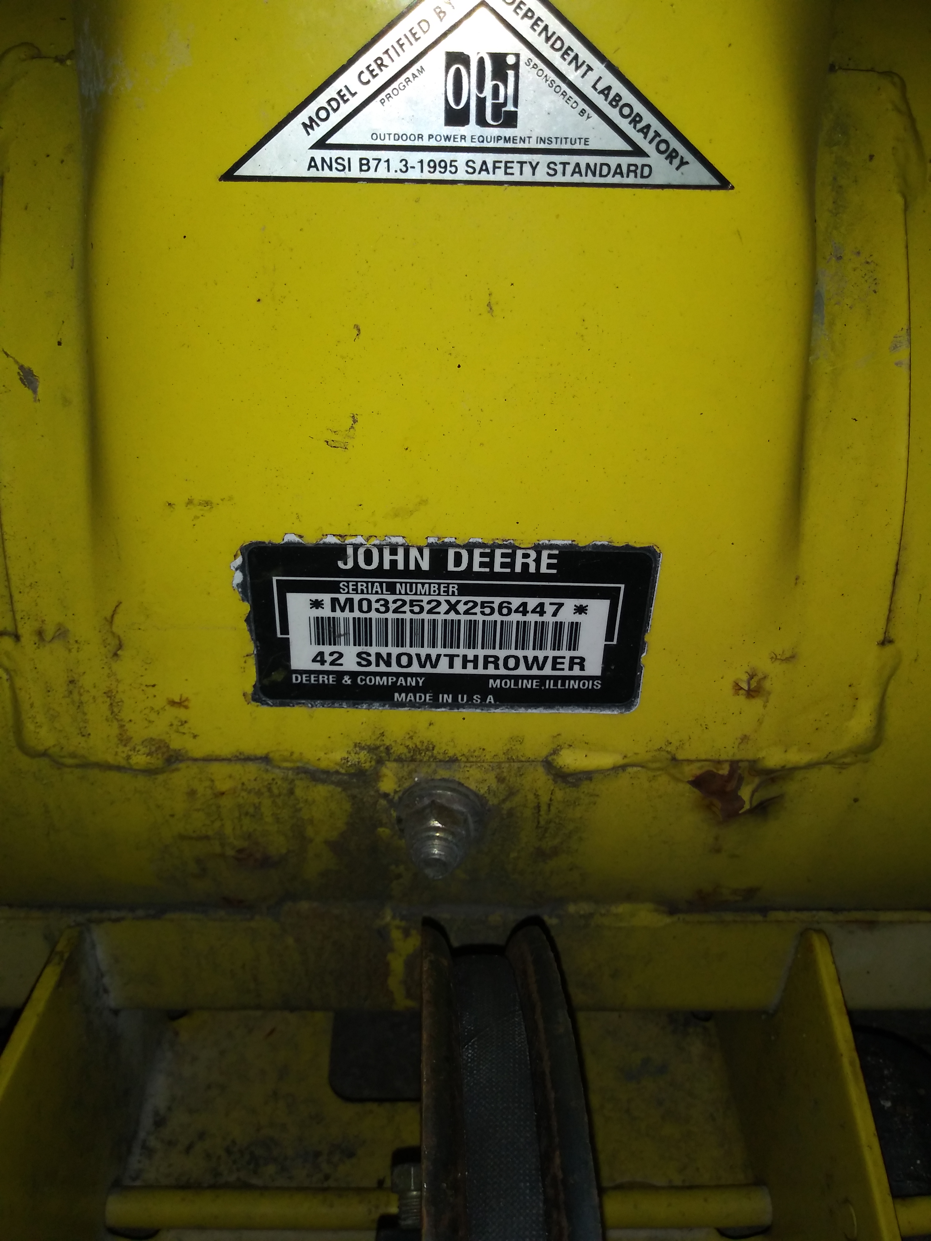

Here is a better photo.
Note the stabilizer bar from tractor to the left back side of the thrower.

Those weldments are for a second set of wheels so the corners cannot dig in and cause mischief and to avoid letting that beautiful snow blower eat.
Purchase another set of wheels for it and you will be well prepared for snow. you will not be wasting money as they knew what they were doing building that snow blower(that beautiful snow blower was not made by RAD obviously since it has the OPEI tag and the John Deere serial number tag and scanning tag.

Well the brackets are now off. I couldnt find a picture of these on any others. Plus the welds looked like bubble gum sitting on top. No penatration at all. They look like someone added them.

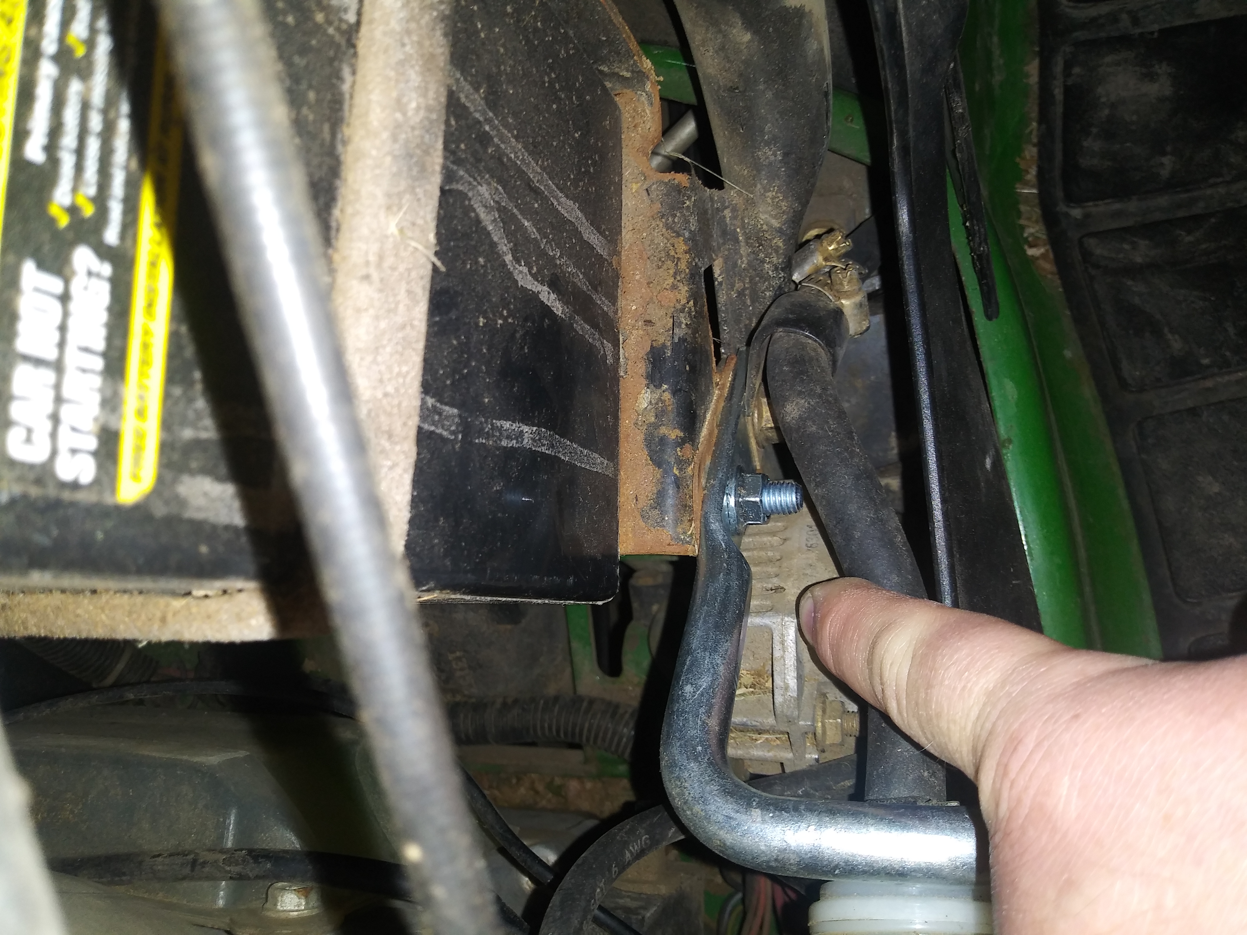

Now Im trying to figure out the brackets. I paid $54 for a bent up rod that Im not sure where it goes or what it does :(

It took me a little longer in the garage, but the bent up rod went to just under the battery box. I had to remove a black plastic shroud piece to gain access and get it to "fit" back in.

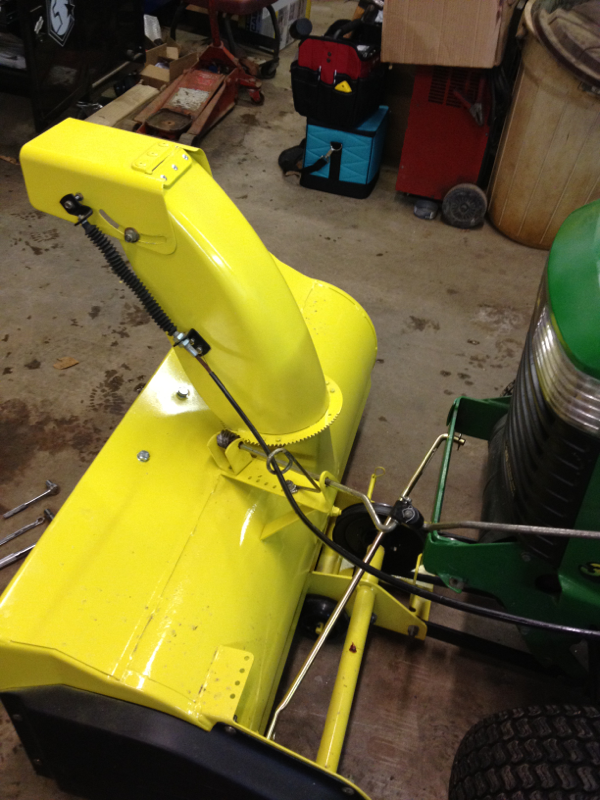

Well some time has passed since my last post. I have been busy though- I scrapped, wire wheeled, welded up the inside of the housing then painted it. I also scrapped, sanded and painted the auger. I had to "fix" a few ding in it and straighten the blades out a bit.
I got the rotating assembly together yesterday. Somethign worthy to note for people in the future that may find this thread, the drive dog fits loose to the shaft. The drive dog has "pads" cast into the hole that the sahft passes thru. The shaft is 1018 CRS 1" diameter, so it comes in the door .002-.003" smaller than 1". What happens is the drive dog will wear into the shaft a little bit, pushing material making it not round. So the entire shaft can not pass thru the bearings without a fair amount of sanding. I opted not to sand, so I just assembled it differently. Note I ended up using the stock "Fafnir" shaft collars with set screws as there is a counterbore to fit the bearings sleeve into (more on that next). To assemble I put the saft into the auger, key onto drive dog end, slide drive dog in. Loosely assembled drive dog side bearing (not the belt side). Slid it all in then I did the belt side bearing. This is where it got tricky as it kept binding up. After multiple attempts (and many colorful words) of tring to rotate the eccentric bearings I discovered the real issue. The bearings sleeve wasnt sliding into the shaft collar fully. So to fix this I put the first bearing plate on, assembled sleeve to bearing, inserted onto shaft and followed up with the extiror bearing plate. Everything worked out well then. Spun freely without much drag. I did notive the auger is a bit loose to the shaft so it moved and makes some noise.
My thrower didnt have the wear plate M142891 instsalled ever. I did not like the $43.75 price tag. Instead I used conveyor belting, McMaster Carr #6001K4 10" Wide and 1 FT lg. I cut down the length as required and used Marine Shoe Goop 1 full large tub to stick it down. Followed up with the two 1/4" carriage bolts on the wear strip and the one large carriage bolt in the upper rear center. FOr the flapper portion I used 4" wide 4 plat flat belting, McMaster Carr #5753K433. I fit to the high spot the best I could, marked holed and drilled. I used (4) 3/8"X1" LG bolts with a flat washer on both side and distorted thread locking nuts (not the nylon junk ones) so they will not fling off. Then I freely rotated it and used my dremel with sanding drum to make it as close to perfect as possible.
Then came the install onto my JD GX345. The previous owner had it on a manual lift, so the setup was way off for me. I had to used (3) washer per side on my mounting lugs on the tractor to get more room for this unit to latch on. The next issue is the holes where the U hangers attach to provie the lift are not on center with my lift arms. Its close enough it can work but the bolts are on a slight angle which I dont like. Next I had to goto 1 3" LG bolt to get any threads in, and that is even to short.

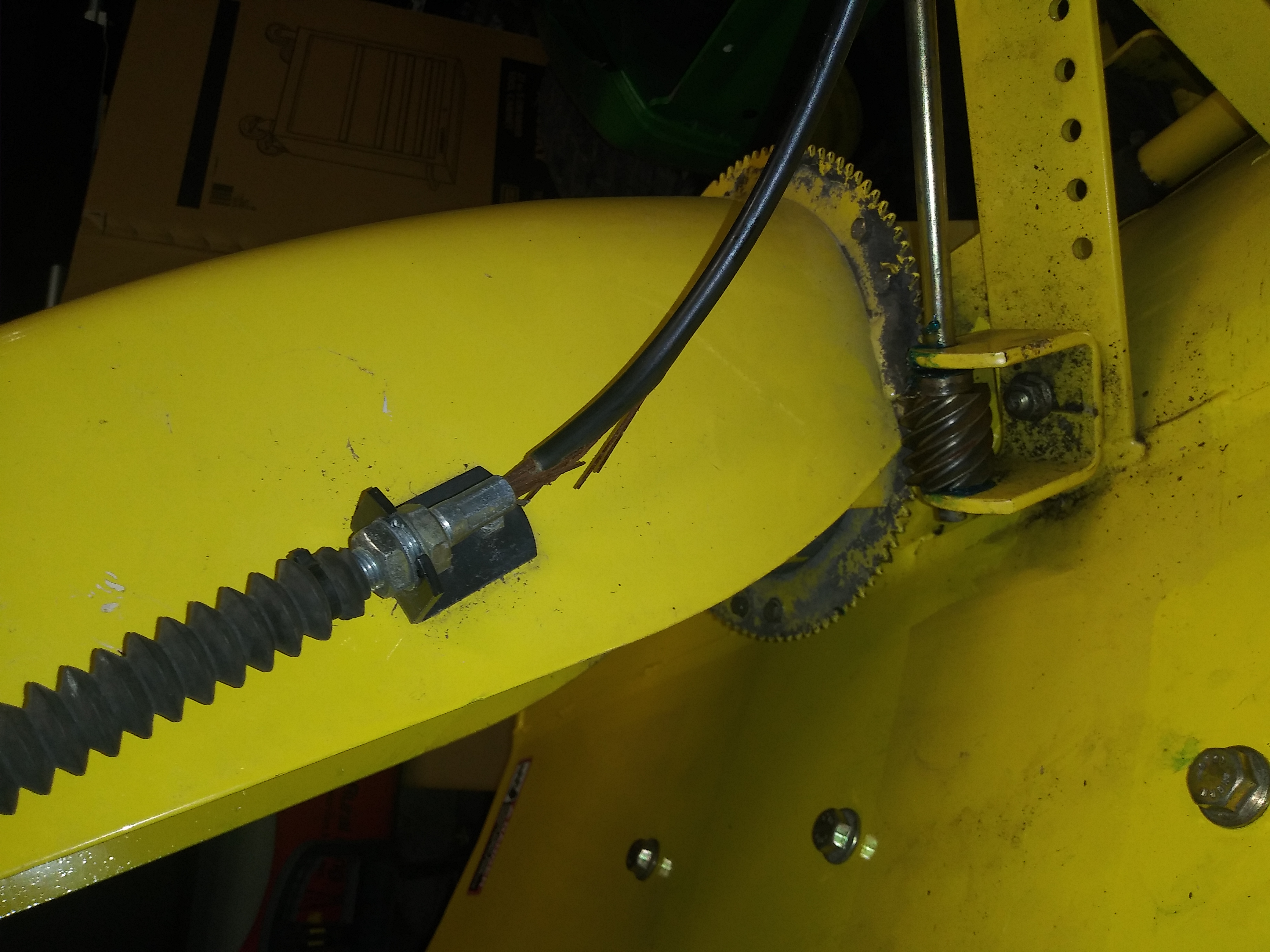

Functionally it works! I have to replace the chute hinge and get the rod to tie back to the tractor, but otherwise it works.

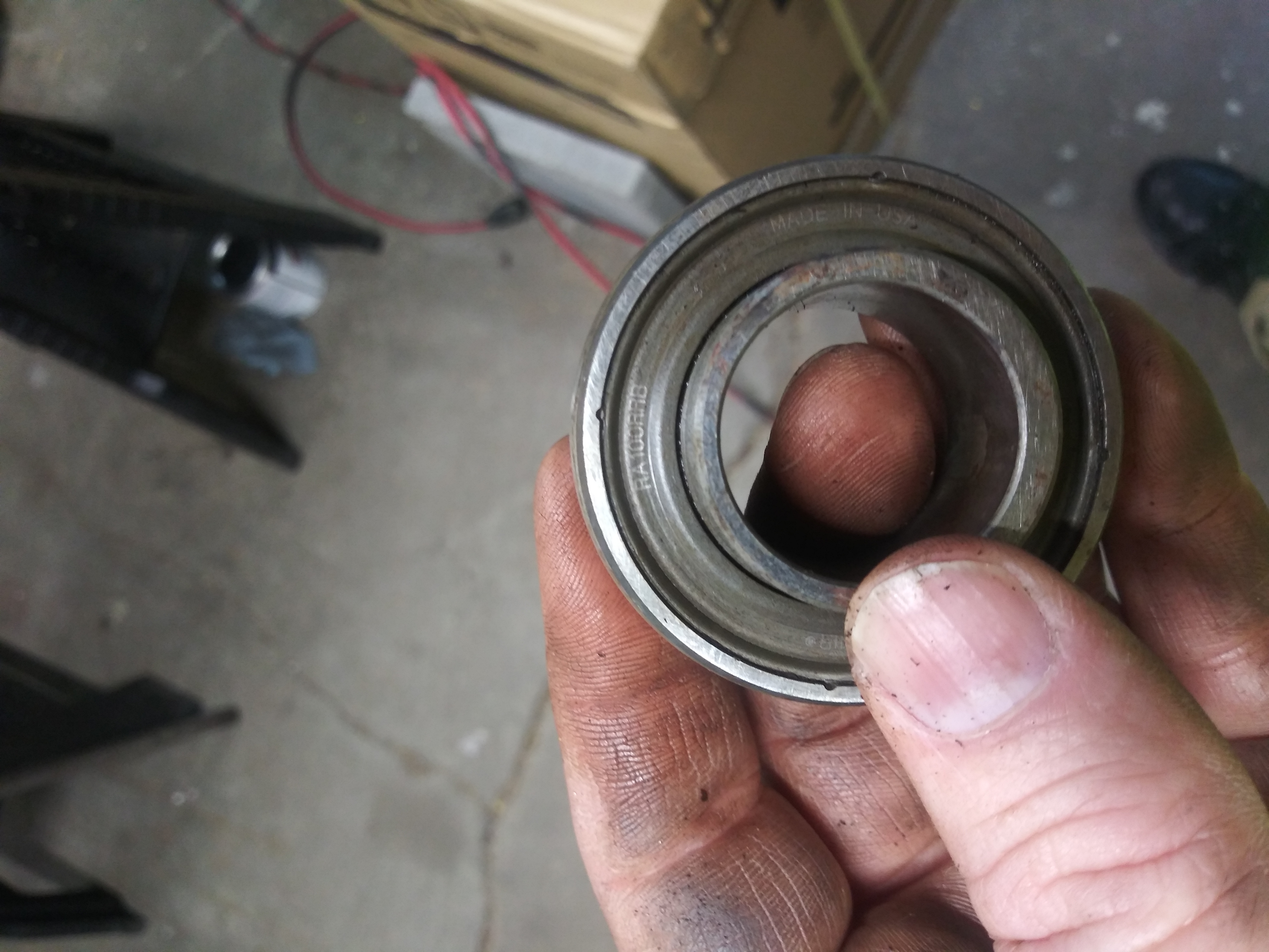

Attached are some pictures someone in the future may find helpful. The BRG# is clearly shown on the one picture so you can source it anywhere.

Pic one shows the Eccentric locking collar.. need to understand how they work, and why they are used where they are. I get the feeling from your frustration that you don't understand them. But I could be wrong.
