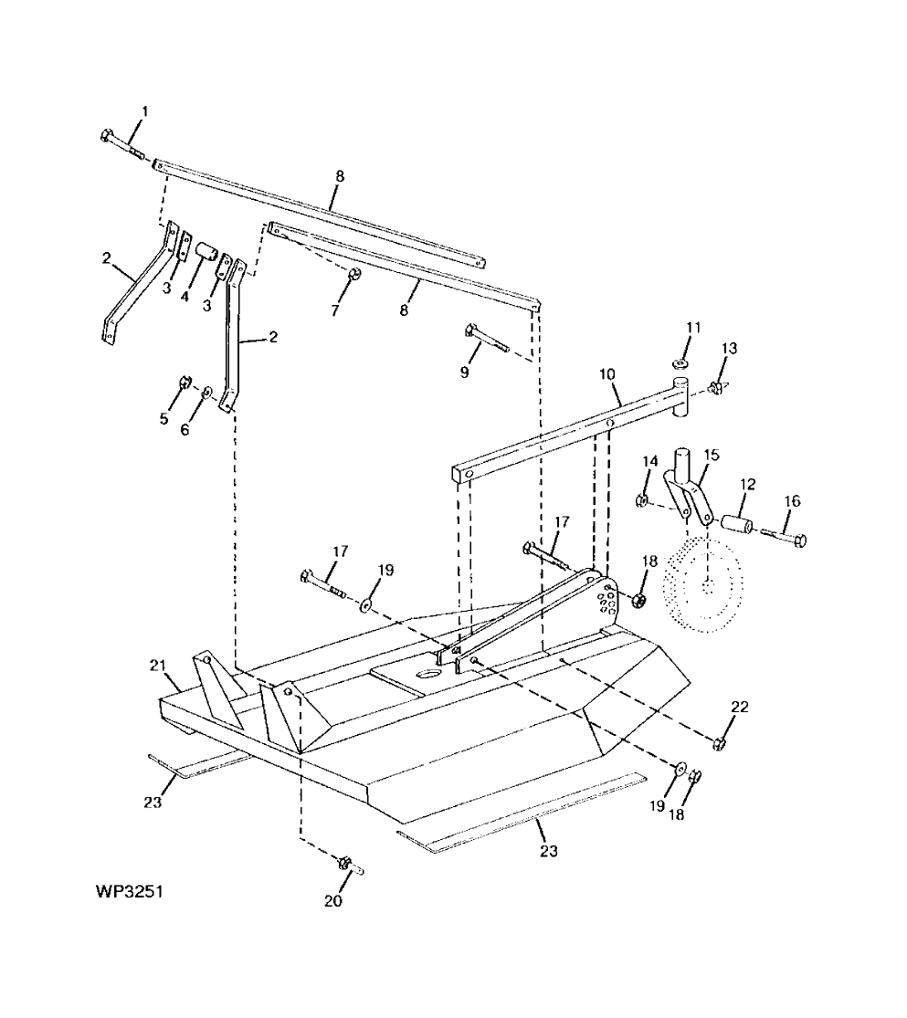

En,
Got it. Three is the floppy link I was talking about. It costs an extra bolt, but put bolt 1 through 8 and 3 only. Then another bolt through 2, 3, and 4 only. Moving link #3 (plates really) between 2 and 8 still give you some flex for mowing rough terrain and the front stays rigid so you can easily hook up with a quick hitch. Without a quick hitch, you probably still want link 3 up front for your top link.
Life is easier with a quick hitch.
Correction: Life is easier - a year later once you've modified all your equipment - with a quick hitch.
Joe
