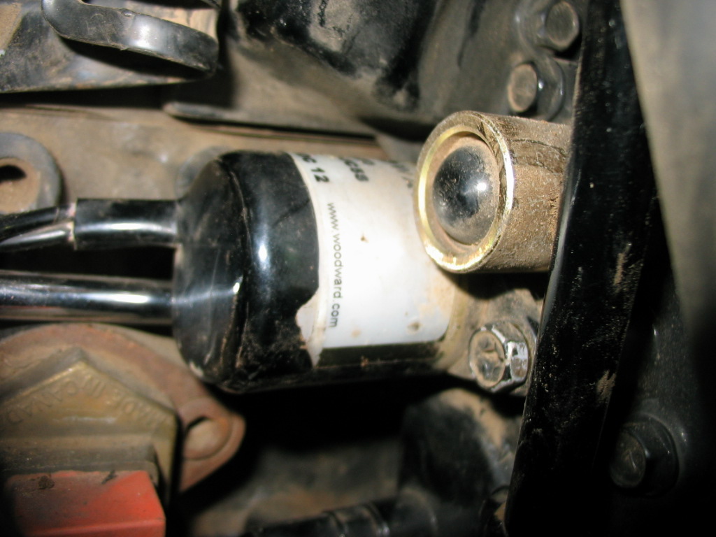

And to further screw up the day, discovered when a block heater is installed, there is no access to the one of the bolts attaching the solenoid to the fuel block assembly. Will have to pull the block heater (and coolant) to simply change out solenoid. Picture attached.

So, do yourself a favor and don't let your battery discharge to zero. From the other posts reviewed doing so looks like a good way to start spurious electrical issues
