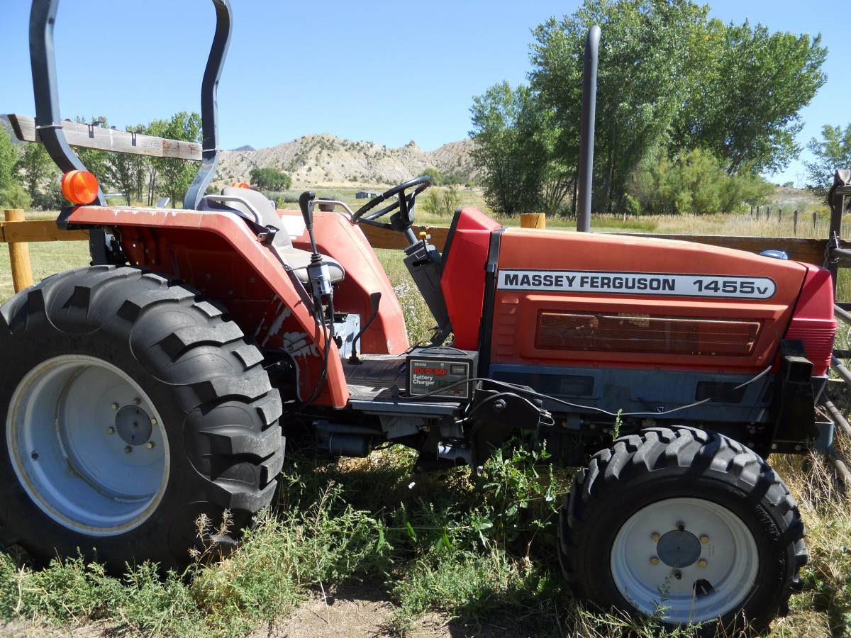

Guess I should offer this update... I ended up finding a 2003 MF 1455v on craigslist.
It's about the size and weight of the 4020R and LS XR4140 that I had been considering. (10" longer wheelbase...) I paid cash, and it was about half what the LS would have cost. Upside, Dave Ramsey would be proud of me. Downside, no new tractor with backhoe...
I do like the MF, though it's not as nice as either of the two tractors. But it will get the job done, and with less than 500 hours, should last me a lifetime. With 55hp, it's far more powerful than I'll ever need, but it's also simple, and has a great reliability record. While it doesn't quite lift as much as the Branson, it'll lift to 110", which is probably more useful than a few extra hundred pounds of capacity.
I still want a backhoe, but I can't really swing a cash deal for a $7000 hoe after paying cash for the tractor.
I'll keep looking for a used one... Hopefully something workable turns up soon. :)
