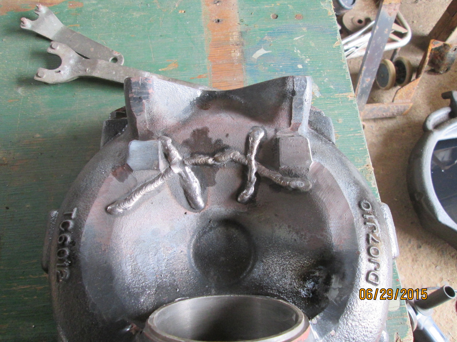

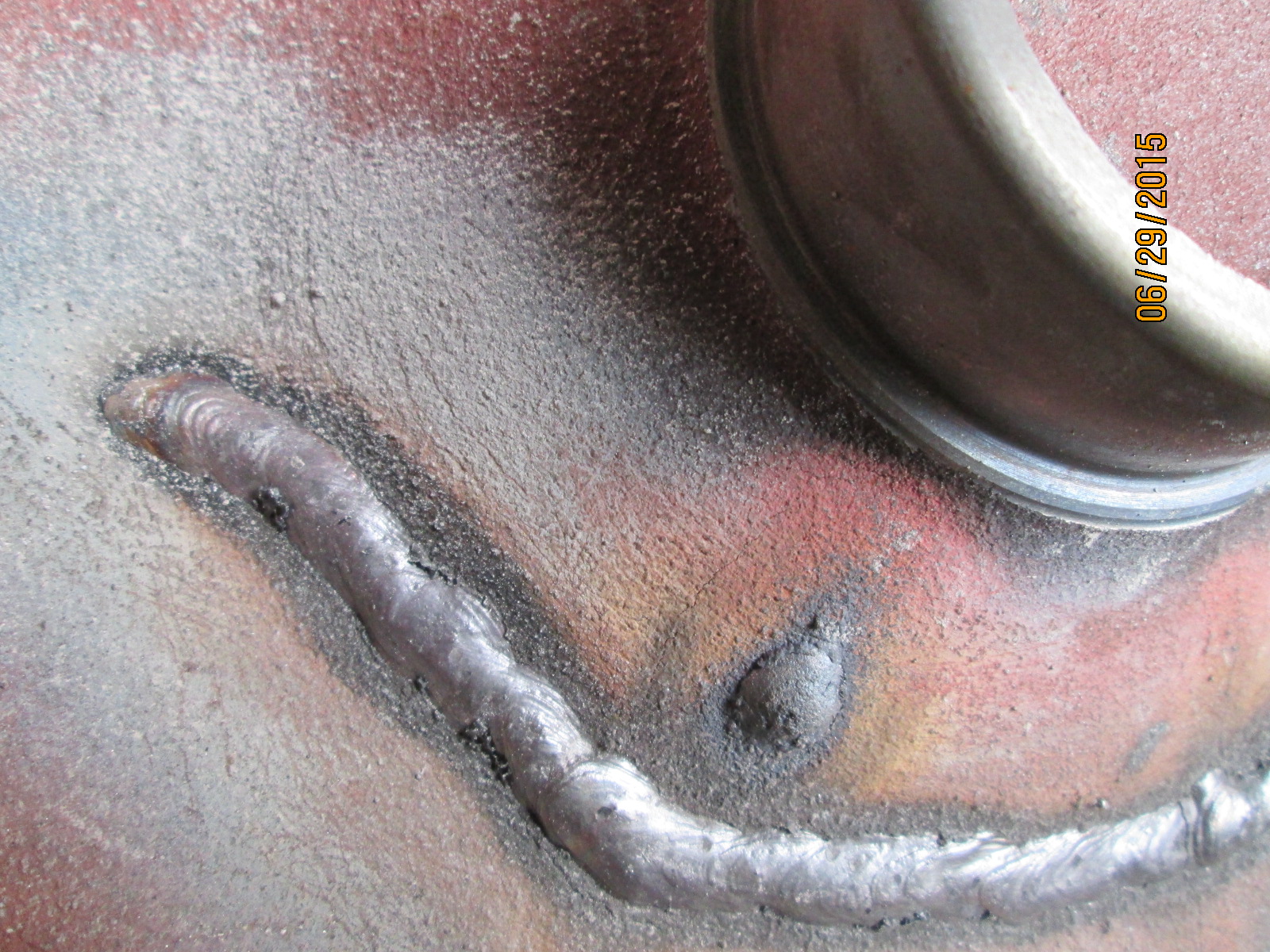

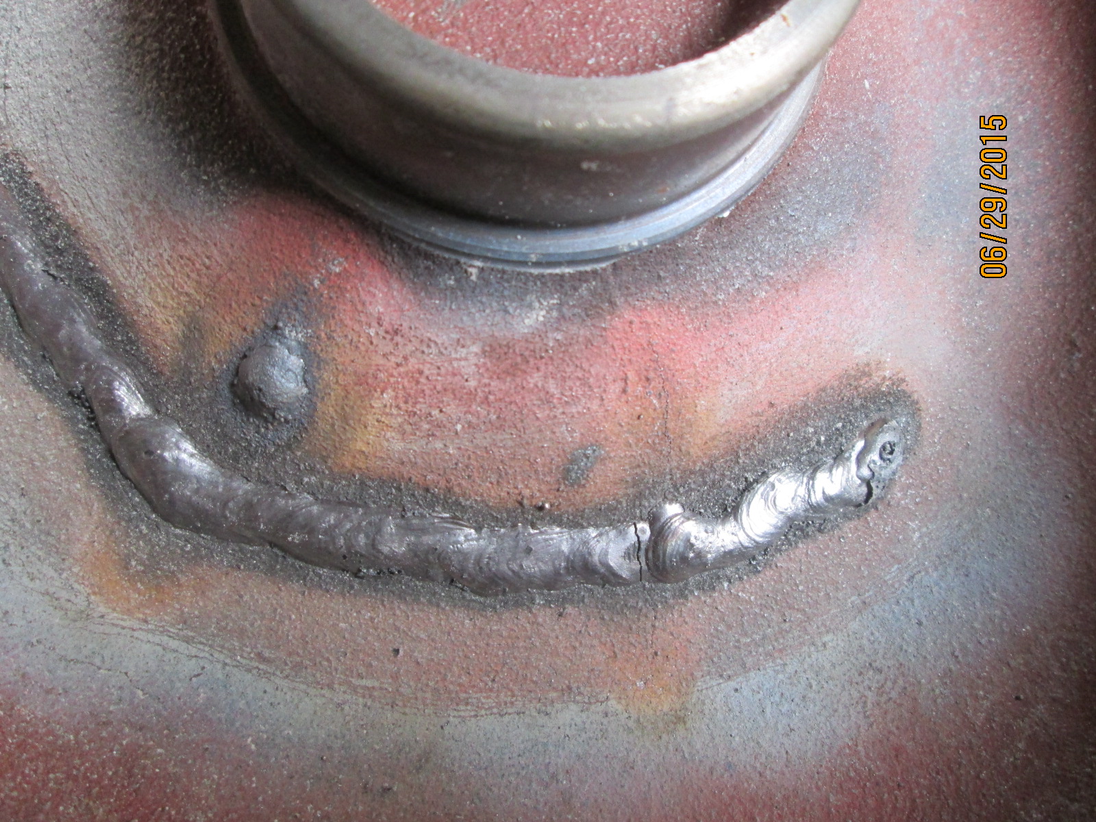

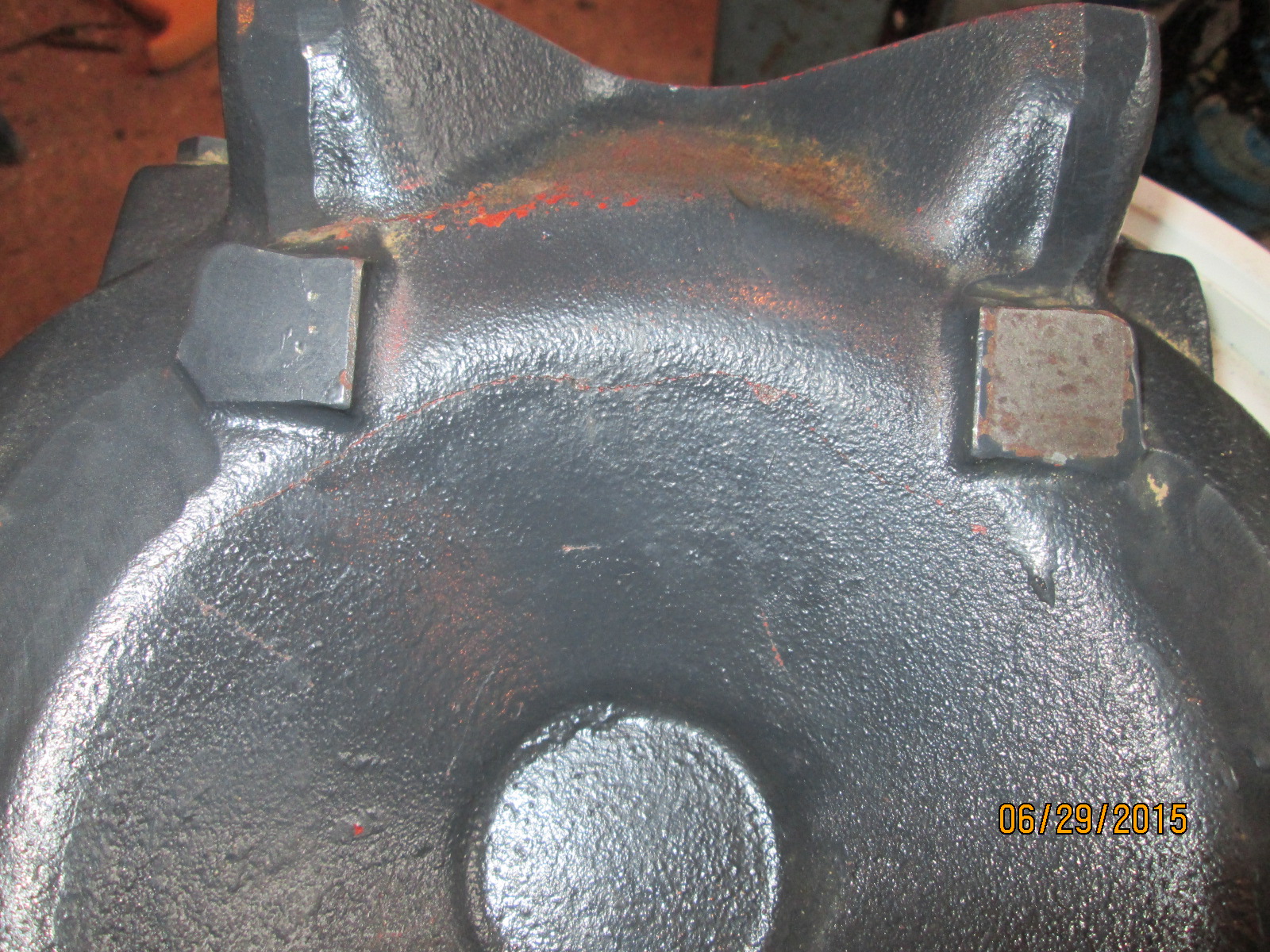

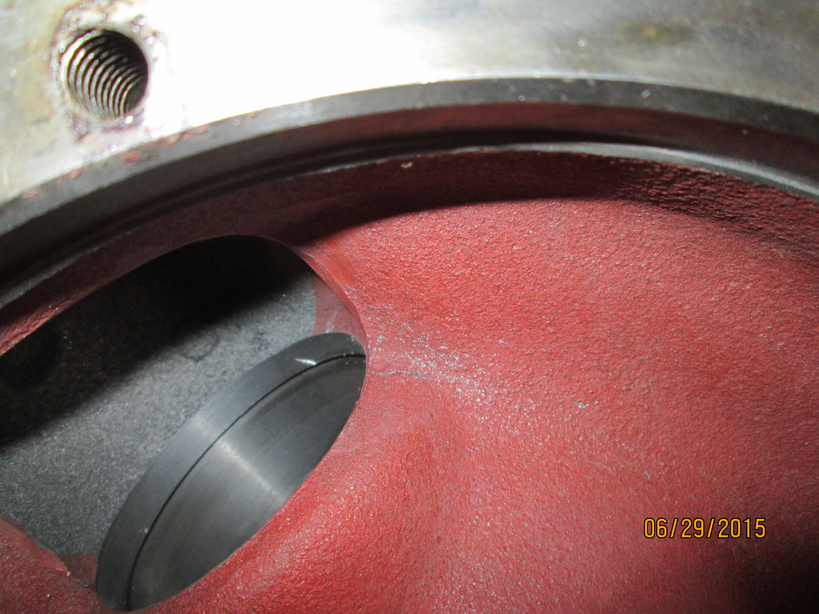

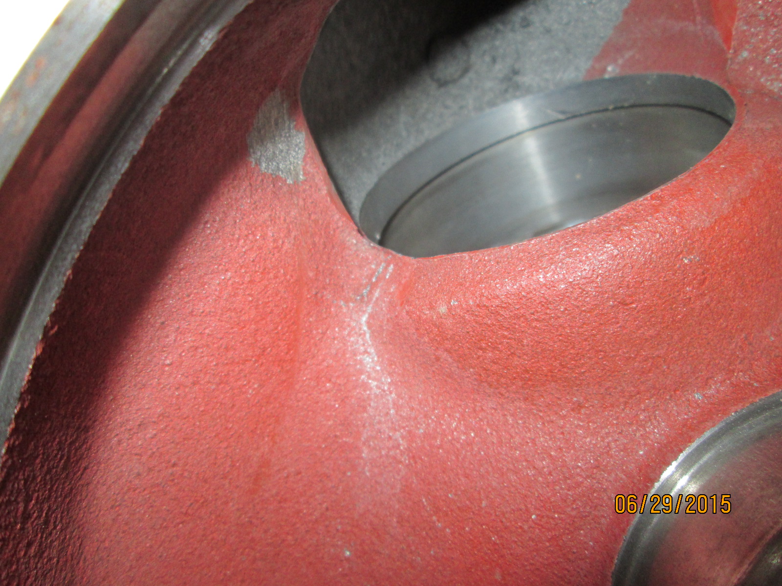

I had the same issue or so I thought.
A $75 seal and it still leaked.
Here is what I found.
After a welder tried to repair it it just got worse
Then I had to spend $600 on the new one.
This new one was easily 5 lbs heavier then the original.
I wonder why that was????
