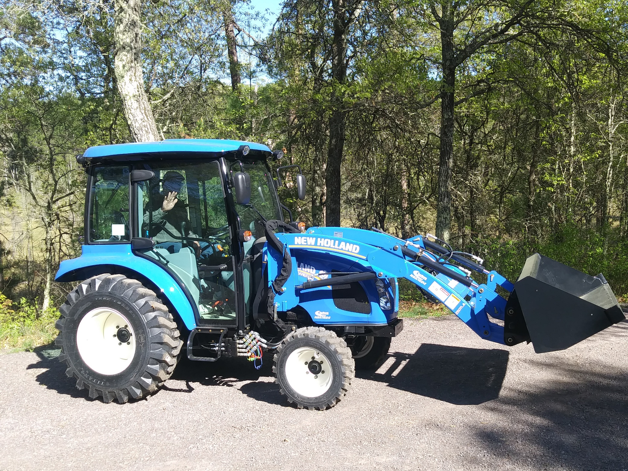

   / 40 hp Cab Tractor shopping experience
Got the new tractor home this weekend. Super comfortable to operate, very quiet and comfortable inside cab. As we guessed when we picked this tractor it's pretty tippy with a load in bucket and no weight on back. Installing my heavy duty 7 ft rear blade helped some but I'm planning to ballast tires before attempting to lift a round bale. It's overall a very pleasant purchase from a good dealer, wish the bucket was closer to the tractor so it was better balanced with a load in bucket. Thanks again to everyone for all the advice, hope this one is as solid of a machine as my Yanmar built 1070 was...it was bulletproof.
Based on my experience the major difference in the New Holland was the mid-pto was standard. New Holland loader extends further out from the front tires lowering capacity but increasing visibility. Same dealer had Farmall model that was a twin except for color. Incentives were better on the NH right now. Main reason I picked NH model was established dealer and no question powertrain warranty that specifically included seals and gaskets in print.
Main reason the mid-pto was a want was in case I ever added a front-mounted snowblower. May never use the pto but it was nice to have. We have a 55hp larger framed tractor for handling the bales regularly but if it was down and we needed to feed in a pinch want it to be able to. Trust me I would never drive and turn in a field with a large bale on this tractor...but my old JD 1070 handled them way better with a heavy back blade on and no ballast. Newer stuff is just not as heavy duty as the old stuff...but much easier to run and operate.
   / 40 hp Cab Tractor shopping experience #9
This has always been a negative in my opinion on some tractors including the New Holland. Kubota does the same thing with some of theirs...along with ridiculously tiny front wheels. There is a definite disadvantage to having the bucket extend so far from the front wheels. But just add a bunch of rear ballast and enjoy the new tractor!
