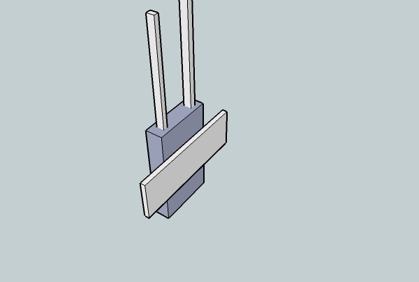

I have a 40 foot ladder that I need to use for projects around my house. Anyone that has used a 40 ft ladder knows how hard they are to move. I typically have to ask a neighbor to help me move it and set it up.
I've been thinking of making an attachment for my skid steer compatible FEL that would lift and stabilize the ladder for me.
I'm thinking of making a frame with a "pocket" for the ladder to lift and lower it. I would plan on lowering the ladder to 20ft when moving it around. I'm also thinking that the attachment would be a good way to stabilize the base when I'm up the ladder.
Anyone ever thought of this? I'm thinking a 6 Foot pocket for the ladder made out of some C Channel steel would be strong enough and high enough to hold things but I'm not entirely sure (I'm not an engineer).
Suggestions?

   / 40 Foot Ladder Mover FEL Attachment?
Here's my quickie mock-up in Google SketchUp (of which I'm no expert). Anyways, I think the concept is to have enough support to tilt the ladder upright for raising and lowering and then to be able to gently tilt it towards the house.
I might need to add some adjustable feet to the outside of the "box" to provide a level base.
I think the 3pt hitch won't be high enough on the ladder to control it very well. Once that ladder is fully extended it is pretty hard to control.
I think the key is to have the FEL as high as possible on the ladder to reduce the instability.
I'm also thinking of making the pocket hollow so it can slide up the ladder then I can leave the levellers on the legs to level the ladder and perhaps add some form of adjustable bars that connect the tractor frame to the base of the ladder to stabilize the base.
I'll try to make some more ideas with SketchUp.
