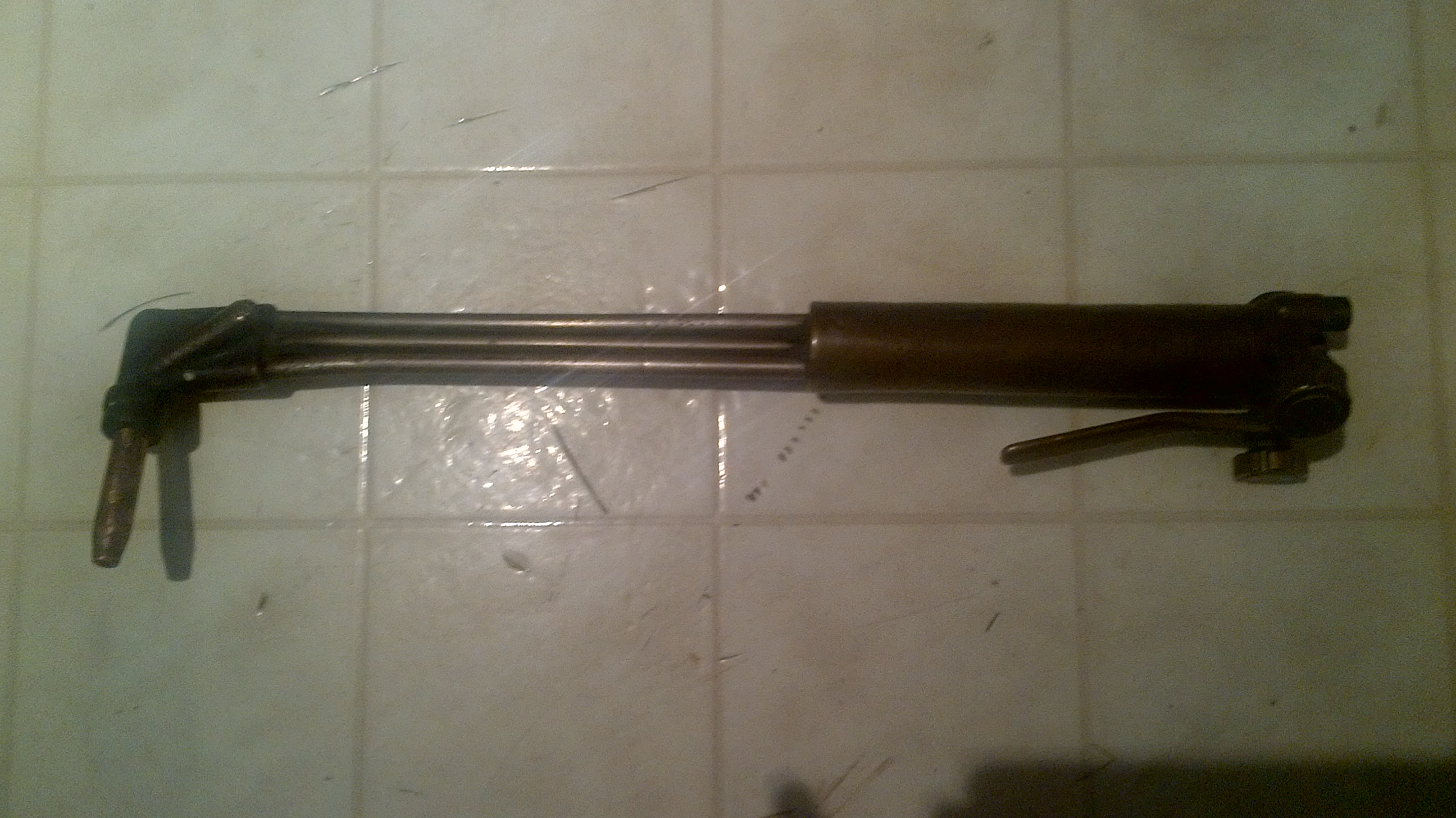

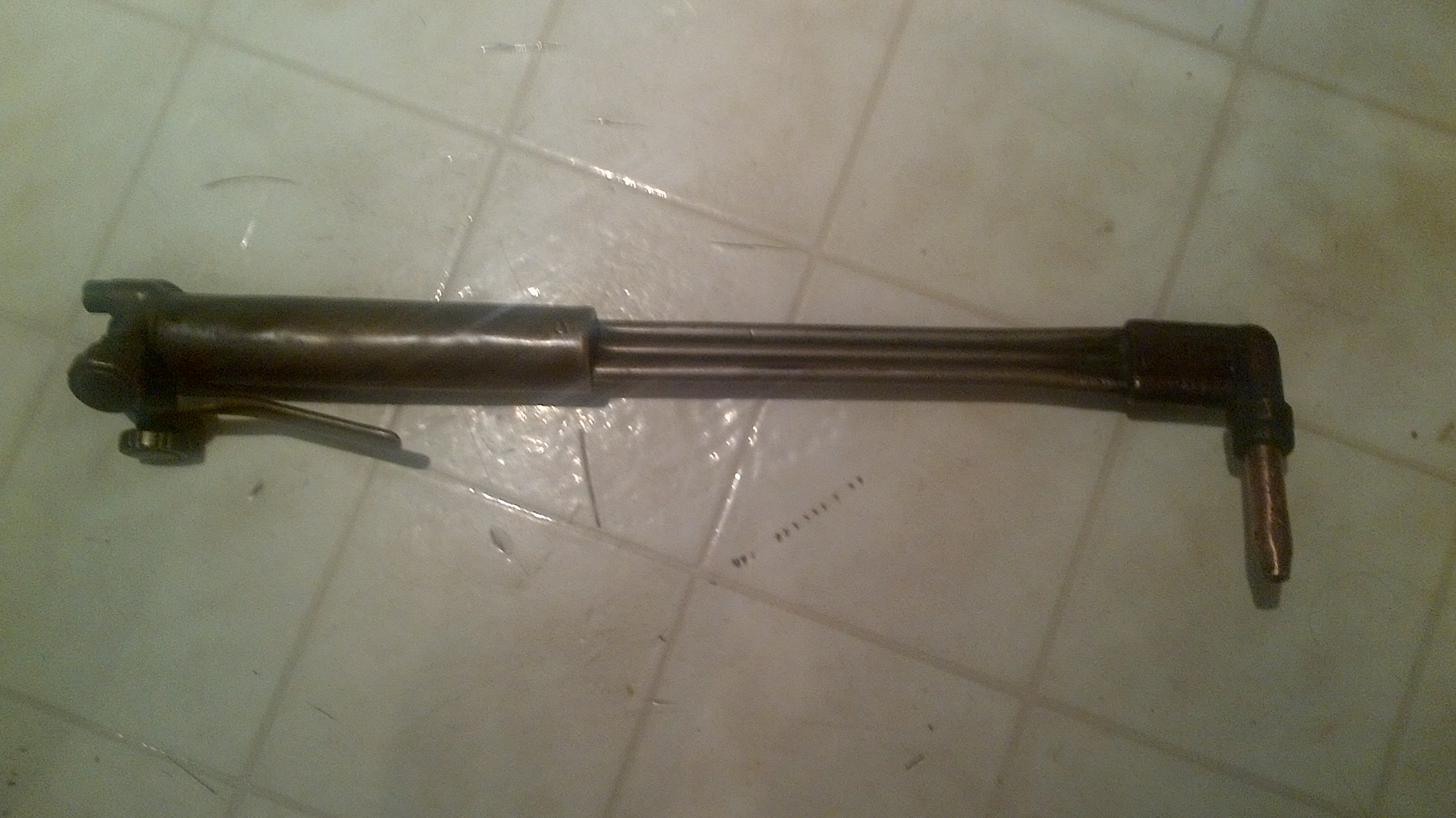

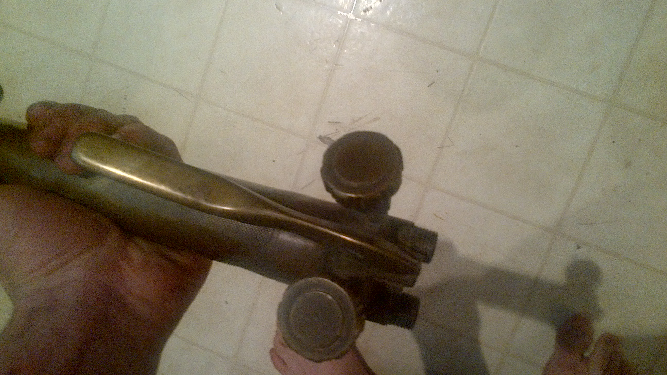

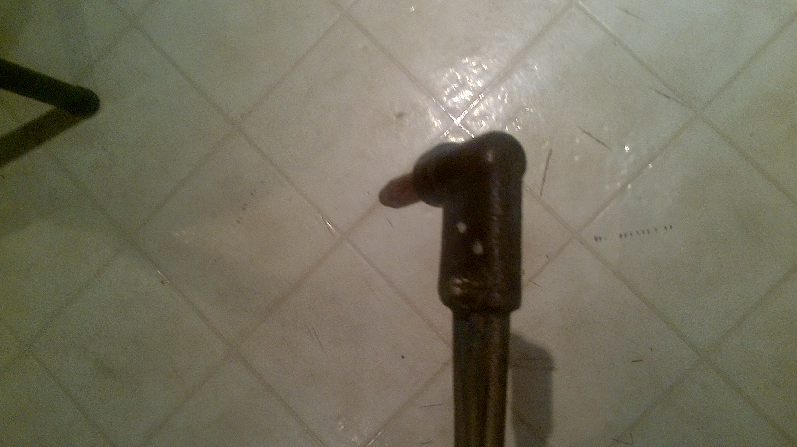

I think I did pretty good on this straight torch. Only cost me $4 (yes really!) It's a really old Harris model 76. Some bits look a little rough, but everything seemed to check out alright. The valves all work properly, and nothing seems to leak. Any thing else I should check before lighting it up? I don't trust the tip, it got a bit mangled during removal (I didn't realize it was a screw off, and ended up separating the two pieces) The torch its self was unharmed (close inspection revealed absolutely no damage) But since I don't want to take any chances, I am ordering a tip adapter, and a cutting tip. I am also getting a tip adapter for my airco, and the rosebud for the adapter. Everything seems mechanically perfect, and I can't find anything wrong. But if any of you torch experts have something else I should check, PLEASE tell me!
Now for some pictures.
   / $4 torch score! #2
Everything seats and seems to be good right. The tip does not look like a Harris 6290. I think you will have a hard time getting a tip for it unless GOSS has one. If it is a 6290-whatever. let me know. Good Luck..
   / $4 torch score!
Everything seems perfectly fine. It's a 7490 tip (I checked a chart) There is an American torch tip adapter for that one, so that is the route I will go. I figured at $4 even if it ended up being a wall hanger, it was still worth it.
   / $4 torch score! #4
I love the old torches. The Brass is worth 4 bucks.
   / $4 torch score!
I think the torch may have got some oil in it.. :(
I have some chlorinated brake cleaner (PERC) would that work? It leaves no residue. I also have a can of trichlorethylene, would that be better? If you think neither is OK, where can I get the proper regulator cleaner?
   / $4 torch score! #6
When I worked at a welding supply, we always used trich. That is what I would vote.
   / $4 torch score!
OK, tonight I will tear the torch down, get it real clean with trich and put it back together. I'm ordering tips tonight.
   / $4 torch score! #8
Trichlorethane or how ever you sp
ell it is the best degreaser out there because it's non flamable. Definatly use it. It has been banned in USA due to someones thinking that it harmed the ozone. i still have 2 5 gln cans. it was also sold under the name Safety Solvent by a company named Crown. Very good stuff. Gun Scrubber spray would be a good 2nd choice.
   / $4 torch score! #9
Years ago I had a Smith that would back fire & start burning in the handle. Still worked fine until it got so hot you could not hold it. In those days I had asbestos gloves and they only worked for a while.
   / $4 torch score! #10
The new torches have flashback arrestors. The old ones don't.
However, it hasn't ever seemed to be an issue for me.\
I suppose, like a seat belt, you don't need it, until you really NEED it.
