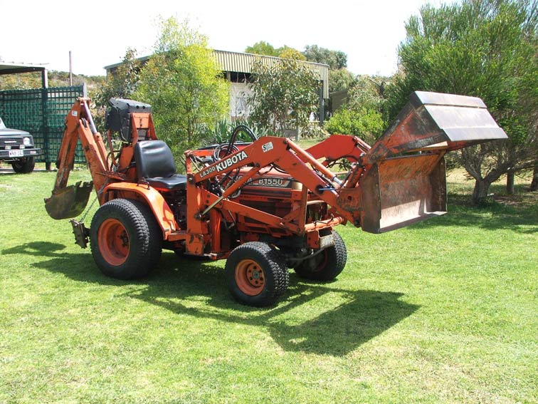

Has any one used one ? Do they bend easy ? I was thinking about getting one, just wondering if they are worth the $. Do they make one for smaller tractors ? I own a B7500 HST Does anybody know of a company that makes one ??

A 4in1 takes your tractor up to a whole new level. I guarantee it will be the best attachment you ever add. Think about it. How many skidsteers do you see with an ordinary bucket? Hardly any. (The pro's aren't fools). About the only disadvantage is that scooping from a nice neat pile of dirt, sand or gravel may be less efficient than with a dedicated bucket. But how often do you do that? Most often I'm scooping up dirt and debris that I've scraped up with the 4in1.
All the other tricks - dozing, grappling, back dragging, etc, etc, etc, are extras that you can't do with an ordinary bucket. The clam gives you great 'reach' thats very handy (especially for a small tractor). But a key point is that with a 4in1 you can do all these things almost similtaneously. You've gotta try one to really understand what that means. Or watch a pro with a Bobcat. He'll often be working the clam as much as the bucket.
A 4in1 is as much benefit to a small tractor as a big one. Maybe even more so because the clam can often make up for the lack of reach, weight and traction that small tractors suffer from. For example, with a combination of dozing and clamming, you can 'pick up' a mess of rock and dirt that would cause a little tractor with an ordinary bucket to be spinning its wheels at the first sign of resistance.
What make/model 4-in-1 do you have on your B1550? I always heard that the increased weight of the 4-in-1 setup was too much for a smaller tractor and decreased its total lift capacity significantly.
