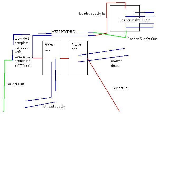

Is there anyway to have 4 hydraulic levers on a Cub Cadet 3184?
I have two now one for a 3 point hitch and one for the deck. I can get a dozer blade with hydraulic angling for cheap. I would need two new levers though one to move the blade side to side and one to move it up and down.

Here is what I want to do. I want to add the quick disconnects under the left floor board like the 3200 has. I can get kit number 190-415-100 for this, but I don't want to use the cub cadet hydro actuator on the fender. I want to use this for the supply lines for a loader (or other tool) that has its own hydro actuators on it. Is there any way to make this work when the loader is off the mower? I would think not having a valve on the Cub would disconnect the hydro circuit. How do you get around this?
The other option I thought of would be to install the valve for the cub cadet kit, but when using the loader lock the cub cadet valve actuator arm up or down to supply the loader valve with hydro fluid. Would this work?

why not just run the line without a valve? the quick disconnect would work like the valve is closed whan nothing is hooked up to it.

Ya think the plow is out and I am only looking at making or getting a loader. The problem I see with leaving the valve out is there would be no return path back to the pump unless there was a bypass valve installed somewhere, or make a loop at the end of the quick connects to loop the fluid back to the pump when there is no loader on the front.

make the quick disconnects the same male and female and just connect them. id really consider combining everything into the loader, KISS- keep it stupid simple.

I don't think the pump on your tractor would be enough to handle a loader. All the loader I've ever seen on cub cadets always have a auxiliary pump for the loader. From what I've read about, if you use the hydro pump, the loader will work, but be painfully slow. But i could be very wrong. I usually only deal with the IH built Cub Cadets, sop maybe the newer ones have a higher output pump than the older ones.
