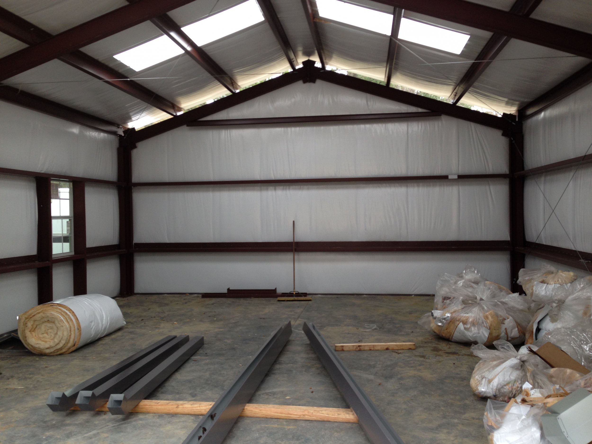

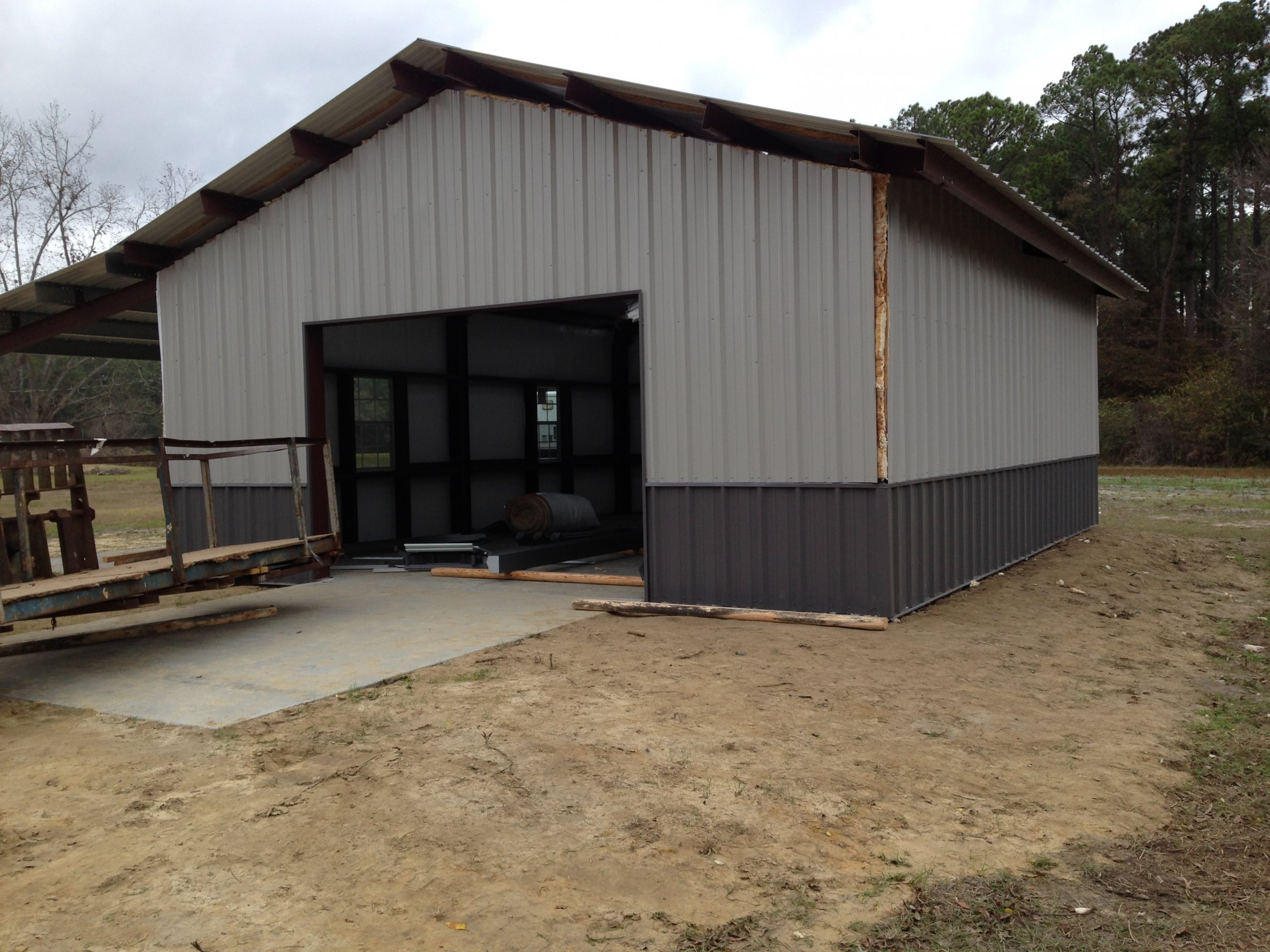

I don’t quite follow your question but here’s how my building is constructed. The roof and side panels are screwed directly to the on edge purlins. Professionally erected following the manufacturer’s design.
