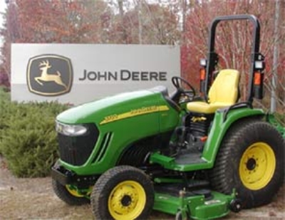

Might as well post the pic!
This one says 3720?
/forums/images/graemlins/cool.gif

Our UK buddies get the old style headlights...
