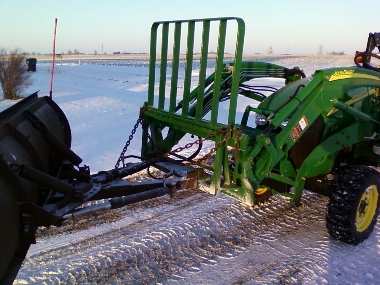

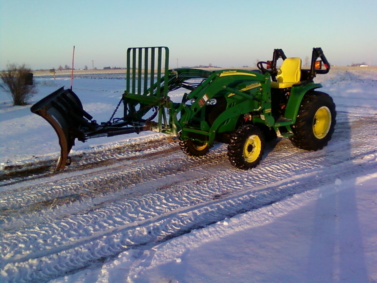

I have mounted a snow plow on my 3320 but it is not a Deere brand. This is a 7' truck plow that I mounted on my fork lift frame. I have only used it a couple of times and was able to push a full blade of dry snow with out a problem. I can not put any down pressure on the blade becuse I use a chain lift like the truck mount would have had. I keep the loader arms about 6" off the ground and slack in the chain. I run in B range on flat ground. You have to drive a long way to find a hill around here. The tractor will let you know when it is out of power or traction.
If you search other threads there are a lot of people who mount plows on their loader frames with mixed success.
Dan
