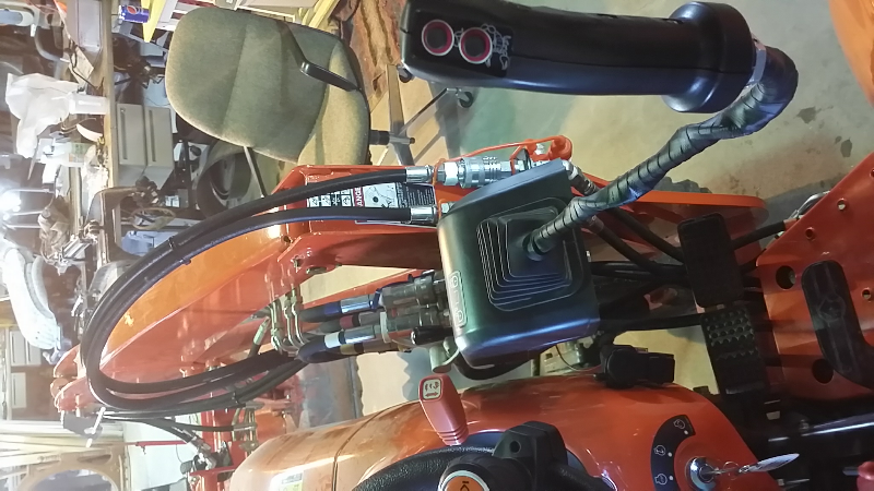

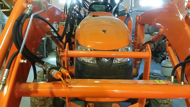

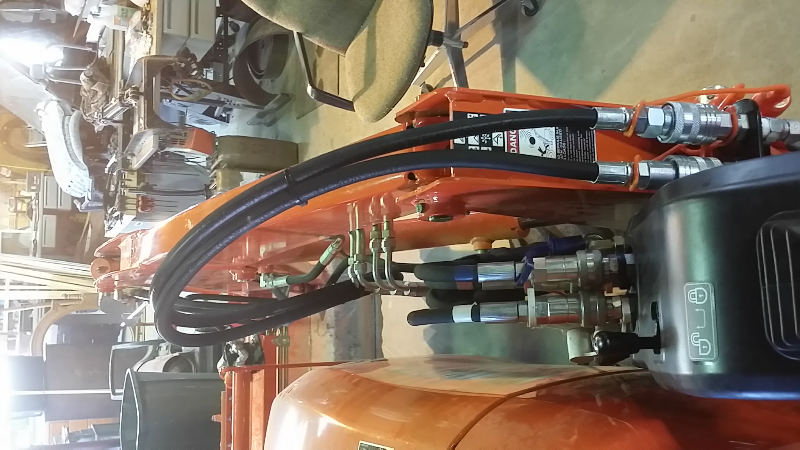

I got a land pride kit from my dealer for my b2620, nice kit! Great fit and finish! No complaints using it with my grapple. It was around $650
   / 3rd function valve for Kubota #8
Try Brian at fit right hydraulics he is great and it will be custom to you. Just finished this weekend.
