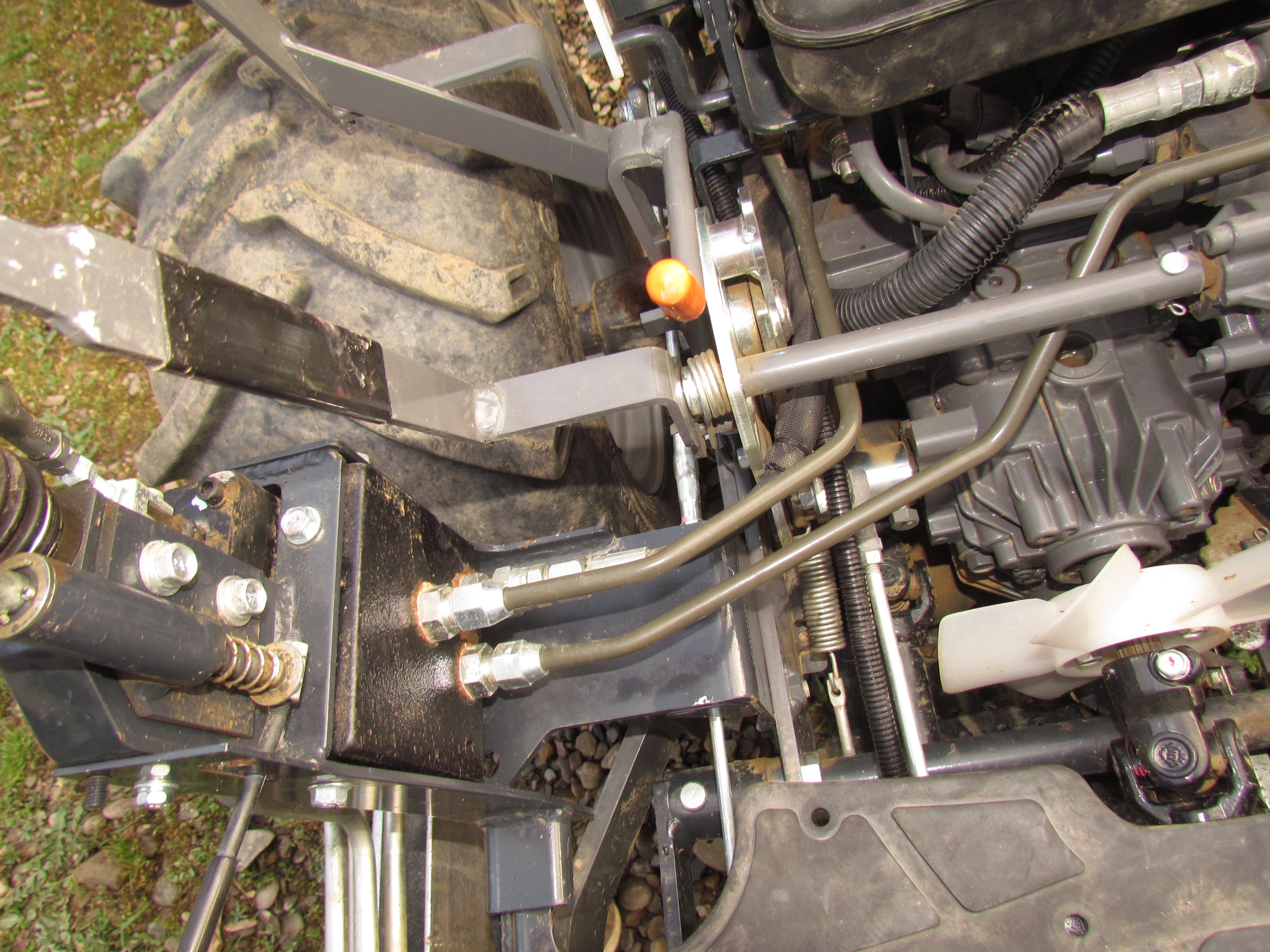

I'm new owner of a low hour 2605h. I'm also new owner of a Lane Shark LS4, which requires installation of WR Long continuous flow 3rd function. I'm not familiar with hydraulic installs, and this install calls for identification of the power beyond port. Is there someone here that can tell me exactly which port it is. I can't see any embossed letters on the valve.
Thank you.
@dicktill may be able to help
@h8hoos: It would be very handy to have one or more photos of your loader valve. I'm attaching a photo of the loader valve on my 2022 Massey Ferguson GC1723EB (looking towards the rear). The front hard line is "pressure in"; the top hard line is "tank" or "return". The rear flex line is "pressure beyond" and is the line you want to "break into" to attach the 3rd function valve. For the GC1723E model without backhoe, this is another hard line.
