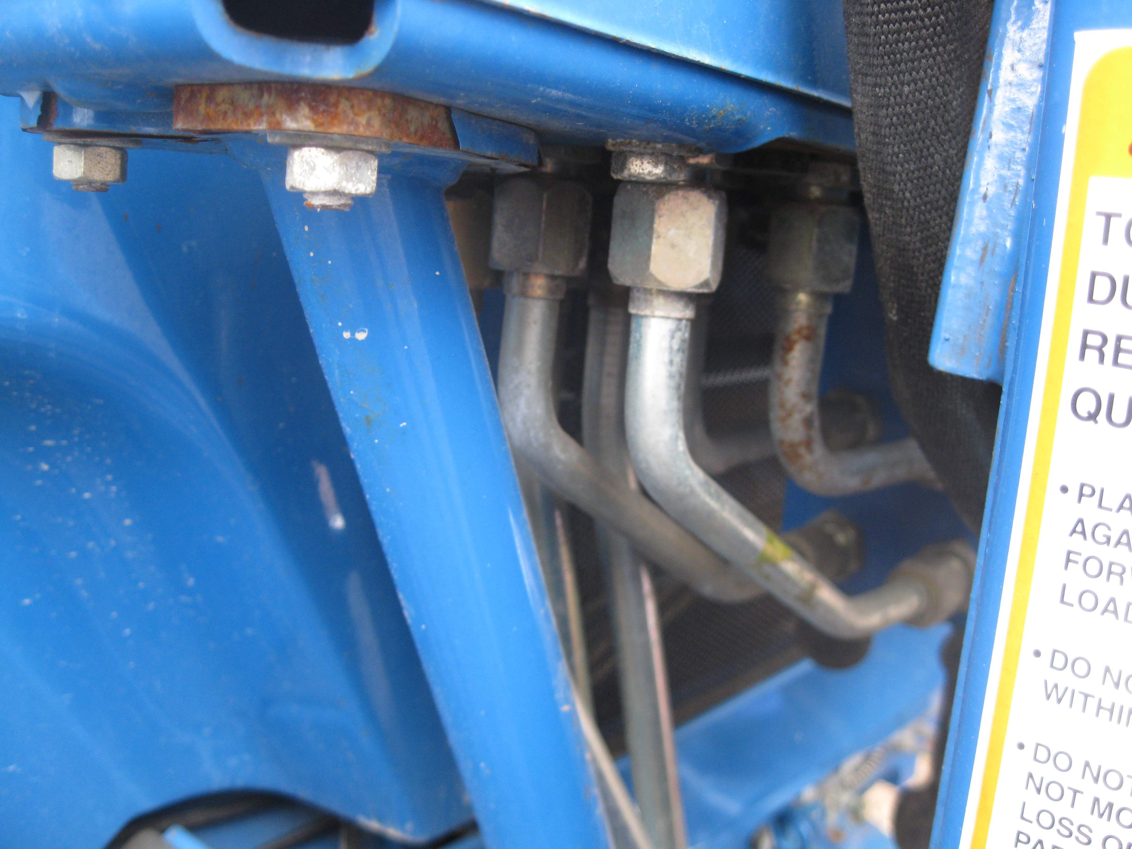

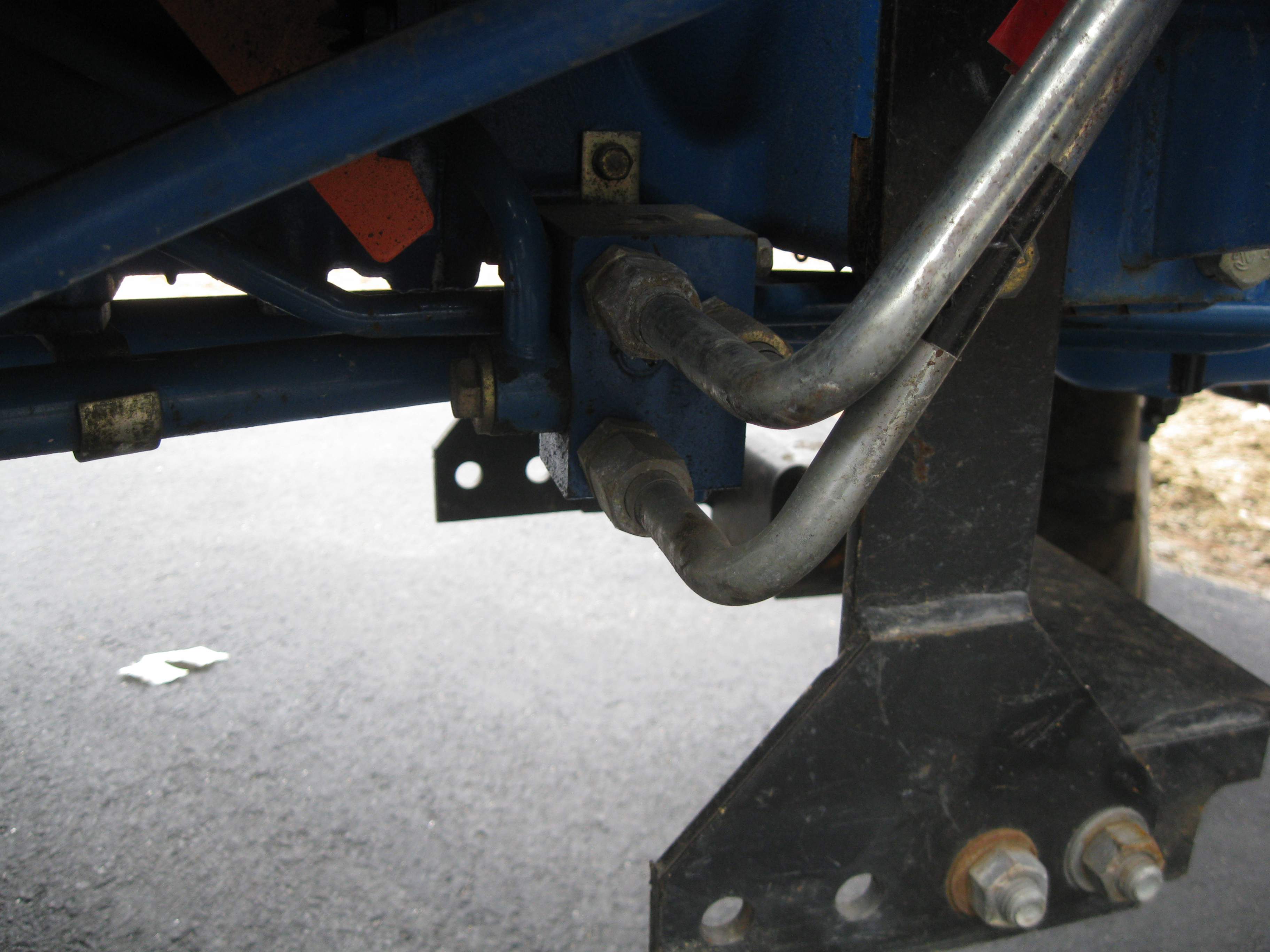

I have a Ford / New Holland 1920 tractor and loader model 7308 and a Woods BH9000 backhoe. I'm looking to install a grapple on the loader to move brush and logs around on my property. I've been reading many of the threads about this and have a fairly good understanding of what needs to be done. I would like to go with true 3rd function hydraulics. The kits seem to be a bit pricey but maybe they are worth it. I believe I located the loader valve and the power beyond port running to the loader controls. These are plumed with pipe instead of hoses. Could I get some help with this? Is it worth the $700 or $800 to purchase a kit? How hard is it to plumb with my tractor being hard plumed?

If you went with a diverter, it will be a lot easier. No hard lines to fool with, just unplug the loader curl circuit lines, run those to the diverter and do some new hoses to and from the diverter, you're all set. A lot of people think that they need a true 3rd function for whatever reason, in reality the majority of people do not, let alone actually make use of doing 3 functions at the same time.

Wow ovrszd what a lot of work. How did you hook up the new valve? Did you use the power beyond port? The problem with mine is it hard plumed. I've been thinking of just using the rear remotes to a new valve and then grapple. Then MntViewRanch suggested the diverter valve. That seems to be the quickest and least expensive.

As for being hard plumbed that would add some complexity but still could be overcome easily. Whatever hard lines you will move can be replaced with hoses with the proper end fittings.
