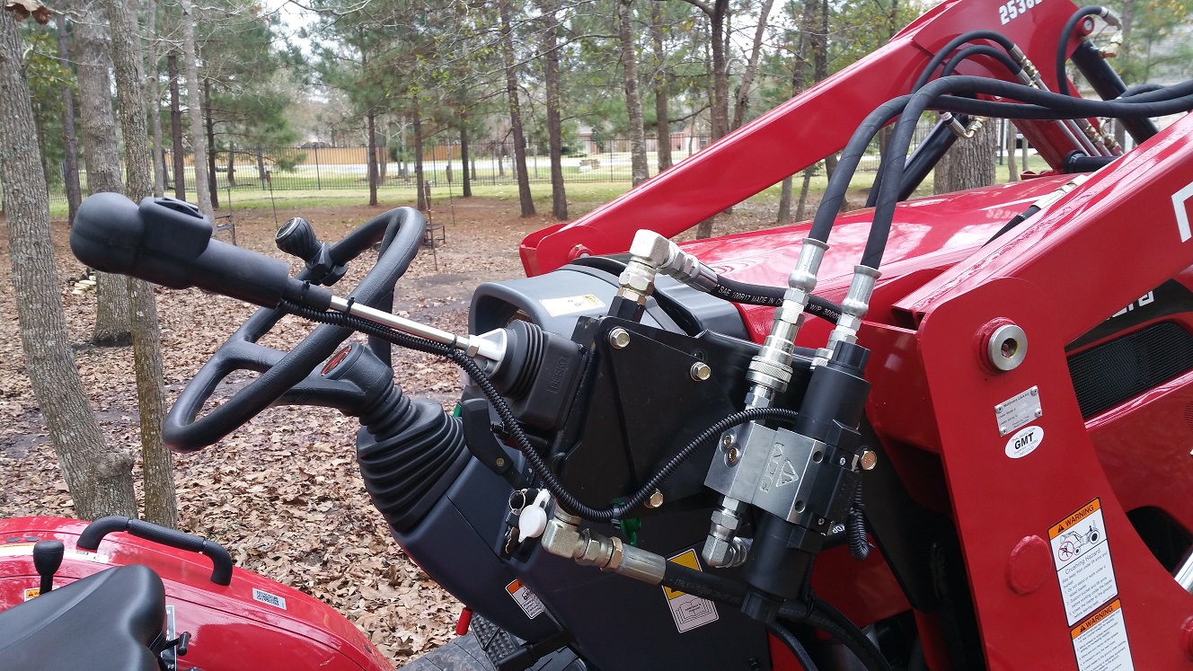

EA Wicked grapple. 54" or 60". They also sell the WR Long 3rd function kit which is a direct bolt on and works well.

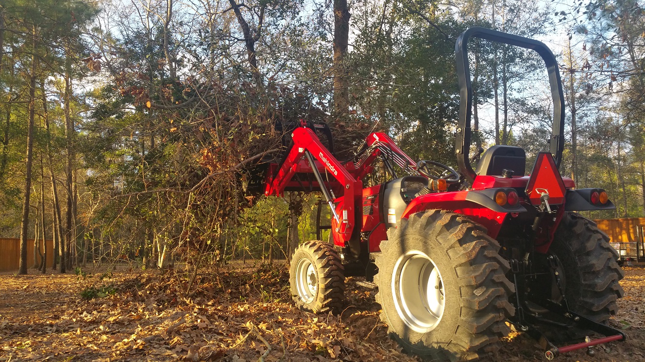

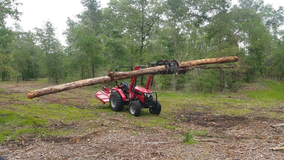

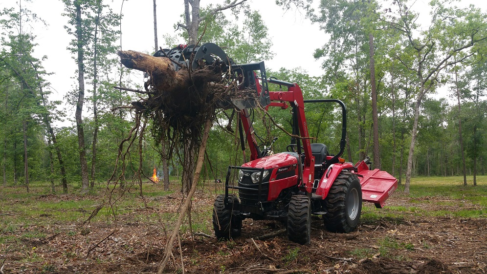

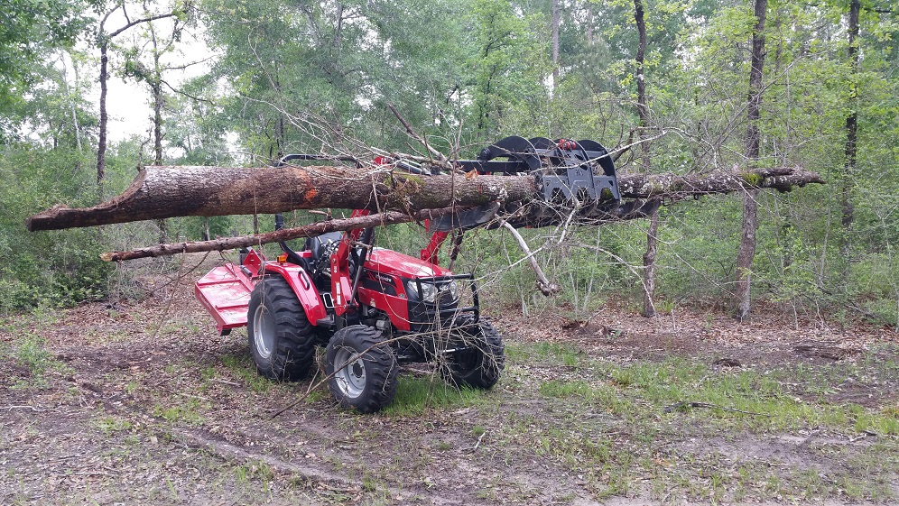

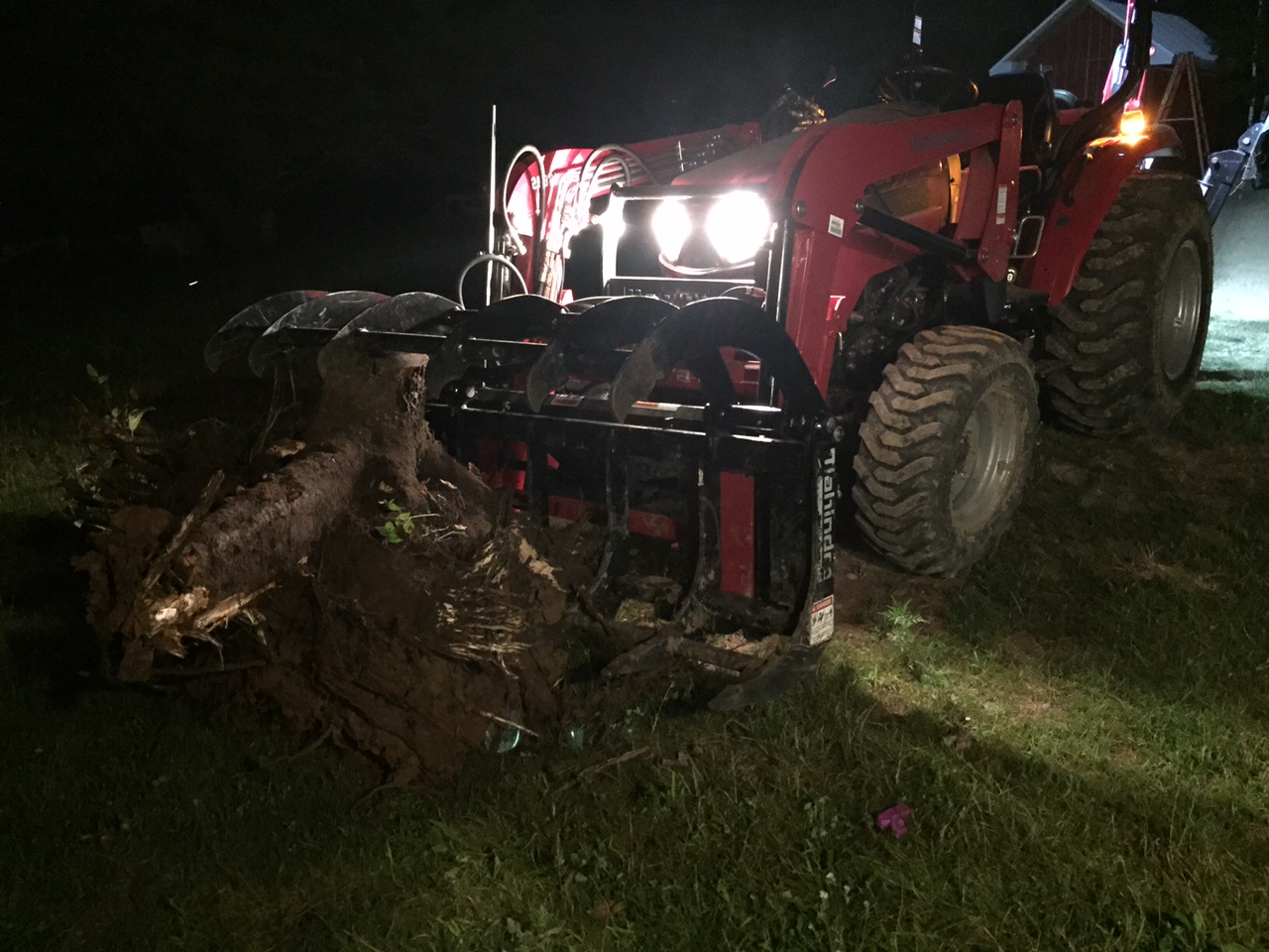

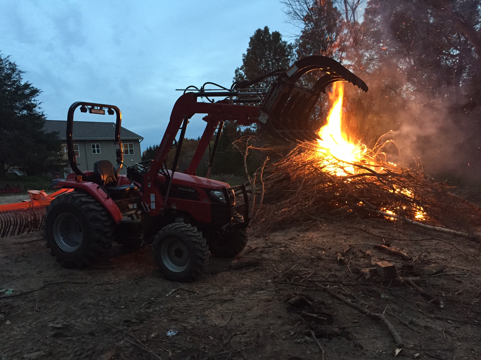

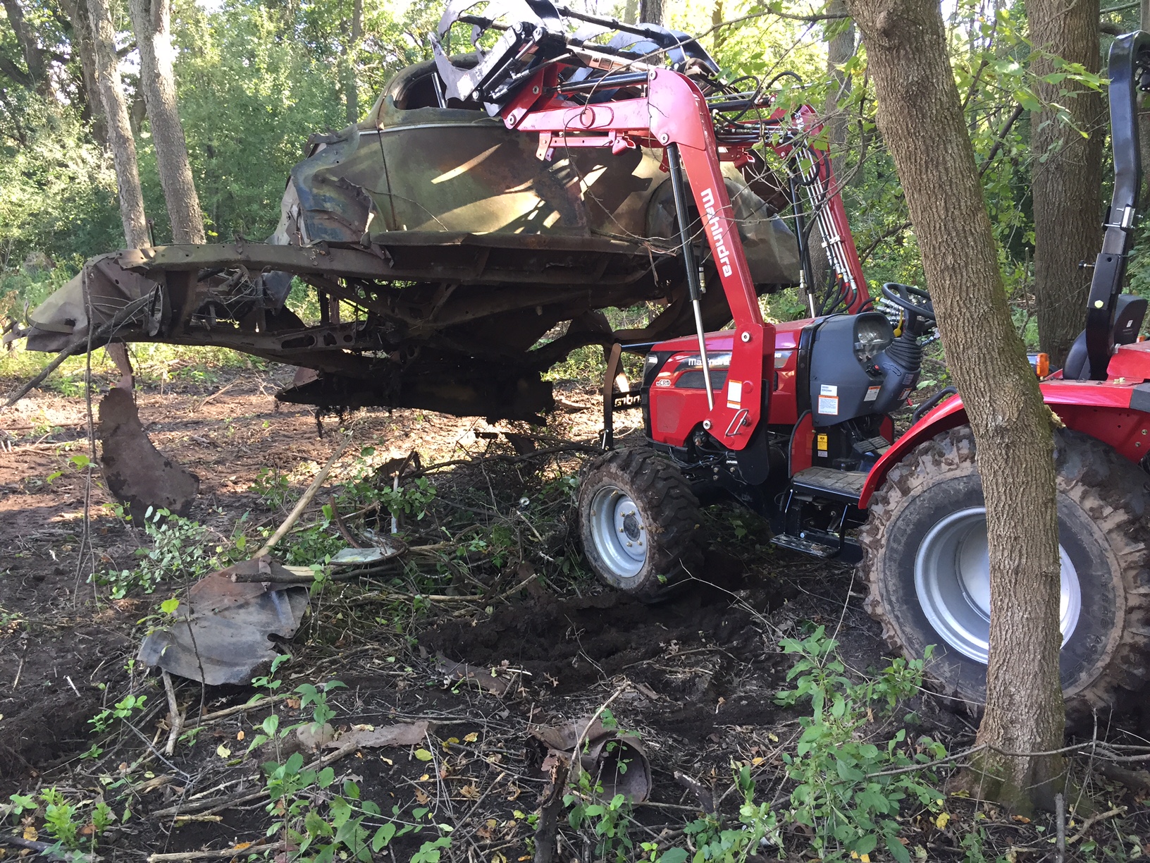

Here is the 60" Single Lid Wicked on my 2538 (Most used attachment by a LONG shot and works great when brus hogging in the woods and moving deadfall and limbs around...) You really can't go wrong with a grapple. Here is one more thread with tons of discussion on wide vs narrow and one vs two lids: http://www.tractorbynet.com/forums/attachments/267492-wicked-root-debris-grapple.html
Good luck!

My 2538 has 2 lines on top and 2 on the bottom of the FEL valve,my question is which one is the power beyond?
Mine only has one line out the top of the loader valve as you can see in the picture above. The PB is routed in series through to the 3rd function and then main line back to the rear. Perhaps this post could be helpful to you.
http://www.tractorbynet.com/forums/mahindra-owning-operating/375734-2538-hst-hydraulics.html

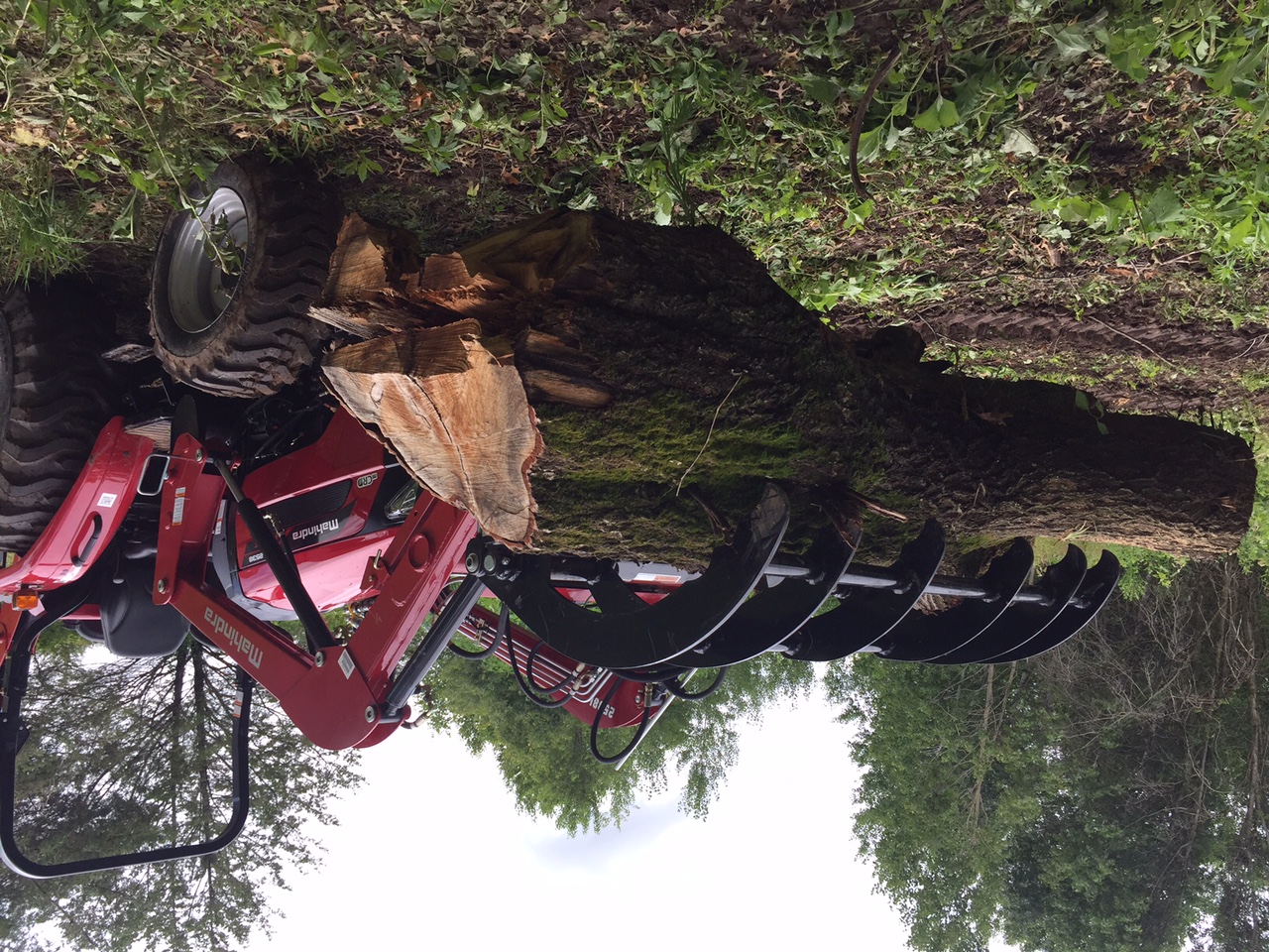

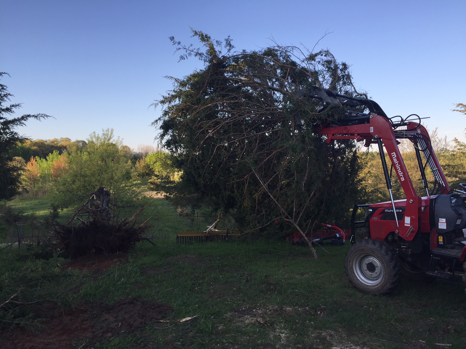

I have the 2538 CAB. I have the WR Kit and EA 66" Single lid.
Kit was a bit of fun to install, but not a big deal for an average mechanically able person.
I am not a fan of EA not including a bracket for the ends of the hoses on the FEL. I understand their idea of leaving them loose, but I have a lot of free play and the hoses can get caught.
The grapple is a solid bit of kit. It works great on larger and heavier items. I am less enamored with it for brush. Their root rake looks like it would handle smaller brush, etc better.
Overall I am happy, but for my use I would rather have gotten this version:
