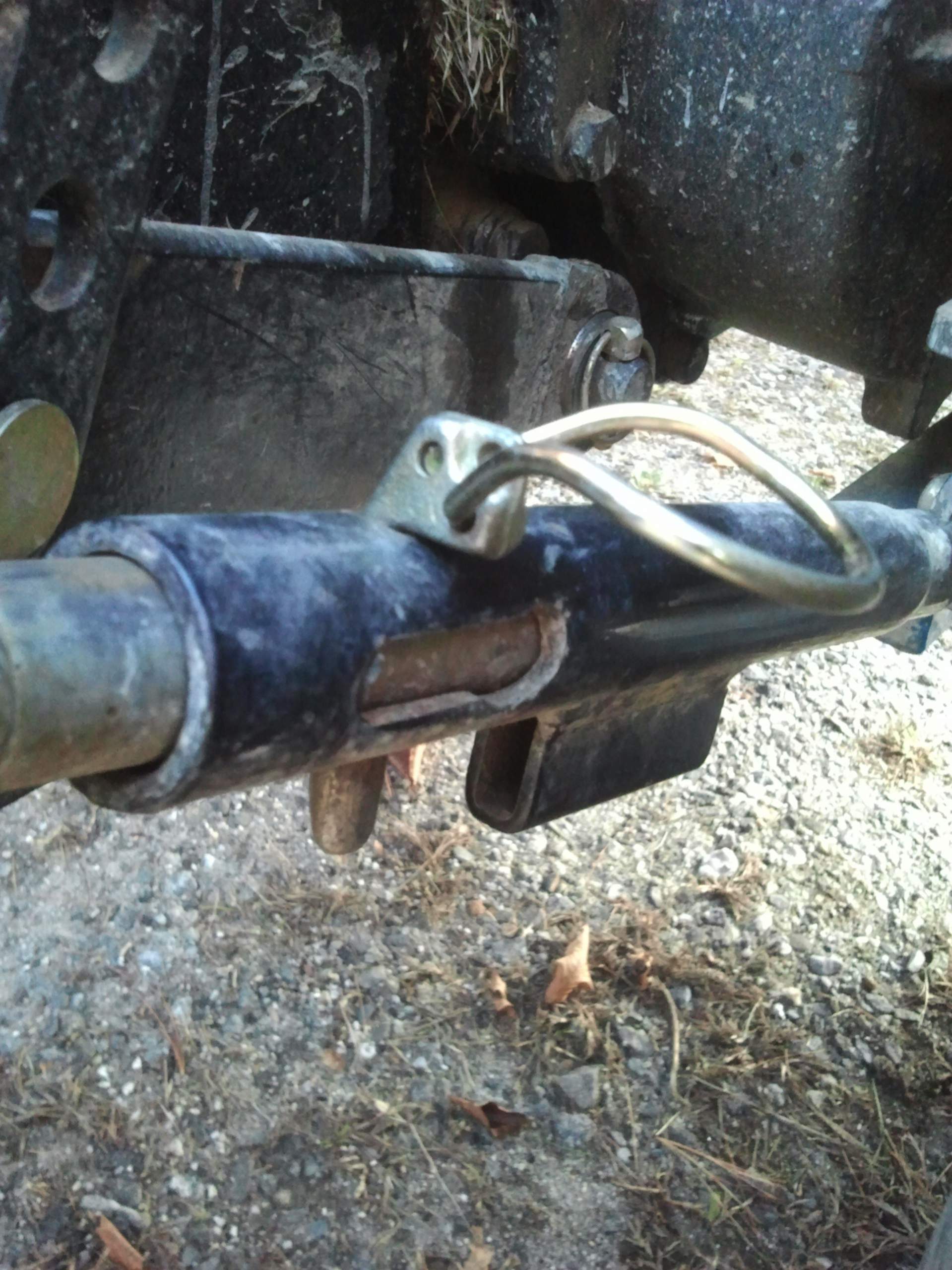

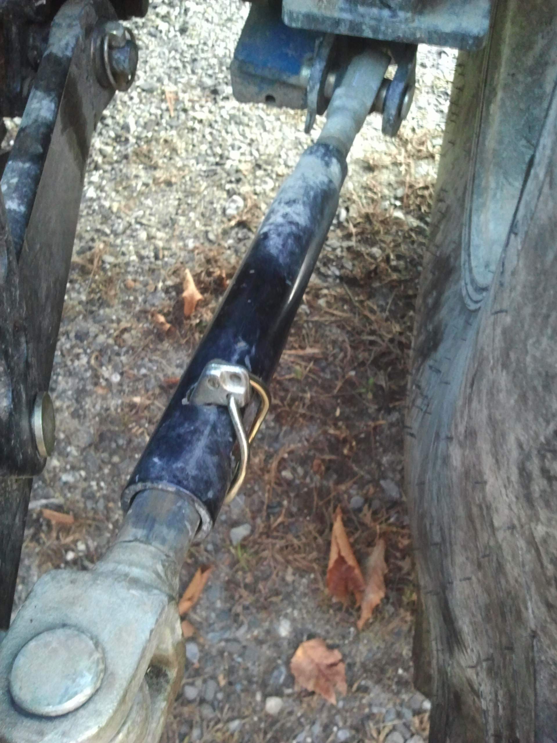

Here is a pic of the stabilizer
The pin is in the hole to give it a rigid attachment, but a 1/4 turn would enable me to use the slot, which would give the ends of the lift arms maybe 4" of sway.
