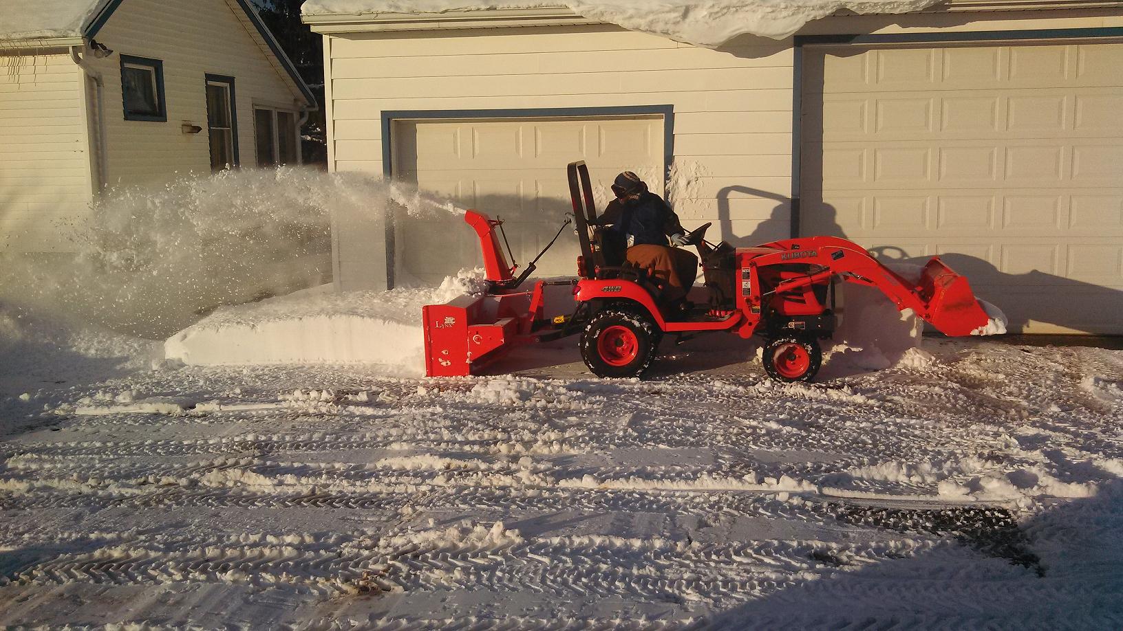

Forgot to attach a picture of my setup (taken last winter, my wife is driving). I also wanted use of the front loader at the same time as the blower. It's true, it's not a lot of fun when the wind is blowing in your face. But if you need to move snow away from a vehicle or building and don't want to chance throwing a rock at it, the bucket works well. If you have heavy wet snow that the blower won't handle, the bucket will again save the day. If you get a pile of salty/slushy snow at the end of your driveway, the bucket will again be helpful. The machine is also much more balanced. To each his own...
