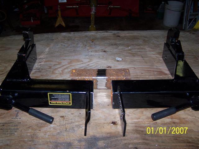

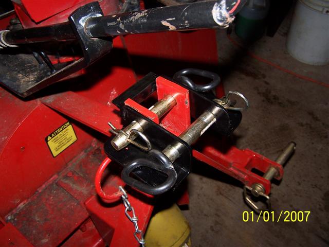

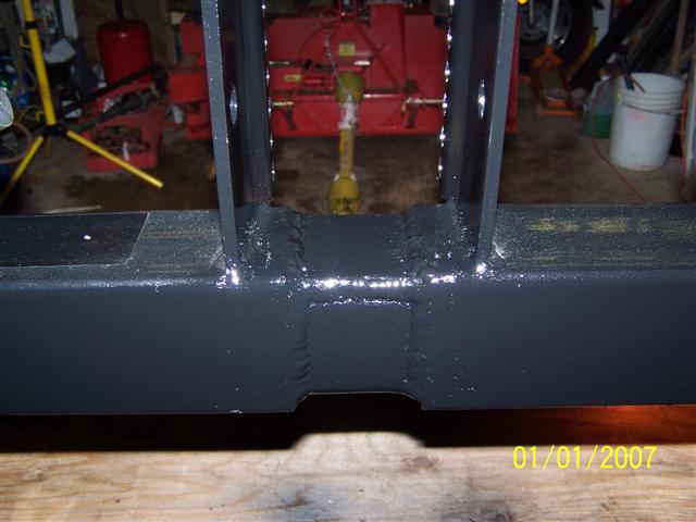

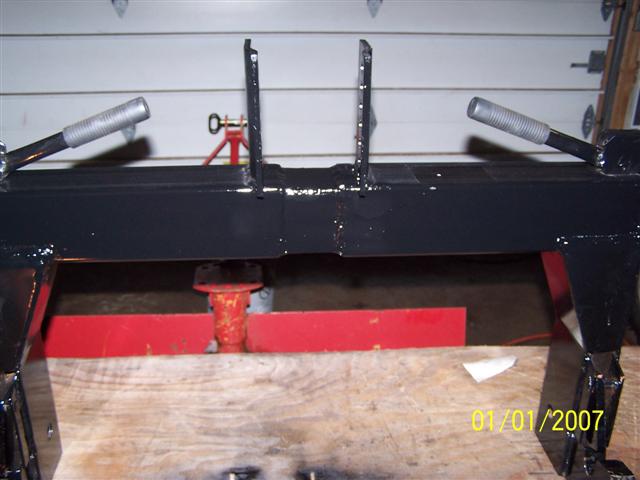

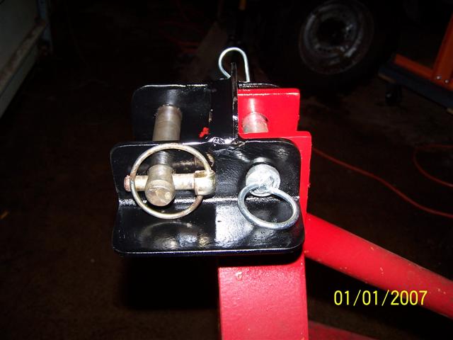

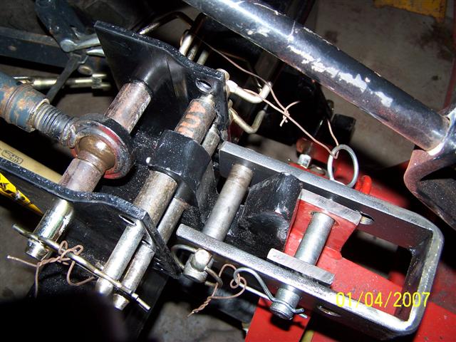

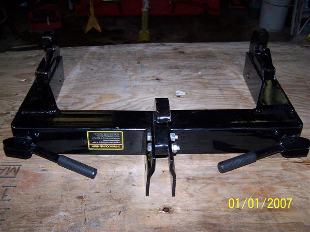

I got a HF quick hitch for Christmas too. (See Santa brought some new tools thread in attachments) It fit the tractor fine but would not fit the implements. I have included some pics that show the mods I had to make. It was easier to modify the quick hitch than to modify all the implements. The bottom quick mounts were not spaced far enough apart and the top hook would not go into the implements such as BB, rake, snowblower, homemade trailer hitch etc. My rotary mower u-type top link bracket will work OK.
Pic 1 Quick Hitch as rec'd
Pic 2 Hitch cut in half and spaced apart
Pic 3 Square steel tube inserted as sleeve
Pic 4 Welded up
Pic 5 Painted
Pic 6 Top link adapter for snow blower
Pic 7 Top link adapter for Back blade
Pic 8 Last one is complete assy.
That's all I could do today since I need to get more steel to make additional top link adapters and make some spacers for the top hook and top link arm.

   / 3PT quick hitch top pin adjustment #4
George,
Great looking welds there. I have to make mine so it can adjust from one width to another, having different category implements. So I'm going to make that sleeve adjustable instead of welding. I plan on using it on the front fel for moving implements around, not on the rear 3pt.
   / 3PT quick hitch top pin adjustment #5
Rob,
Good idea since you have different catagory implements. I thought of doing that but after measuring my implements I was able to come up with one permanent width which is why I welded mine. I also figured its supposed to be a quick hitch so if I had to take time to pull pins and adjust the hitch width for each implement, it would be quicker to just hook to the 3 pt. I didn't mind doing that anyway but since the wife bought it I might as well use it.
George

   / 3PT quick hitch top pin adjustment #10
Hooked,
I'm not going to move the plates back for the top hook. I've already made spacers to keep the hook centered and use pins for quick height adjustment when needed.
