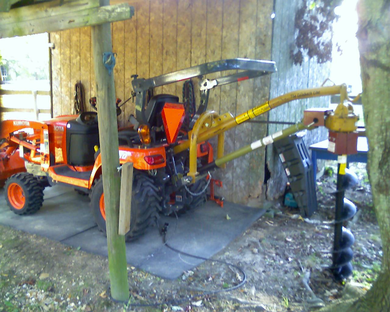

akjohnston - I have a L7200JR mounted to my BX24 and would recommend it to you. Currently, I have another thread going, within the same forum, in regards to the best way to operate this piece of equipment. In my limited use, it was easy to install and seems to take a good beating for less price than a LandPride version. Not knocking on LandPride since I have never used one of theirs, just the price is so much cheaper.
Redbug - The L7200 and L7200JR have a pendulum swing between the gearbox and the auger. My understanding (by reading the 7200JR manual) that the 7300 doesn't have this same swing motion to line up the auger with the hole. The metal rod is used to position the auger while still sitting in the operators seats. One major problem with the metal rod is that you can accidentally bend it like I have. If you don't watch it, the rod can get caught under the U-shapped frame.
If any use to anyone, attached are 3 photos of my L7200JR mounted to my BX24.

I have the 7200 and it works just fine.
It does have that handle to position the auger and you have to be careful with it. My wife was operating it from the seat when she pulled up the 3pt to clear the dirt out. She got her hand caught between the back of her seat and the end of that handle and got a pretty good gash. I ended up putting a generous bend in the end of the handle like a "D" shaped shovel handle.
In reading the difference between the 7200 and the 7300 (which does not come with the positioning handle) the only difference I could see was that the 7300 has a heavier casing. They look to have the same "swinging" gear box design so I don't know why the 7300 doesn't have the handle on it unless what thavil said, "not the same swinging motion" is the difference. But I couldn't tell from the product photos and descriptions below...
