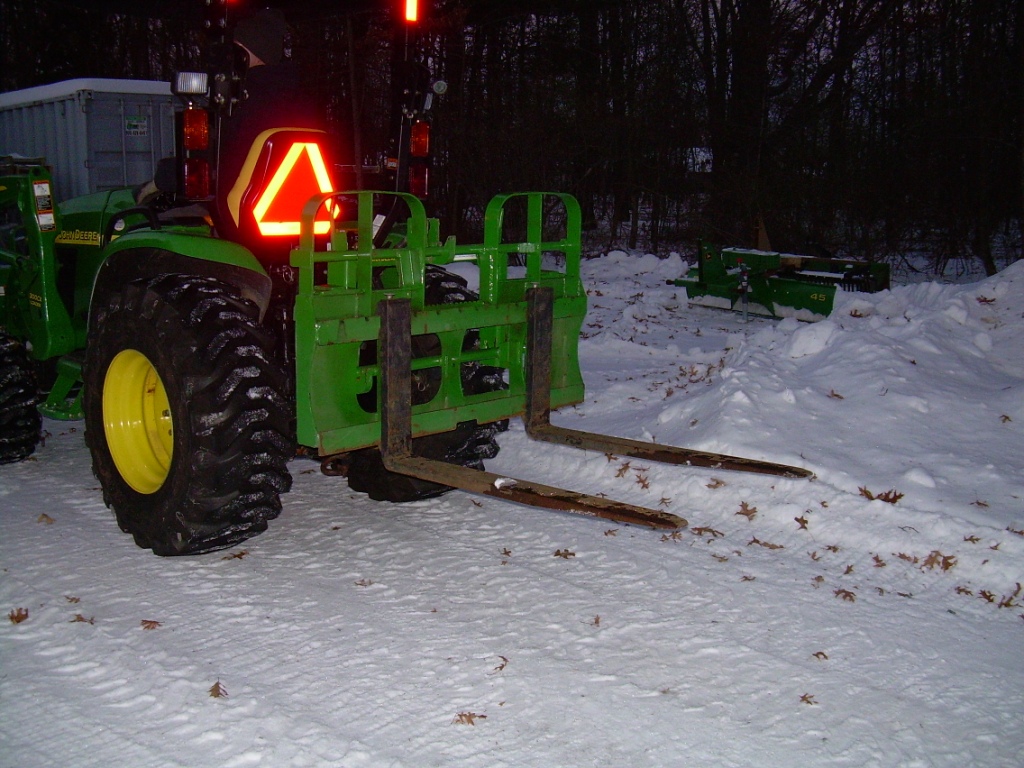

Well I don't have hands on experience with any of them, But I do like the #3, it's only 20 dollars more than #2 and has twice the rating.
I've never been thrilled with those angle iron carryalls for using as forks. I thought about getting one for building a wood box on though.
If you don't need the wider stance of #4 for actual bale carrying then why spend the extra money, but the only thing is you say you want to carry logs, with the narrower forks that might be a little tricky, you'd have to pick em right at the middle.
The #3 looks pretty well made in the picture, have you seen it in person?
I modded my loader forks to work with QH on 3pt, it is a nice way to move things around.
JB.

Saw it, bought it. Looks sturdy for CAT1.
Any idea what that set of forks weigh?
Also, if you use a quick hitch, those don't look like they would work with one.
   / 3pt Pallet forks from Agri-supply
Probably wouldn't work with a quick hitch. They feel like at least 50lb, maybe more. I only lifted them once.
