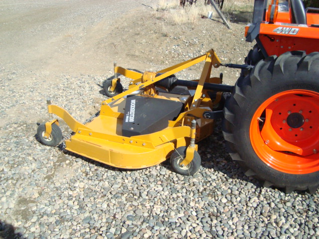

I am looking into possibly purchasing a John Deere 272 3pt finishing mower and I'm not sure if I like the idea of no wheels in the front. I have always seen the finishing mowers with 4 tires on them but not just the 2 in the back. Is there a reason (cutting or mowing) that they have mostly all gone to the 4? Should I look for the 4 wheeled type?
What are your opinions?

I don't like the idea of just 2 wheels. You want a finish mower to follow the ground, not how the tractor is moving. There are times when the tractor is moving up, and the mower is still level, or maybe moving down. If the mower has four wheels, it follows the ground, giving you an even cut. If you have only two wheels, the front of the mower will pull up with the tractor, and you won't cut anything. If you run a brush hog for any length of time, you'll see how that can happen, because they usually only have rear wheels.
The other thing is that with only two wheels, you're constantly adjusting the 3pt height to match the ground contour. With four wheels, you drop the mower, and that's it....it already follows the ground contour.

I had a JD 261 mower with only the two gauge wheels. It was a great mower. But it all depends on your terrain. They dont do well on a rolling property with lots of little "knolls". But mostly flat and or a flatish hillside, they are great.
I did use check chains though. Attached to the front of the mower and up to the tractor. That allowed you to just lower the 3PH lever and forget about it. Those mowers also have the swinging toplink mount, so it does follow the ground a little. If its in good shape, $600 or so is a fair price. Any less and its a heck of a deal IMO. Any more.....judgement call.

I haven't had any Deere mowers, but do like the 4-wheeled RFM's because they mow without scalping on uneven ground.

A finish mower with only 2 wheels? Yeah, I would have to pass on that. I would imagine that if you bought it at the right price then there is a chance that a person could modify it and add 2 more wheels to it. A big chance of course. I bought a used woods 72in mower that only had one season on it for $2500.00. I really hated to spend that kind of money for a mower but I have 2 seasons on it and am really happy with it and glad that I bought it.

My finish mower has the usual 4 wheels and an anti-scalp roller in mid-front. I consider this a minimum.
