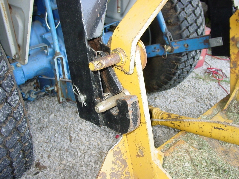

I have had my leveling arm break twice now where the threaded rod attaches to the clevis at the arm. I welded it up and it lasted for years, but has broken again. Does anyone know of a leveling arm with the crank handle that will fit in place of my arm? I have not found one looking online. None of them look like they would attach at the top.

Well, welding it and it still being adjustable isn’t going to work. My son was using it while I was at work so I didn’t get a good look at it until now. It didn’t break at my weld at the clevis, it broke further up in the threaded area.
Welding skills 1, threaded area 0.
Is the quick hitch adjustable at all? I always have to adjust when swapping from my mower to my box blade.

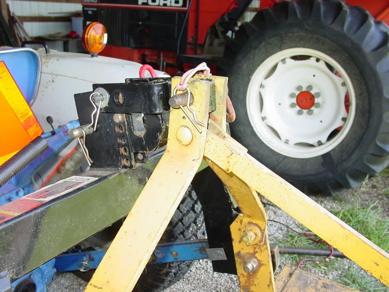

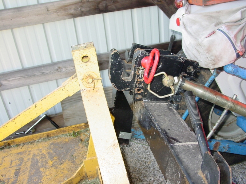

Quick attach, may not work with all your implements.My home made boom lift is wider than quick attach. Saying that and it perfectly matches my brush hog and carry all that is my two constantly used implements. Just need to just go under the implement pins and lift. Not very easy , but you can sway it right and left from the seat using a small crow bar or something. It has been a very good $100 I spent.
