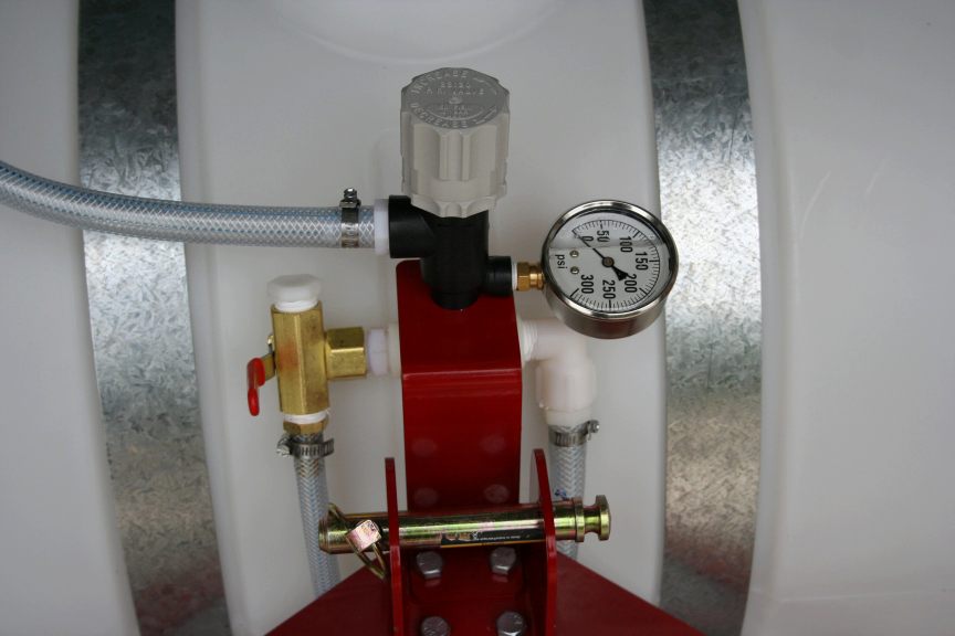

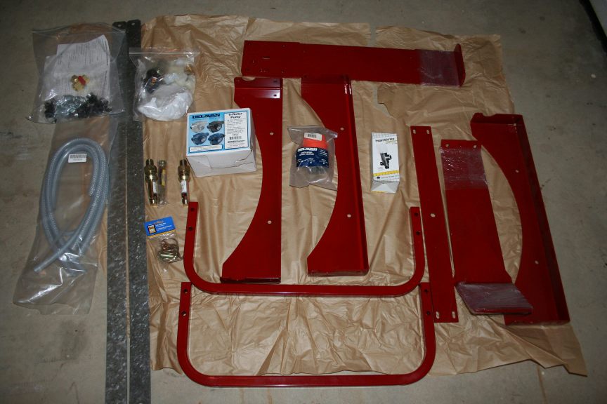

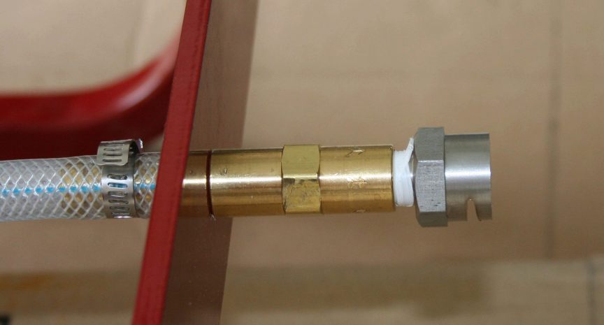

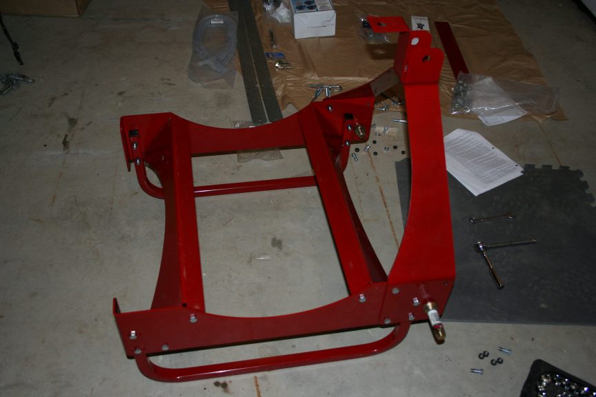

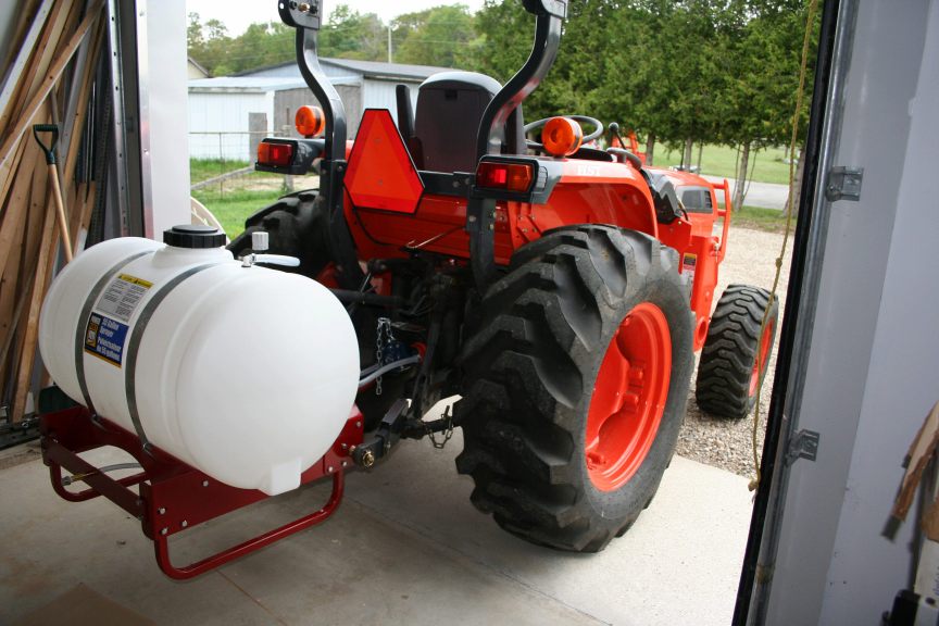

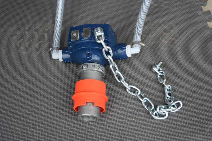

Well I picked up my 55 gal boomless sprayer on Thursday. The sprayer seems to included everything from the pto pump to the lynch pins but needs to be assembled. Here is a picture of all the parts included.

Ah, Princess Auto. Everything industrial anyone ever needs, including a few auto things. They took over an empty Safeway store in Winnipeg, Manitoba: awesome! The variety of things they have is amazing. Hope it works well for you. Let us know once you've used it a bit.
