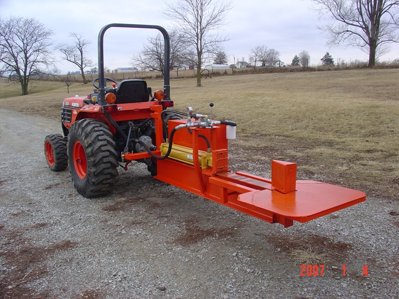

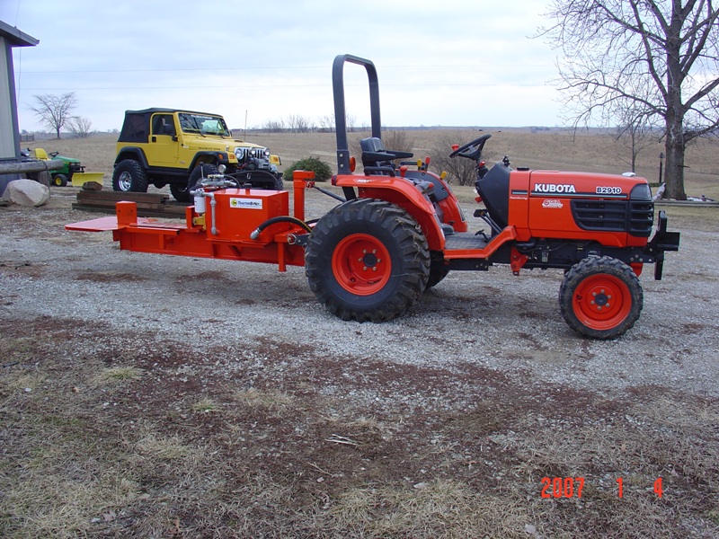

I built one and used it on my Kubota B2910. But I used a 22gpm PTO pump. I loved that splitter. Lost it in a shop fire. I would be concerned that your tractor hydraulics can run a splitter fast enough. Nothing more aggravating than waiting for a splitter to cycle.
That is some kinda' splitter!
Beautiful!!
