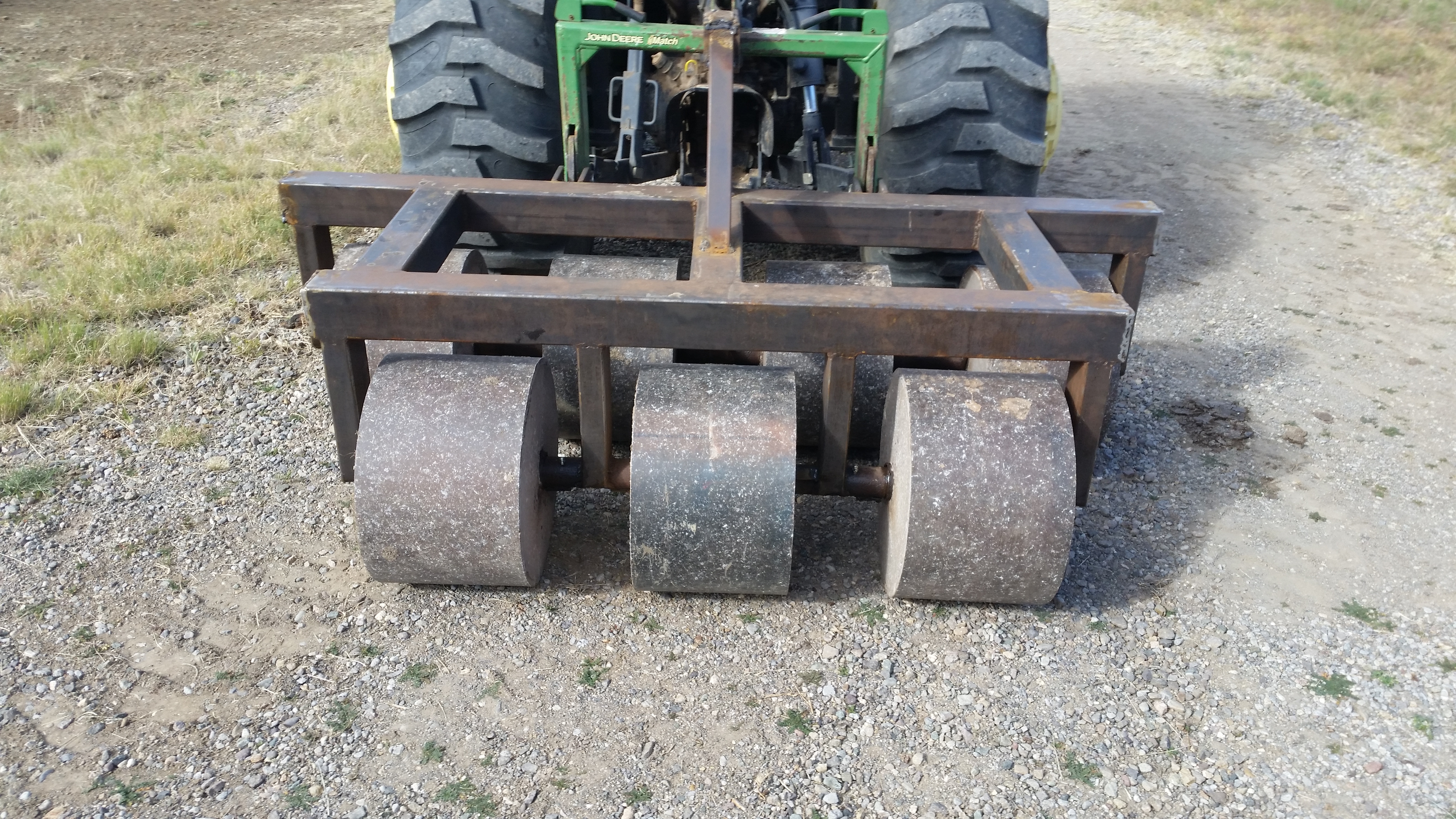

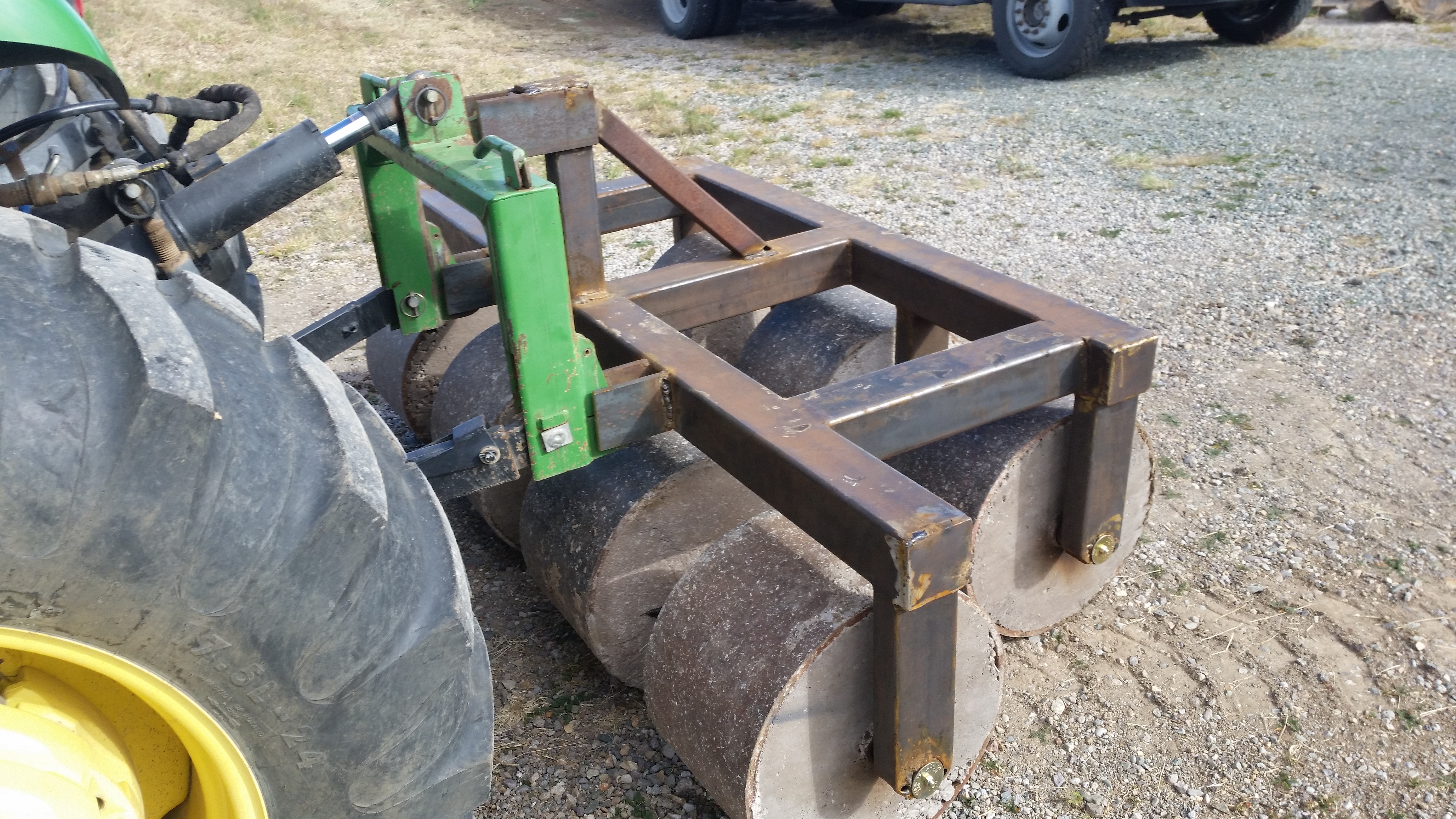

I have a roller that weighs over 2600 lbs. and can handle it pretty well with my 4520 cab tractor 2009 year. If you are not running down the road in high range you should be okay.
   / 3pt hitch lift question for implement I'm buying
Does it pick the roller up with no problem?
   / 3pt hitch lift question for implement I'm buying #6
Yes, don't think I have a picture of it up but I was able to transport it to a few jobs so far. Loading tractor and roller on my trailer I did roll it up the ramps felt that would be safer. I should mention this is with 420 lbs. of front weight not with a fel. With a fel and the increased weight you should be in good shape.
