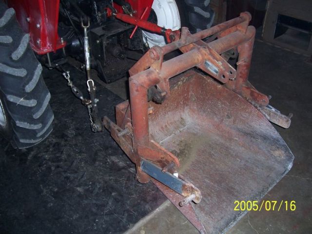

We've had one of those dirt scoops for many years, and use it quite often. We used to use it behind an 8N Ford, and now use it on my Jimna 284. The scoop is a Ford/derborn. To my surprise it would not hook up to the Jimna. The scoop is 24 inches wide, and it hit the inner lower 3 point arms. The Jimna is narrower at the tractor side of the lower arms than the Ford is. So, we had to extend the 3 point mounting out farther in order to clear the 3 point arms. One word of caution: When in the reverse postition, backing in to a dirt pile, use a slow speed and soft throttle. (Talking from experience) See attachment for the modifications. Sorry it never got painted! Yugo

Now that is a good heavy duty dirt scoop. No rust buildup on yours, as you are using it too often, for the metal to oxidize, and even if it does, your metal is so thick, that, it wouldn't hurt it at all. Did you'all have to remove your swinging drawbar in order to have enough clearance?
