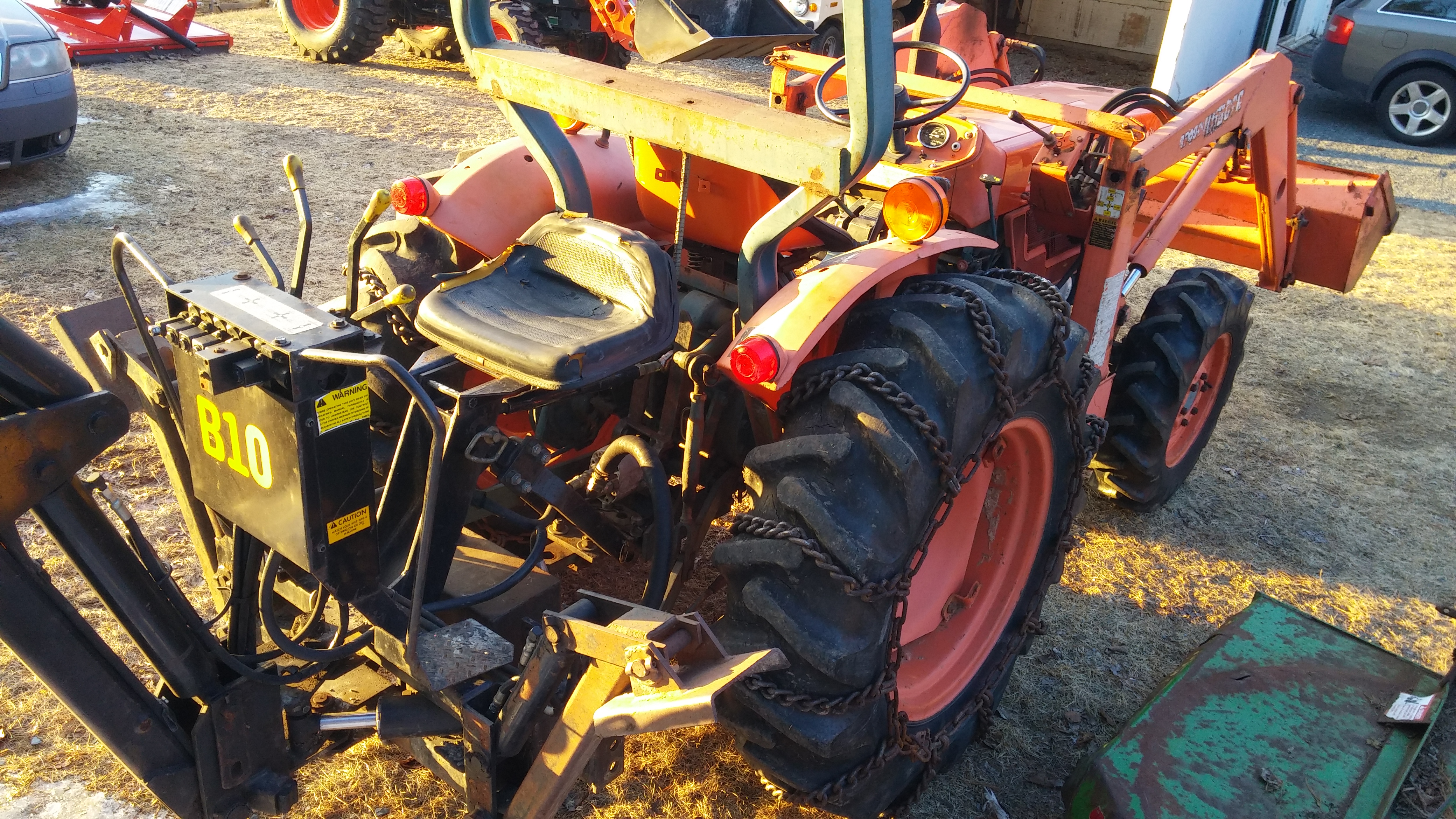

And - related - there was a nearly identical thread last year describing similar (bent upper link) BH problems and hazards. Here's something I posted that may be of interest here.
I have a 1980 model backhoe made in the US that was sold as OEM by both Yanmar and Kubota dealers. Its manual has an addendum for a recall kit, which is installed on my hoe. The kit adds restrainers below and forward of the three-point pins. The restrainers touch the lower edge of the 3-point arms and won't let the hoe fall forward if the top link should fail.
The recall kit is doubly important on that model hoe since there is no grab bar anywhere near the controls, the operator would fall forward into the controls if the top link broke and the hoe pitched into the excavation.
I posted photos of this add-on kit in my posts #35 and #39. I suggest reading that entire thread as well as this one, for anyone with a 3-point hoe. The safety issues could be deadly.

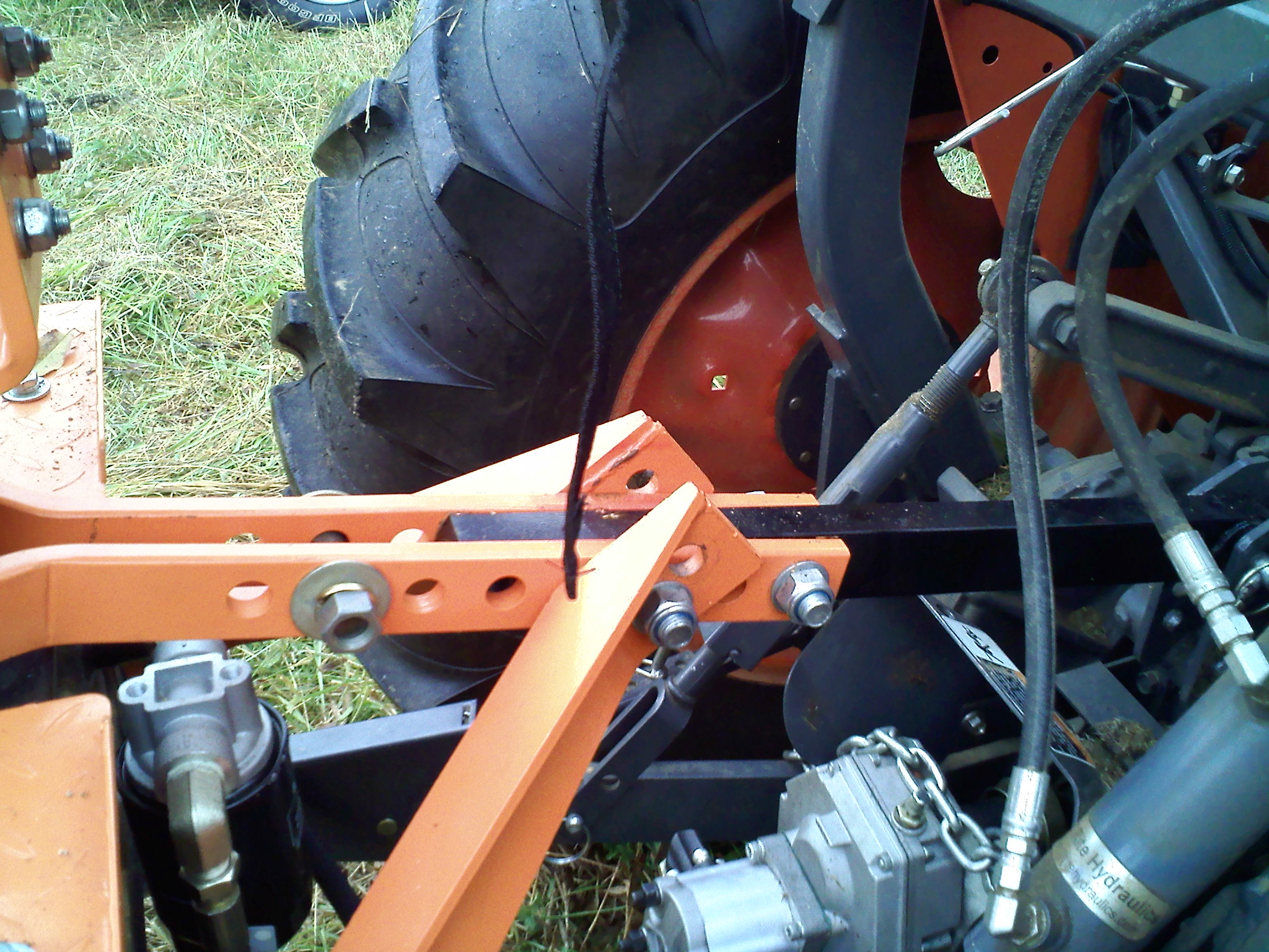

As I've posted before Woods has recommended to me to use a 3pt hookup (they call it 3-point hitch Saf-T-Lok kit and it was going to be about $800) if I want to put my BH70X on my M4700 since they do not make a subframe for it. And it was available for the BH90X but would fit the BH70-X.
When talking to Woods they said that is how they do the mount for over 50HP tractors.

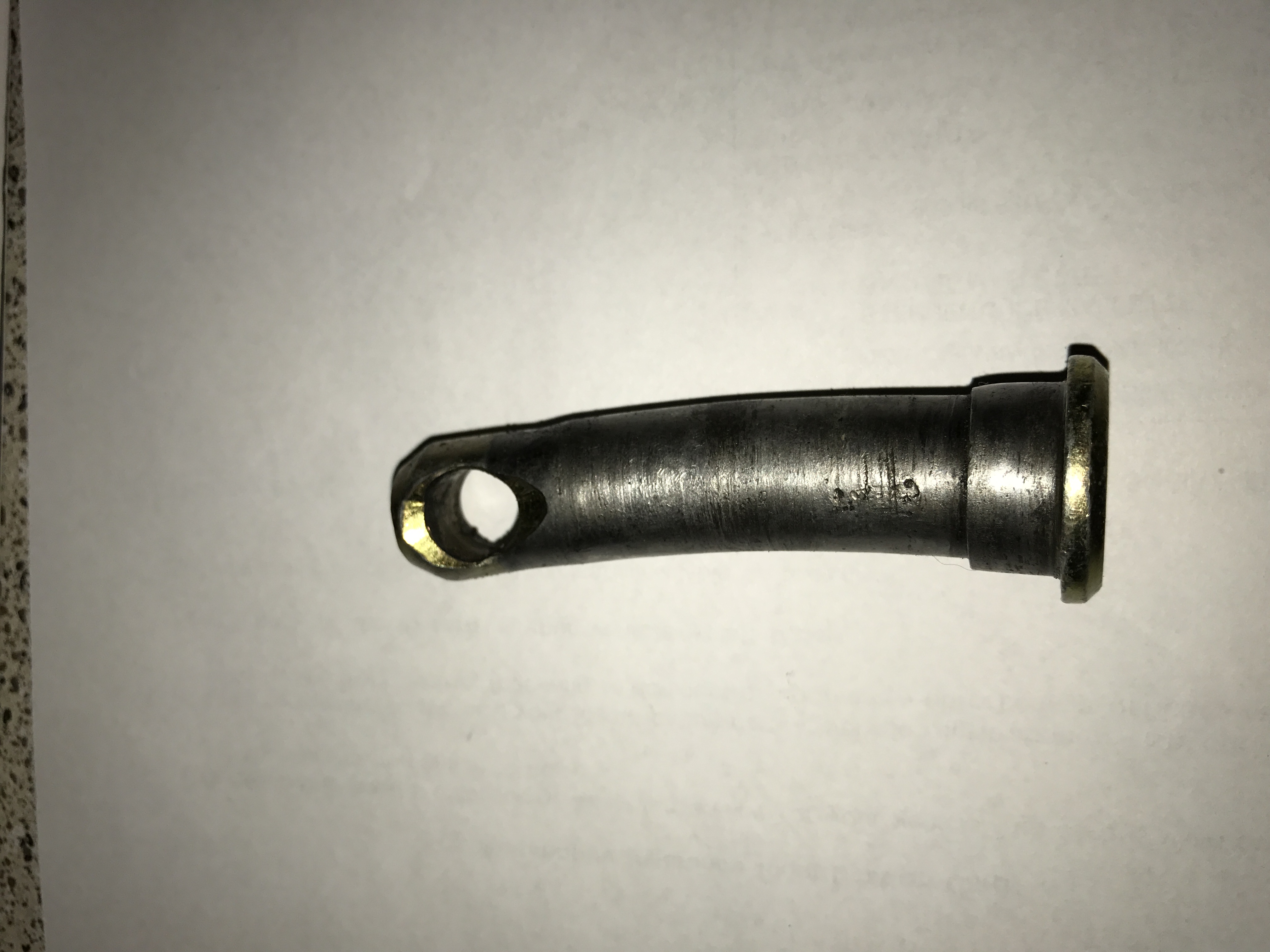

I bought the Woodmax 6600 about 2 1/2 years ago for my Kubota B7500. The 6600 is listed as weighing in at 995 pounds (the 8600 is 1150). Before I installed it the first time I did purchase the heavy duty top link bracket and the support frame kit from my dealer. I have dug up over 30 tree stumps and never had a problem; it is a powerful backhoe for it's size. But I do recall that my Woodmax hoe did not come with a pin to make the top point connector on the tractor, you had to supply your own. I'm thinking that the OP likely had a cheap (think Chinese) top link pin to have it bend that much. The problem would further be exasperated if the pin were longer than necessary. I use the same short top link pin for the backhoe as for all of my other 3 point attachments and it is not bent in the least.
Nope. That was a Kubota OEM pin. You have to use their pins on this as far as I know because it has a lip on it that can only be inserted in one direction.
