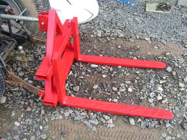

   / 3pt Forks #3
Here's a set I made myself.
Actual forks are from a local auction.
Hope this gives some ideas.
Cannot comment about load carrying ability. All i can say is that when the pressure releif valve operates on the 3 point, there is no evidence of strain on the forks!!!
Nigel
