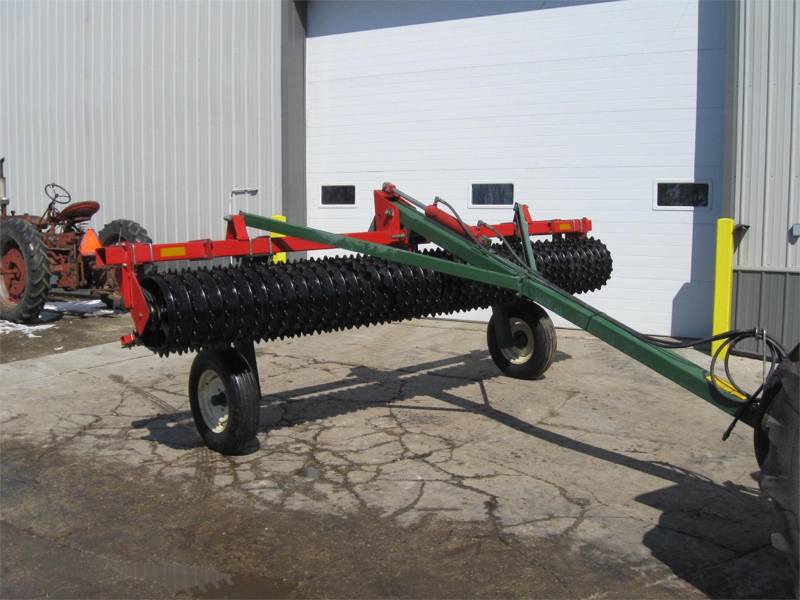

I think the packers towed have better ground contact than the 3 point versions. I have a Brillion 7 footer 3 point style. How about redesigning it to be towed , but with transport wheels that could be engaged with a ratchet jack. I've seen several of these and that was always my plan, but never got around to it. I'll try to find pictures .
   / 3pt cultipacker question #6
Here are some examples. You could use your existing wheels, add more rollers for width, and redesign the frame. Then you have the advantage of the pull type but the ability to transport it. The additional weight would also help. Just a thought!
