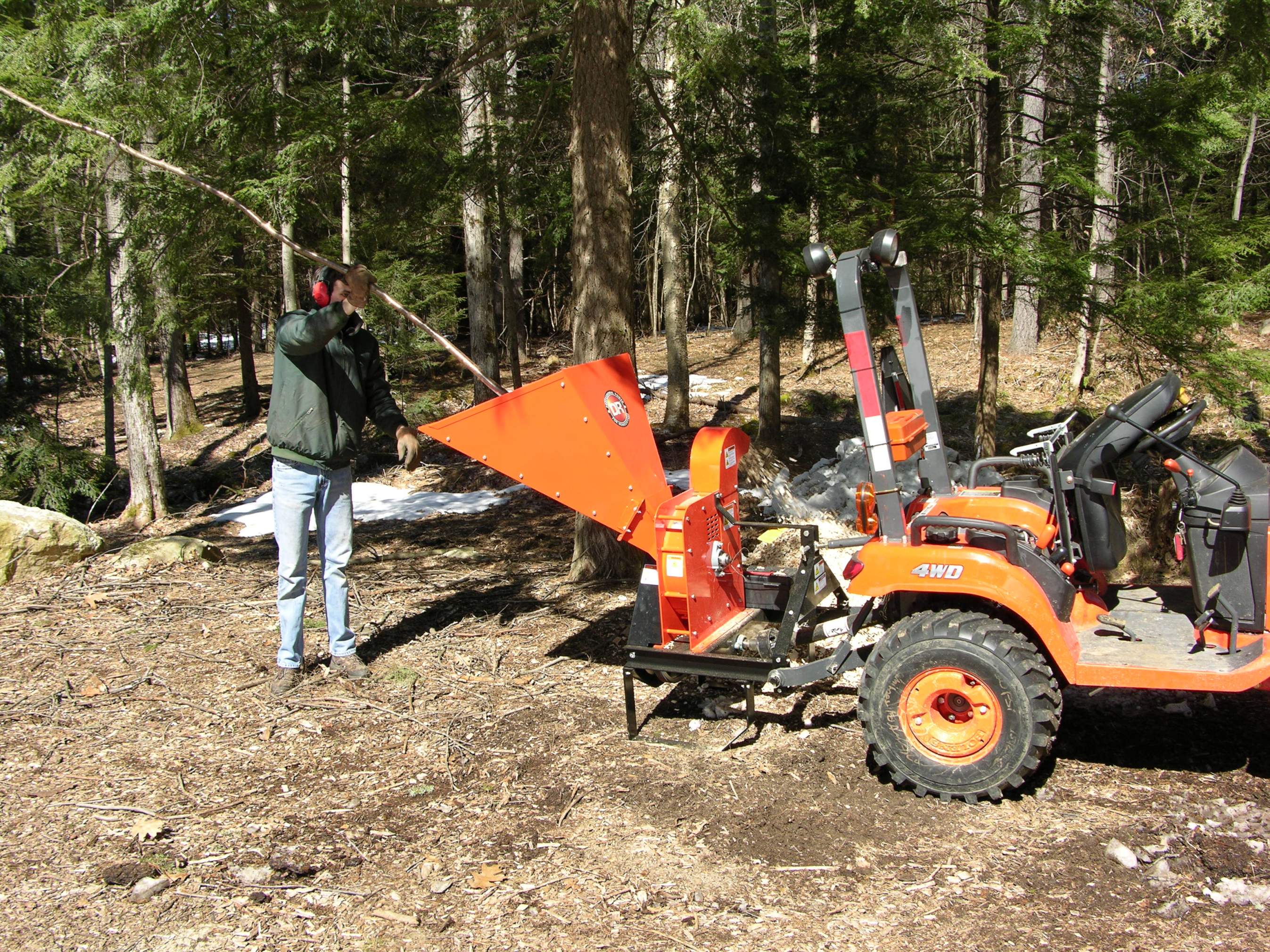

I have a DR chipper, very pleased with it. $1400.00 is a fair price, new would be about $2300.00. check bearing fly wheel, drive shaft. new knive blade will set you back about $60.00. the feeding of material through it pretty good, except for branch with stiff Y's or branches at 90 degrees.
I say go for it, order a new knive and you should be in business . you can download a manual on line. at no cost
