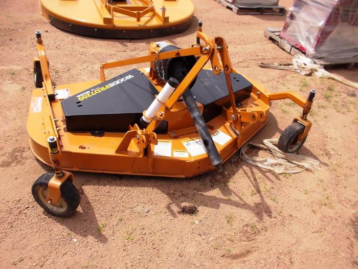

The top toggle on the mower that attaches to the top link on this Sitrex looks like it would limit travel. You may try turning it around. This is the set up on a Woods for the toggle.

The toggle on my Woods PRD7200 is tilted down at about 30 degrees when attached to the top link and the mower is sitting on level ground. If the top link is too tight the mower will raise off the ground when going over steep slopes. If the top link is too loose the back of the mower will droop down in the back when the mower is raised for transport. Looks like the top toggle on the Stirex is pointed straight up when the mower is lifted. This wouldn't work at all on my tractor and I don't have a quick change hitch. Hope this helps.

I have some pretty steep valleys in my yard. My Woods mower has enough travel to not raise off the ground when mowing these valleys but still also raise level when lifted for transport.

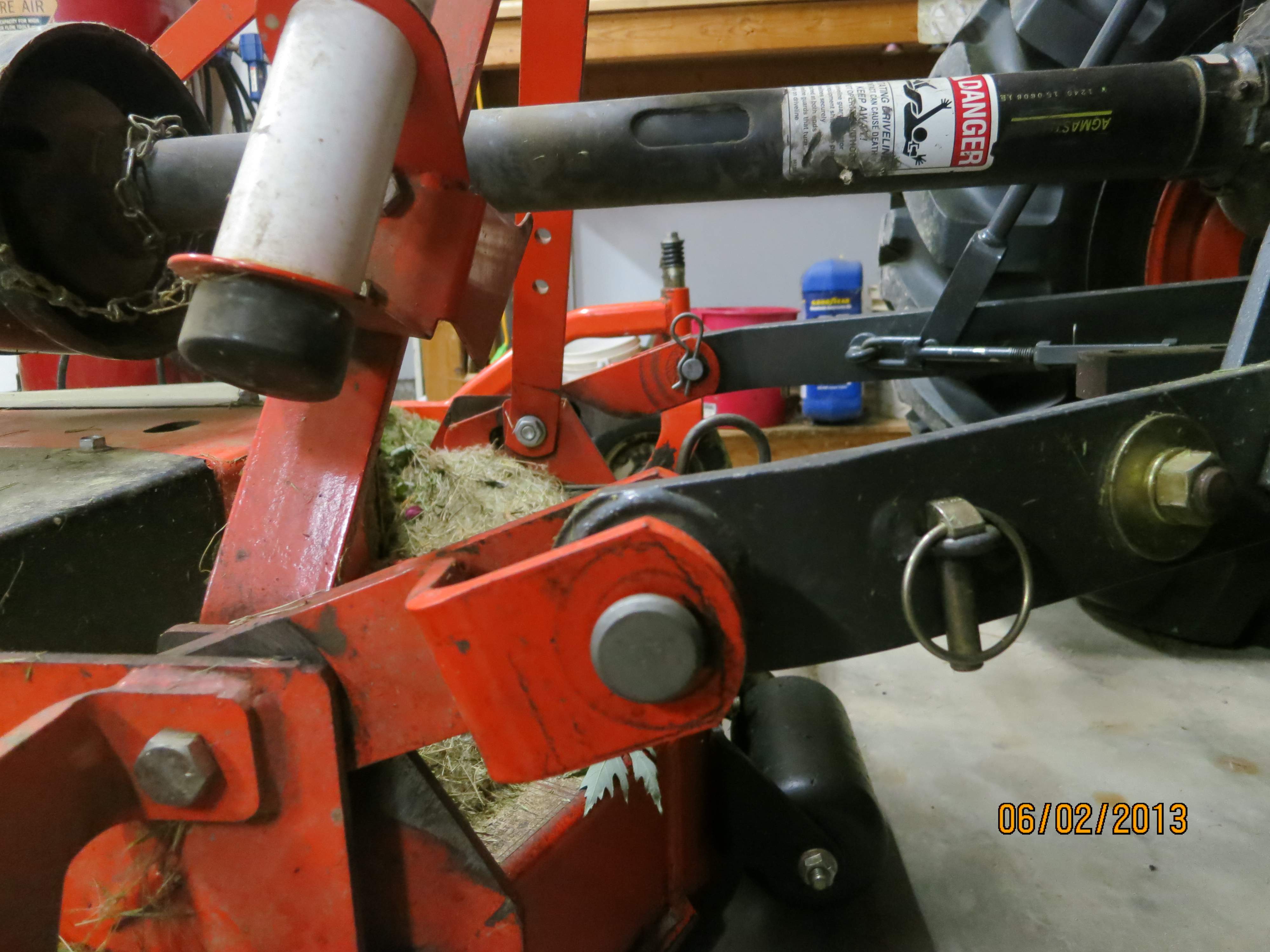

Some pics. Top link. Bottom links. Sitting on my garage floor.
   / 3point finishing mower on a 2006 5264D... Question.
View attachment 320763View attachment 320764
Looks like I'm going to try flipping the toggle so it can face forward. They have a piece welded to it that prevents it from going forward though. Like it's supposed to swing backwards.
