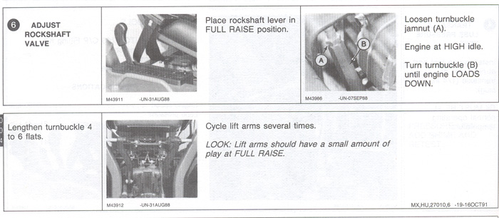

I just noticed that my 3PH isn't raising to it's full up position. I had noticed a few weeks ago that my rear blade didn't lift very high off the ground, but when I looked at it again, it was fine. I chalked it up to an observation error on my part. This weekend though, I can certainly say that it does not come up all the way. When I move the lever to it's full up position, the arms come up about 2/3 of the way and stop. I can lift them by hand all the way, but they just drop back down again. I checked my hydo oil level and it is fine, so the hydraulics shouldn't be getting starved. Any other suggestions? /forums/images/graemlins/confused.gif

Dave,
I have a service manual. I'll take a look tonight and see if anything like that is covered. I'll get back to you later.
OkieG
   / 3PH wont raise #6
From what I can tell, the manual says to try this (6) first.
OkieG

Don't ignore that comment on those instructions that the "lift arms should have a small amount of play at full raise" because if it's still trying to raise more, you'll have a relief valve open all the time the lever is in the full raise position.

Thanks OkieG!!!! /forums/images/graemlins/grin.gif
That was exactly the problem. The jam nut had loosened on my assembly, and I could see bright threads where the turnbuckle has vibrated loose. In fact it had loosened so far that the entire assembly was only about 1/2 turn from coming completely apart.
