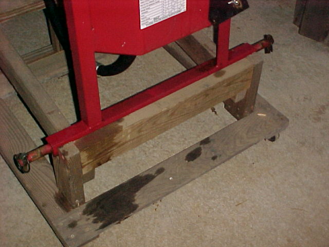

Today, the first bags of fertilizer were spread on the yard. Working with the 3ph spreader reminded me how awkward an implement it is to mount and remove from the tractor, and not easy to store or move around.
When I got my spreader a few years ago, I built a wheelbarrow kind of holder to wheel it around and hold the spreader steady for mounting on the tractor. My contraption is pictured.
OkieG

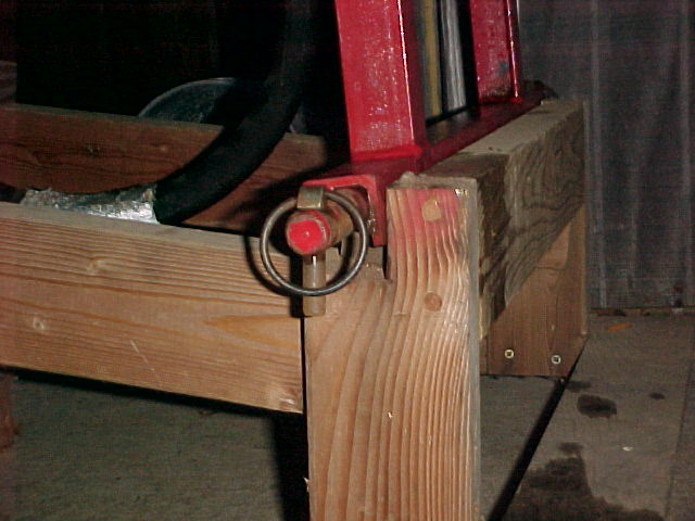

A wooden lip keeps the bottom of the spreader from slipping forward.

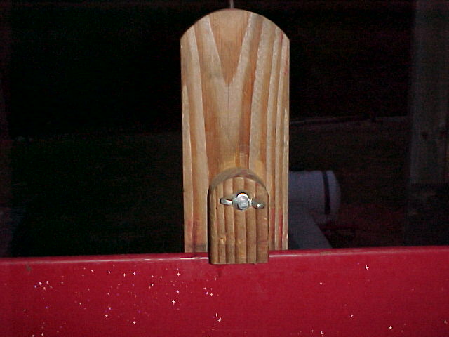

Up top, a little notched piece of wood swivels to secure the top of the spreader for moving or release it for mounting on the tractor.

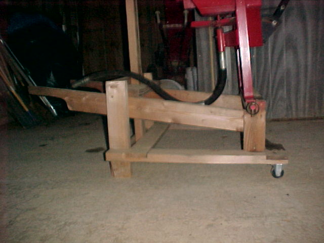

This is a shot of the wheelbarrow part. Small wheels in front. Posts behind. Then handles for lifting and moving around.

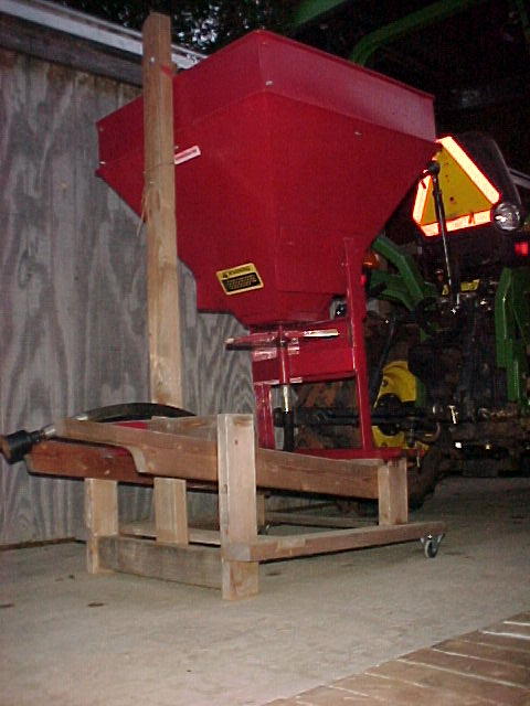

One last shot of the front part of my "spreader holder".
There have been a few posts lately about folks interested in buying a spreader. Mine is used only a few times a year, but has saved me from ever going back to a push-by-hand spreader. I cringe to think about it.
Anyway, these pictures are just to show one way of dealing with moving and storing a very useful, but awkward implement.

Nice looking setup. Spreaders are top heavy and can be hard to hook up sometimes. What I did for mine was use two pallets with a piece of plywood on top of the second pallet, I set the spreader on top and secured it with bungy cords. This works slick for me and keeps the spreader off the ground.
