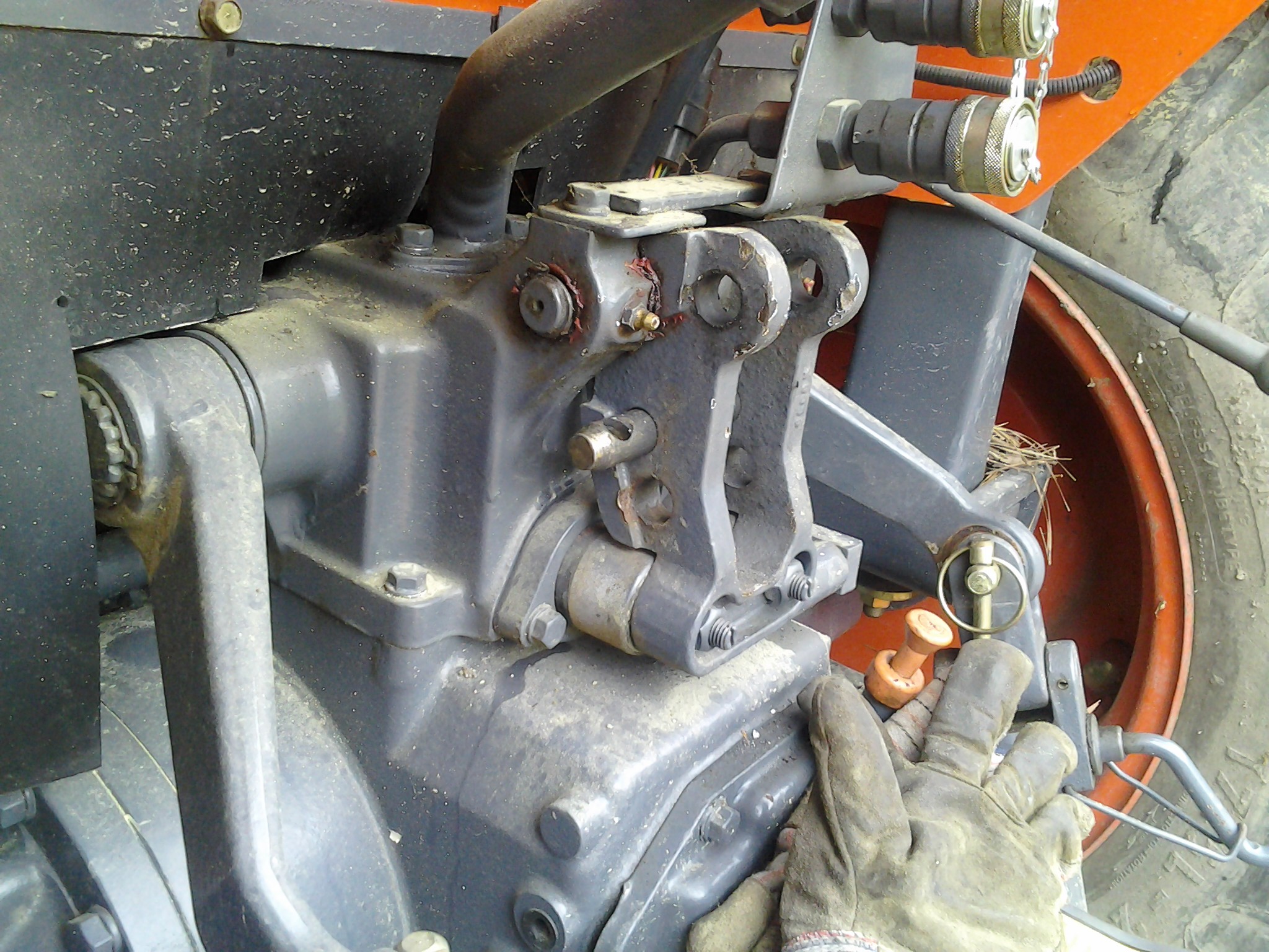

The top link needs to be in one of the bottom two holes for draft control, then use the draft control for draft/position at the working level and not for lifting.

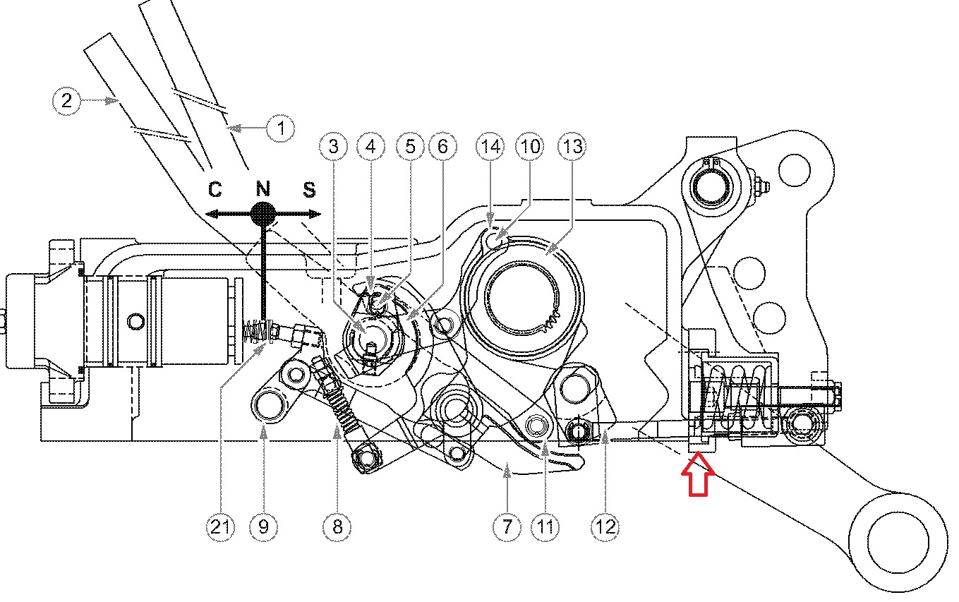

The top link attachment is mounted on a pivot and the bottom two holes work against a spring? and the top hole is directly in line with the pivot so the draft is not transferred to any linkage. In the DK45 book on Chap 5 , Pg 25. is the Kioti explaination.

It is not that way on my Mahindra 7520. When attached to the pin location closest to the pivot point, that is where the draft sensitivity is at it's least sensitive location and is where it is recommended to have the top Link located when doing severe ground engagement such as using a turn plow implement.
My thinking is-was that the same would hold true for the Kioti system also, but I guess not. I have never paid enough attention to the Kioti draft system to know any differently. I figured that it would pivot at one end and no matter what pin location is used, the draft control could be used if the conditions were right. You could make use of any of the pin locations to match the draft requirements of the task at hand. But it sounds like there are only 2 different draft positions and the 3rd has not draft control purpose.

Also, I moved the pin to the middle hole (lower sensitivity) and all was good (no more shudder).

The top hole is solid, not connected to the draft sensor on his machine (and mine for that matter)
