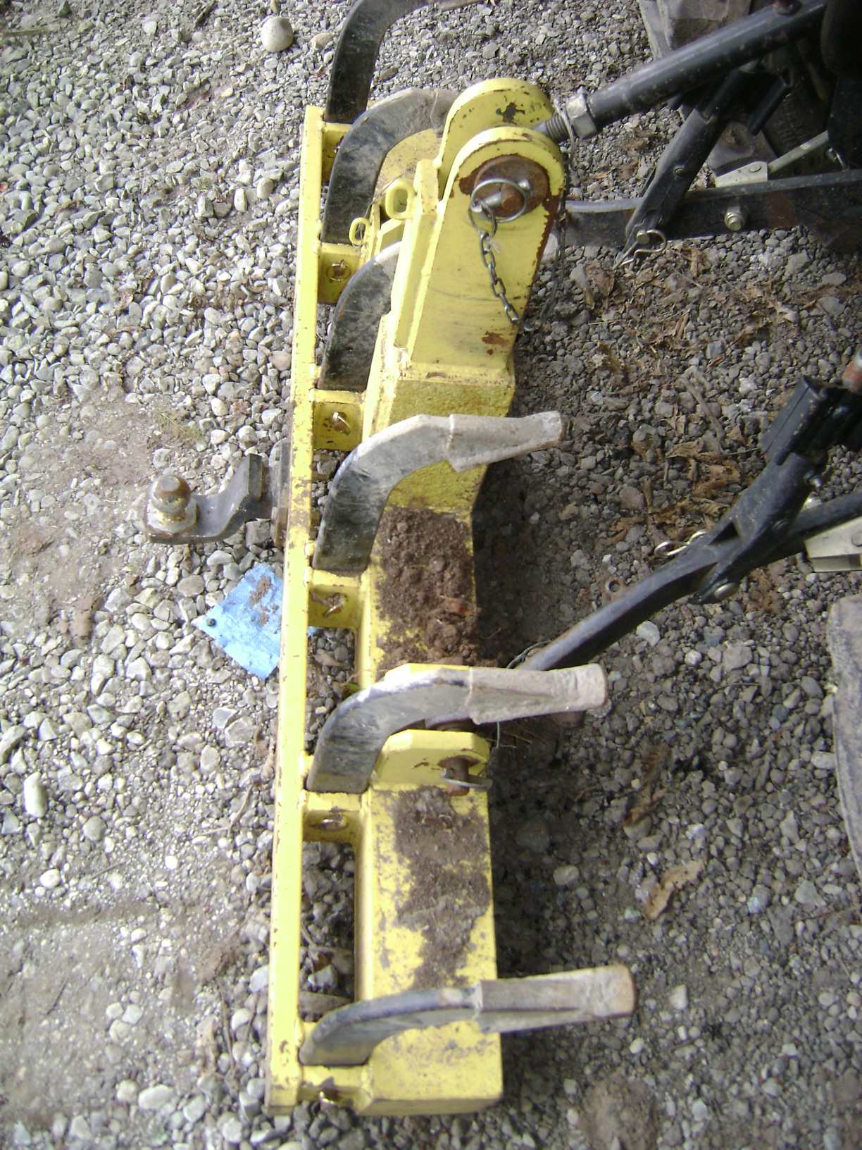

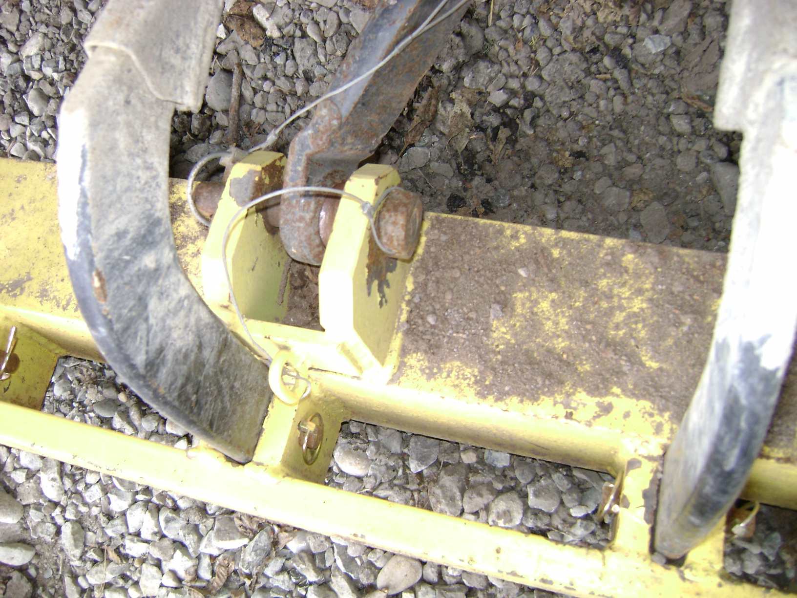

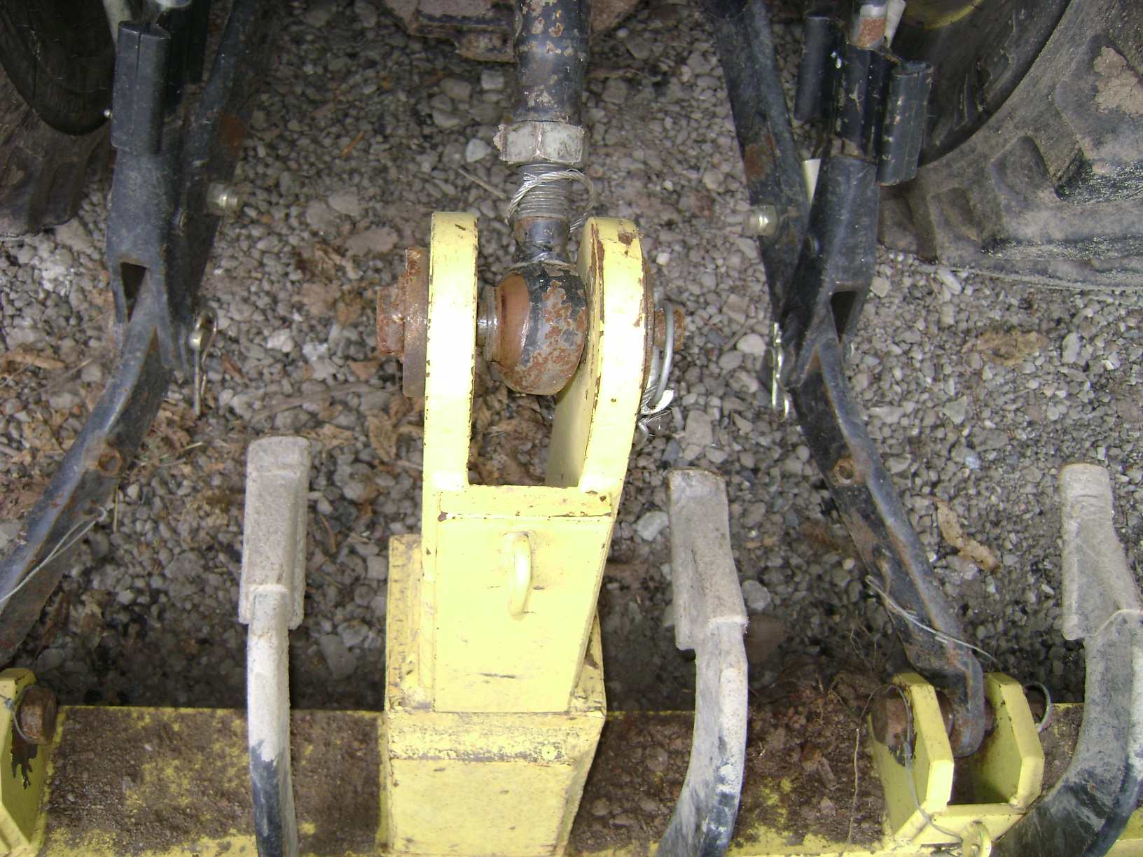

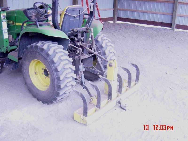

One thing I don't like about the factory rippers, is they're to light. And won't dig in on hard ground. I built mine out of 5-inch square stock.

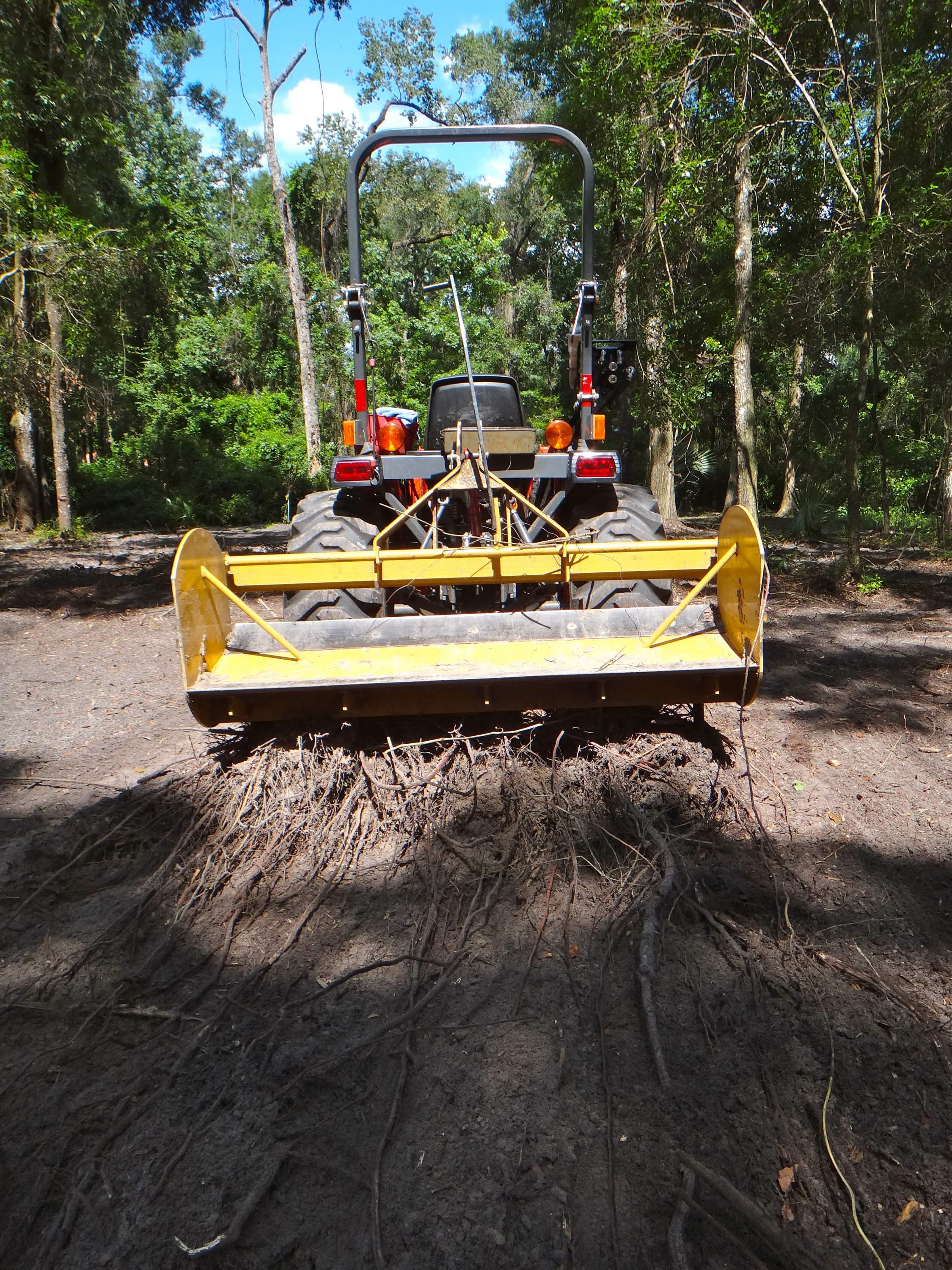

Box Blade rippers are designed to penetrate to the bottom of pot holes in composite roads. Perhaps a bit of brute force design. I have a Rollover Box Blade. (Photo #2) Rippers are easily replaced.
I have ordered what Dirt Dog calls an 'All Purpose Plow' and Everythingattachments.com calls a 'Field Cultivatior' which is the name I prefer.
Todays spring protected Field Cultivators are replicas of Harry Ferguson designs from about 1935. Every implement I have used which is a Harry Ferguson design has worked well.
Field Cultivators have spring protected parabolic shaped rippers which penetrate with less tractor power required. My use will be for removing sub-surface grape vine roots, wild rose corms and Smilax corms. I will review after it arrives and I can put it to work.
I ordered from Dirt Dog because I wanted 66" width with 5 rippers. ETA only has 60" width today.
So, you may consider ripper shape in your design.
Have you considered a Tooth Bar for your bucket, rather than a 3-Pt. implement? A Tooth Bar will make a BIG difference in the ability of your bucket to dig.
Just as true if the OP goes with a box blade. Get one a hair wider than your rear tires & as heavy as you can afford & still lift on your 3pt. Especially if you are primarily going to use the scarfiers. You'll need all the weight you can to push them into hard ground.
A hydraulic toplink is a godsend when using a box blade. Tilt the box forward all the way to dig with the scarfiers. Tilt it back to smooth. All without messing with adjusting the scarfiers mounting depth. I cleaned up the driveway this weekend from winter mud, ruts & snowplow damage. Extending or retracting the toplink 1/4" maybe 1/2" was the difference between filling the box blade or emptying it. Just a touch of toplink made for great fine control with an excellent finish. Trying to lift the 3pt would have left huge speed bumps &lots of issues.
