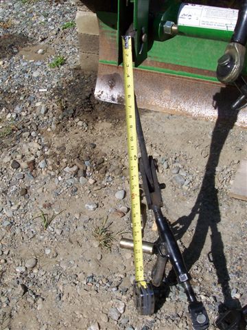

I'm trying to attach and adjust a new LX4 cutter to my JD 4115. Basically, I can't get the cutter deck far enough away from the tractor.
The tractor came with a backhoe attached, so I removed that and installed the 3PH per the manual. I set the cutter attachments low, per the manual. Then I set the upper link arm for proper front to back cutting angle at the dropped position.
If I try to lift the cutter more than 2-3" from full drop, the front edge of the cutter hits the tractor rear tires squarely. Also, even in the dropped position, turning causes the outboard draft arm to rub on the inside of the tire. I think I can tighten the draft link turnbuckles to improve that, or I could widen the distance between the rear tires (which I don't want to do for storage reasons), but I think the first problem would remain.
Are the draft arms are too short? Is this JD's way of punishing me for not buying an imatch system? Anyone else come across this problem, or have a suggestion?

Good questions and suggestions, all. I'm away from the tractor now but will shoot and post some pics when I can.
Tom- The LX4 is spec'd for the 4115. I don't have any other attachments, so I can't say if its only a problem with the cutter. Would you be able to measure your draft link, center to center, and post it? I just have this feeling that the draft links I got are too short. I'll try to find the specs.

   / 3PH Question #9
RK,
Darn, I had the 3PH on the 4115 last night to pull the grooming mower but took it off to put the BH back on. I should have taken a pic while it was on but am just now reading this.
Anyway, I have several meetings but, I'll take a few pic.'s of the 4115 draft arms with dimensions, when I get home. I'll try to post tonight.
Tom
   / 3PH Question #10
RK,
Meetings over early. Got the following pic's. Sorry, sun was bright and the tape measure doesn't show up well.
This, 1st pic is straight line, center pin to pin, of the draft link. I call it as measuring 24". That square's with the manual as the rated lift of the 3PH (1150#) is at 24" behind the "link arms".
