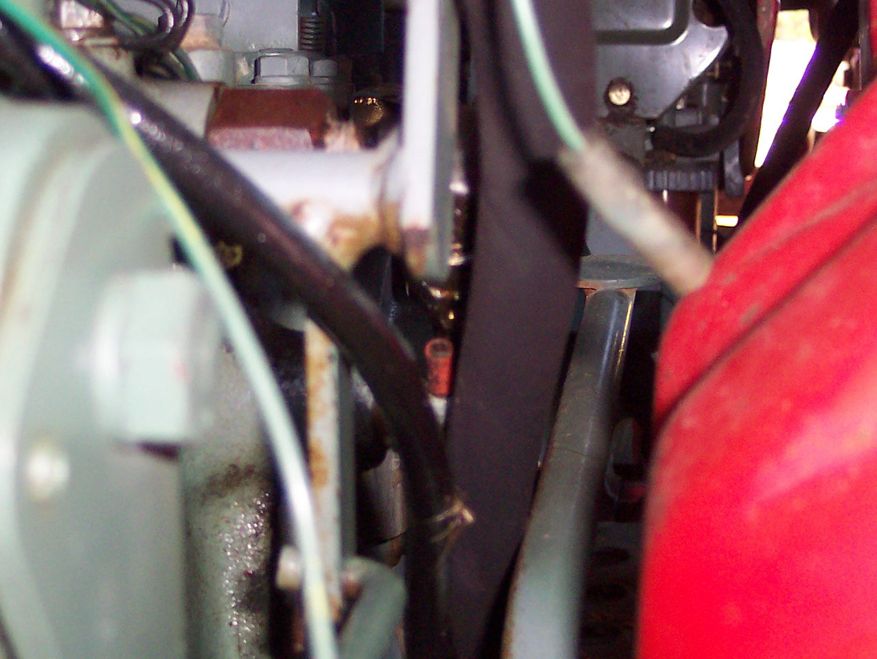

   / 3ph problem #8
Post up a pic of the area being described, maybe someone here will recognize it?
   / 3ph problem #9
Ok this is a picture from the back of my tractor. It is hard to see but it is the lever with the red handle (I was wrong and it is the other lever the red fell off of). It is next to the hydraulic hose.
   / 3ph problem #10
Sorry the picture came out so big... I'm having trouble with attachments. But you can see where it is in relation to the fender on the right side. I had trouble finding it to get this picture and I know it is there. It really is hard to see, kind of have to get down there and close to it and start looking. Hope this helps.
