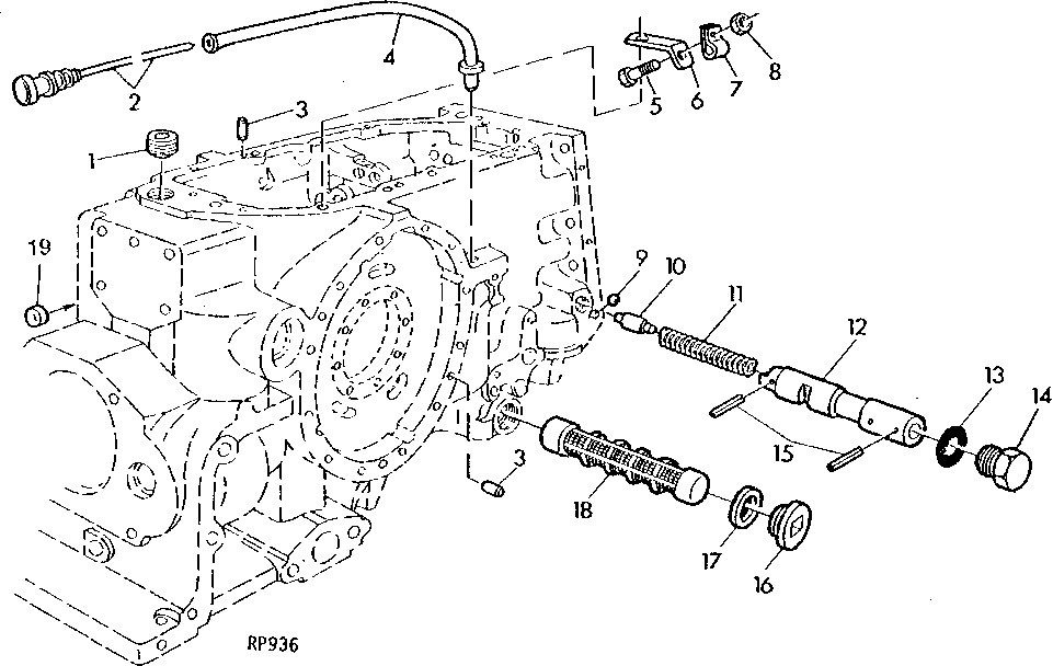

The sump screen is located near the hydraulic filter. It is to the rear of the filter, but in the side of the housing instead of the bottom. There should be a plug behind the filter that has a square hole in it. Take a 1/2" ratchet or breaker bar to loosen and remove the plug. (drain the oil first) With the plug removed, the screen will slide out the side of the transmission case. It is about 8 or 10 inches long.

Try changing the load/depth control lever to a different setting. The L/D lever is under the seat. The parts schematic will show screen location that jd110 explained although schematic not for the correct model.
