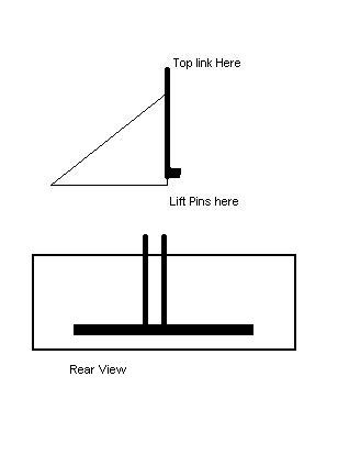

I made a 3PH bucket for my B2400. It's 52" wide 18" high, and 18" deep. Don't have it on the tractor now because the lawn vac is there. When I take the vac off and put the lower links on to aereate the lawn I'll put the bucket on and snap a couple pictures. The most important thing on the bucket is the location of the holes for the upper and lower links. You dont have much room for error. Everything changes when you move from the top to the bottom on the 3PH.

I've seen one for sale on the 'net, but I think the price was high, maybe $700 or so.
Look at my crude drawing here

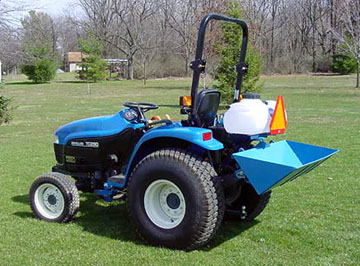

Here are a few pics of the rear bucket/scoop I built for my Hew Holland Boomer TC29D. (My tank mount is also shown.) The scoop has really worked well in moving all sorts of stones (including barn stone & bolders), gravel, dirt, debris, etc. I dug out and lowered an area by 6" to fill with gravel for a new storage barn.
This thing has saved me untold hours of work, and replaced it with easy fun and satisfaction. Nothing like the right tool at the right time. /w3tcompact/icons/grin.gif

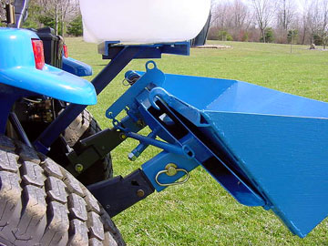

Another pic . . .

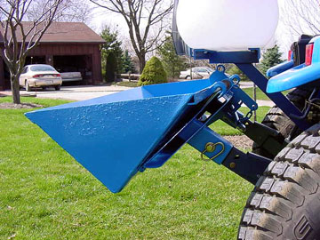

one more pic . . . The scoop has a release handle that I pull from the seat of the tractor (by attached rope), and once it is released, I lower and move forward at the same time and the scoop re-connects in the release so I can raise it to the full up and locked position ready for another push into whatever needs moved! /w3tcompact/icons/grin.gif

One last pic . . .with a few notes.
