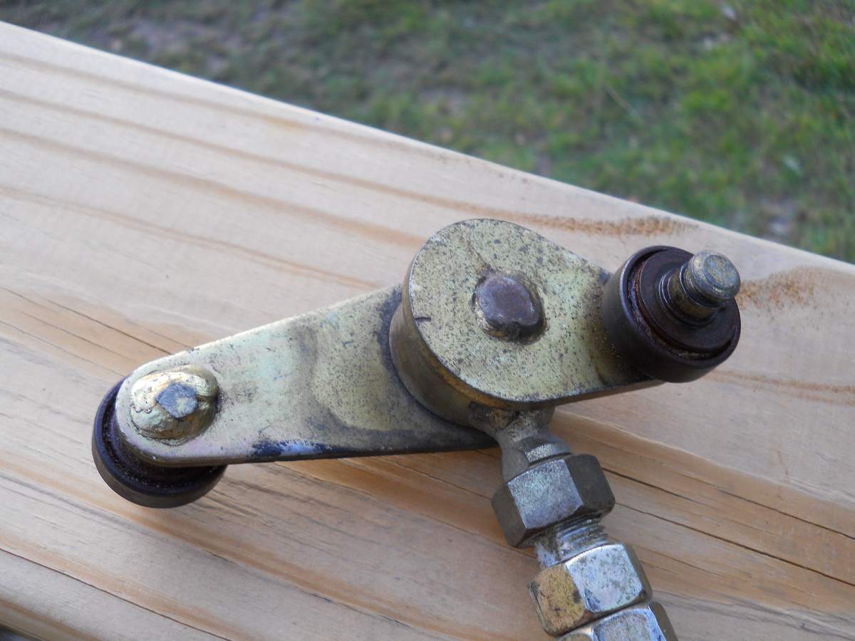

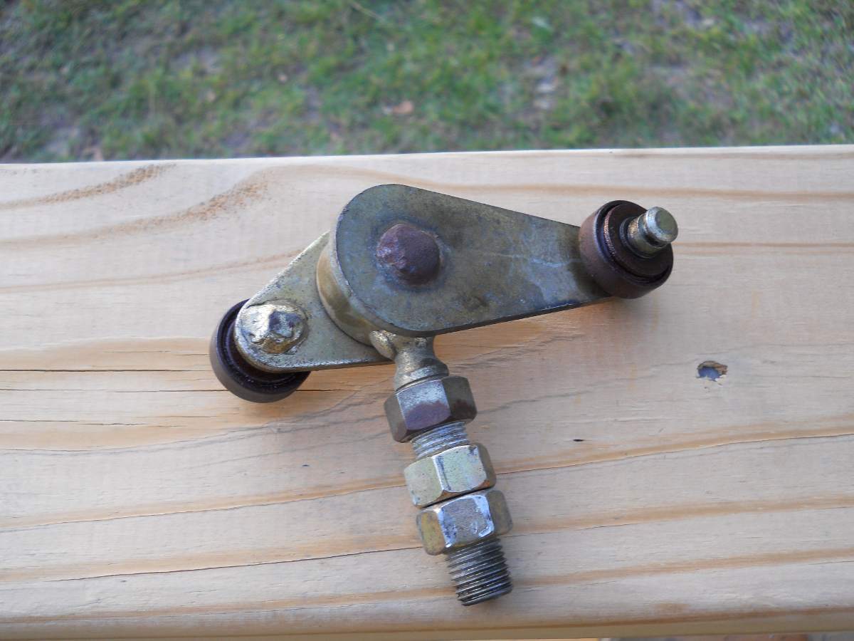

I pulled the cam assembly and see no sign of twisting from looking at the welds. I sprayed to bearings with some PB Blaster and they are running free now. Here's a picture of each side of the assembly. Do you see damage?

   / 390HST no reverse #7
It only takes a small amount of twist to throw off reverse. Try reinstalling and adjust the nuts to raise the cam. I always replaced them when they did it. The manufacture wouldn't admit to a problem with them, but always paid the warranty, when issued. I sold many 390's and I believe they all twisted. Replaced the cam on all of them. It corrected the problem.
   / 390HST no reverse
I put the cam back on today. raising it up about 3/16 set the pedals at the same height. I have full range in both forward and reverse though one of the return springs seems about an 1/8 too long. Not stretched out, just too long.
I'll order another cam and keep it on hand.
