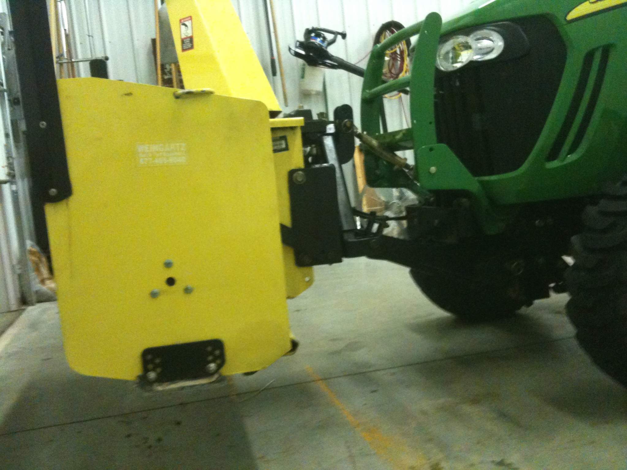

Not much need for the grill guard with the snowblower attached.
Thanks for the pics of your modification.
Did you not extend the mesh screen down lower to protect the lower half a foot of the grill for a reason?

Ya I didn't extend the mesh lower because of the center link for the blower would hit it. I am not in any brush or sticks to worry about the lower grill. I do mostly loader work so that's where I needed the protection from things rolling over top of the bucket. Like when kids are picking rocks and tossing them in the bucket, old tractor took a couple good rocks at the grill so just this bit helps protect it.
