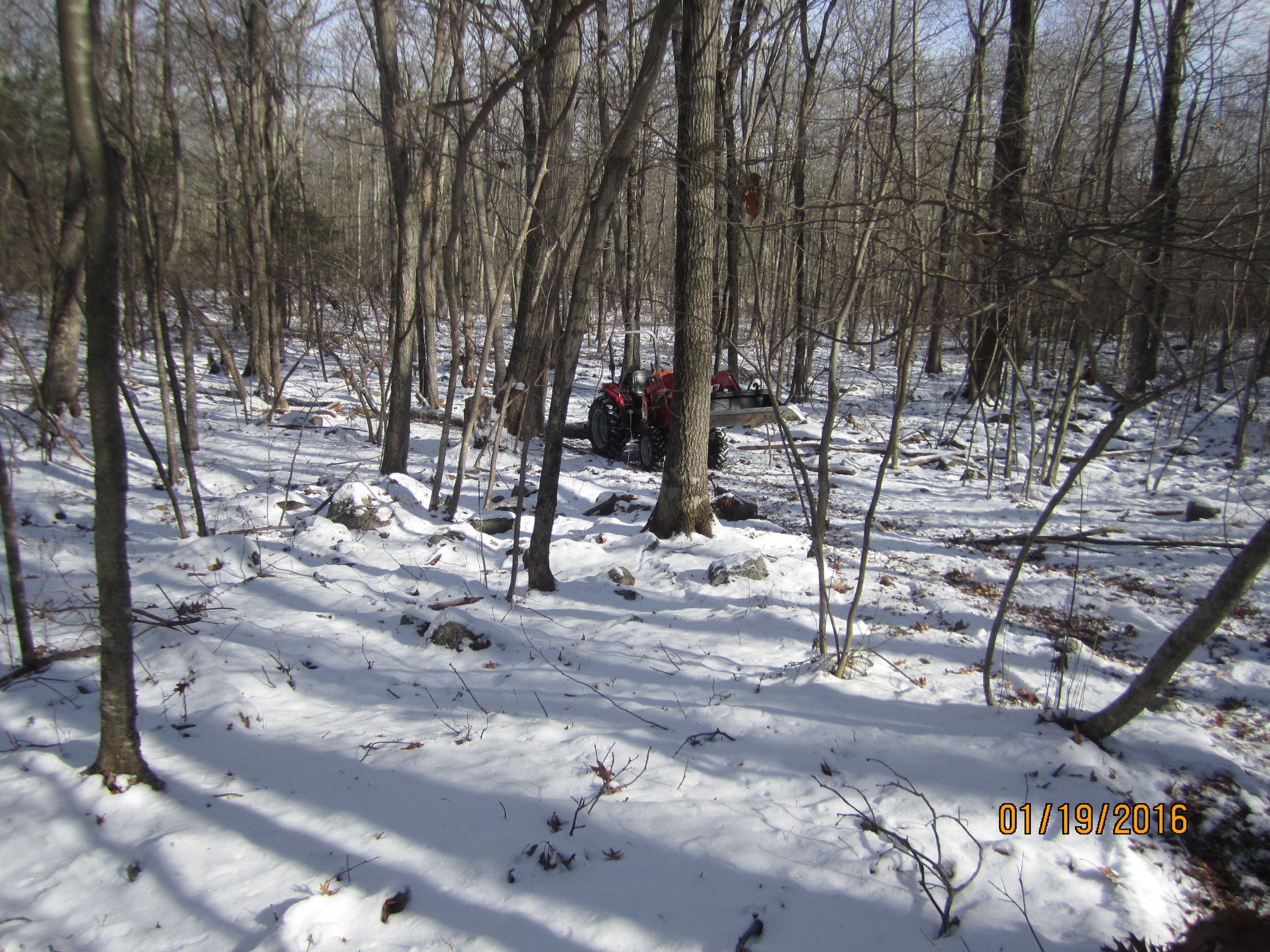

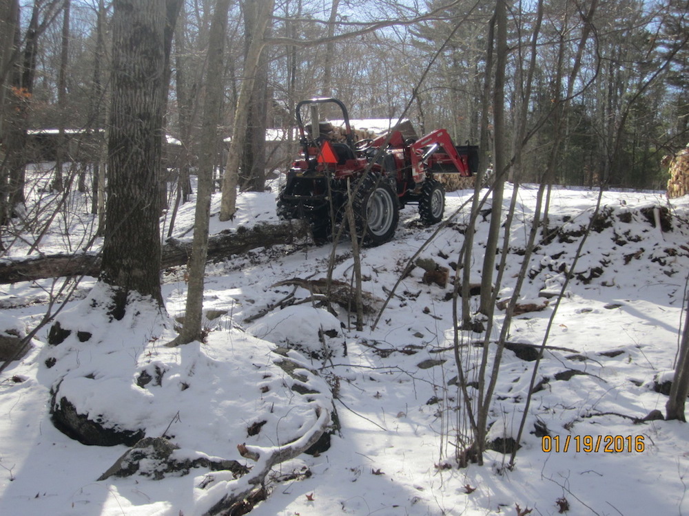

Not selling the Max short. If I did not have to skid tree stems, I think the Max as outfitted is a more handier tractor to have for the homeowner and I'd be no exception. You can do just about anything with the little sucker outfitted properly. I bring my 3016 (which is a bit smaller than the 1526) through some pretty rough and hilly terrain and with it's wheels spread, it has been very stable. I've cut into hillsides with a tooth bar mounted with good success with it. I think because of its rather high fel rating for its size has certainly helped in regard to this. No, it will not do the ground engagement that your L does but if he is to be a two machine family, I think a dozer for those woods might be great to have.
